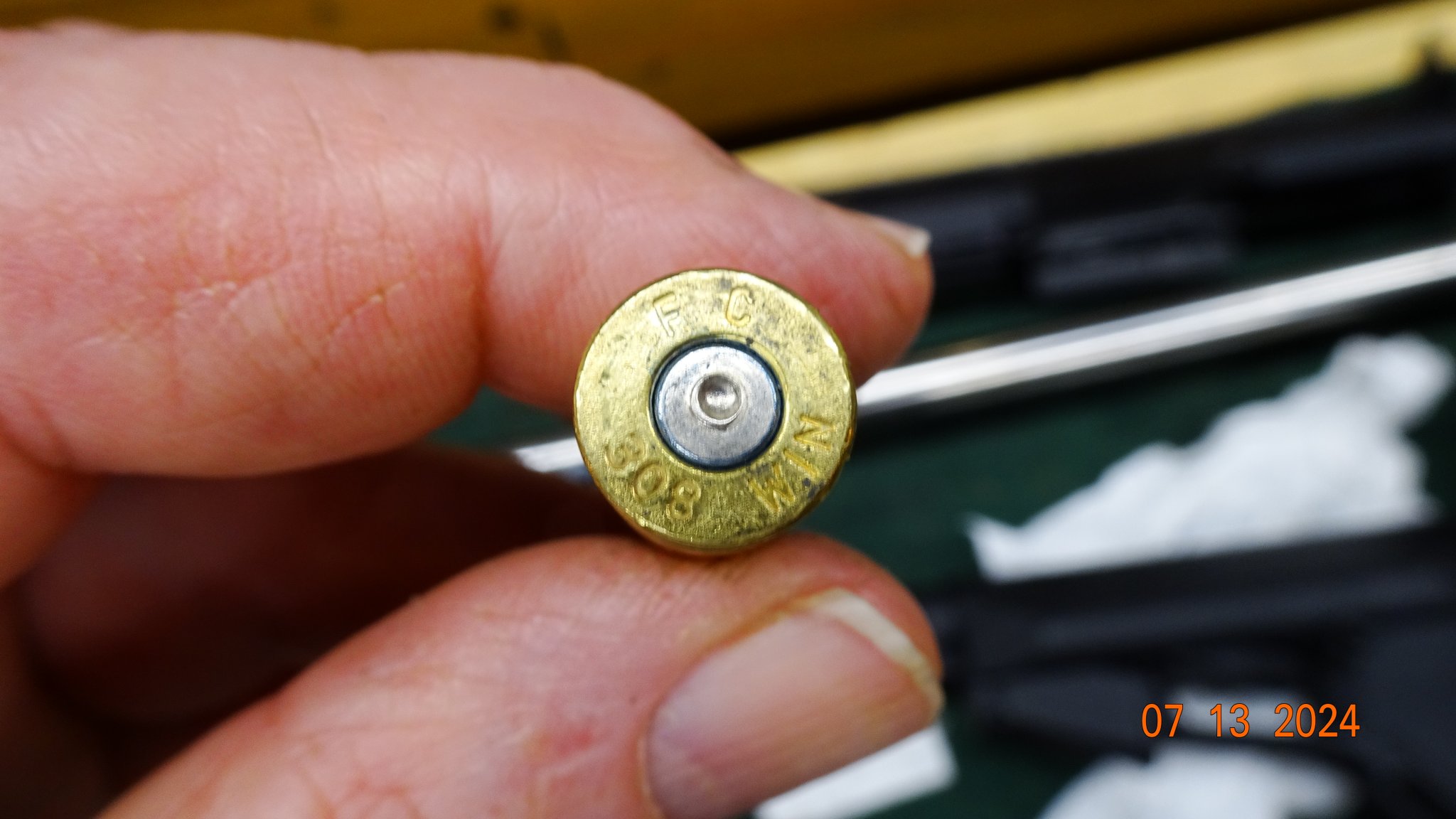

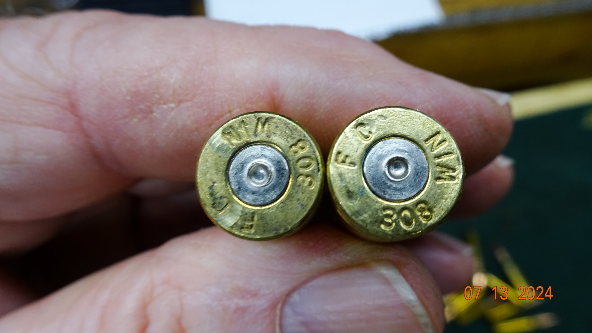

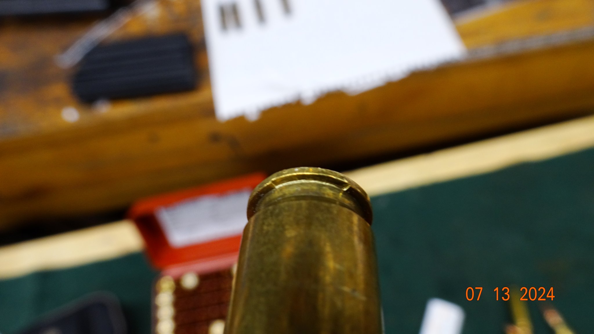

In the photos, #---572 has my hottest load on the left and my mildest load on the right. Photo # ---573 of the rim damage looks the same on all loads, including the Federal GM Match. The primers on the GM Match #---574 also look like my lightest reloads which is the case on the right side of #---572. The hottest and mildest for each of the powders I have listed in my original post look about the same on the primers and rim. The brass does not extrude into the ejector hole on the lighter loads. On the ---572 picture, right case, you can see the raised rim section between the 8 and W on the case head.
