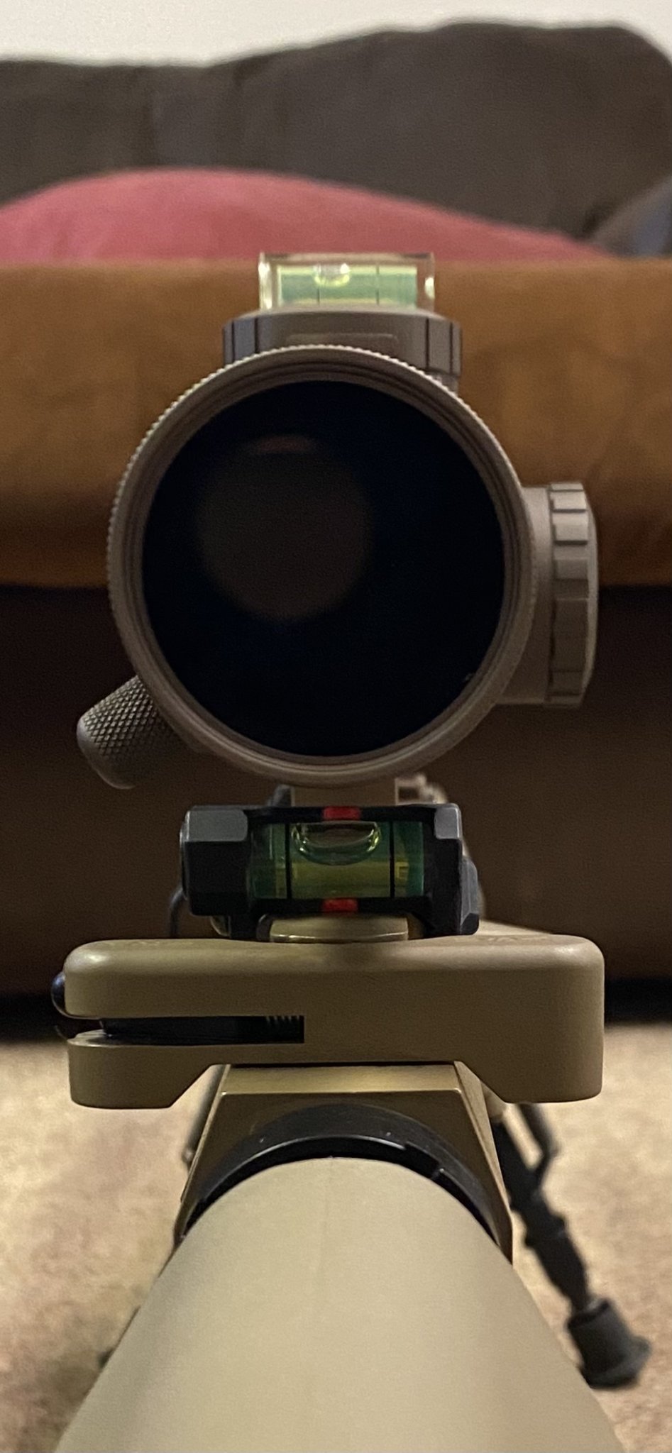

I’m confused right now. Mounting a couple scopes using the Badger dead level, everything is level as it should be. Then mount it to a rifle and double check it with the flashlight/ plumb bob method and the reticle slightly canted. Checked a couple other scopes that were mounted the same way and they’re the exact same as the others, slightly canted to the right. Any ideas?
Leupold Mk5’s and Nightforce NXS if that matters.
Top level on the turret cap or the ring cap? Either or both could be out of level relative to the scope tube and/or pic rail. Accuracy and resolution of the spirit levels? So many factors you’ll drive yourself nuts.

Maybe you can't trust top surfaces of knobs/caps to match the reticle.....trust the reticle.
Then again, we're looking at two cheap plastic spirit levels that could come as prizes in a Crackerjacks box.
If I’m following him right the cap and reticle are level with each other, but not level to the rifle.
Leupold Mk5’s and Nightforce NXS if that matters.View attachment 8542713
So they are all off and the same way. The common factor to all is the Dead Level.
It is a dinky little circular bubble, try putting a 4' carpenter level on the base and compare.
Level accuracy is something to think about too. I know that for instance the levels I use for scope mounting are within about a half degree of the level in my phone, but my cheap bullet levels I have for construction work are both about 3 degrees off. This is also taking into account the actual cant of the reticle as well. I assume this is due to the level vials being slightly off inside of the beam.
That’s another reason I use a level mounted to the scope tube as it’s not locked into something that is reliant on a straight edge that might be slightly off. You can rotate the scope mounted level around the scope tube until it is actually referencing the reticle vs having a fixed vial on a rail that is at the mercy of the manufacturers tolerance. If that makes sense.
ETA: percent, not degrees.

What you’re showing is two small spirit levels that don’t match which is not a surprise.
Suggestion: pull the scope off, put the level you have on the turret on the scope rail and see if it matches. You may just have two levels that don’t match as most spirit levels are crap.
Also, when doing the plumb bob test, I assume you are leveling the rifle using the rail mounted level which may well not match whatever level you used on the Badger fixture.
Finally, scope turret caps may not be (often are not) perfectly level.
You can have error from one or all of these factors.
My BBC advice is pic a level and stick with it as your standard. Level the rifle then level the scope with the plumb bob and call it good.

Thanks all for the advice. Ended up re-mounting the scope on the rifle using the plumb bob/ flashlight method. Out of curiosity I checked all the levels against the level reticle on the wall and they all seem to be good.
