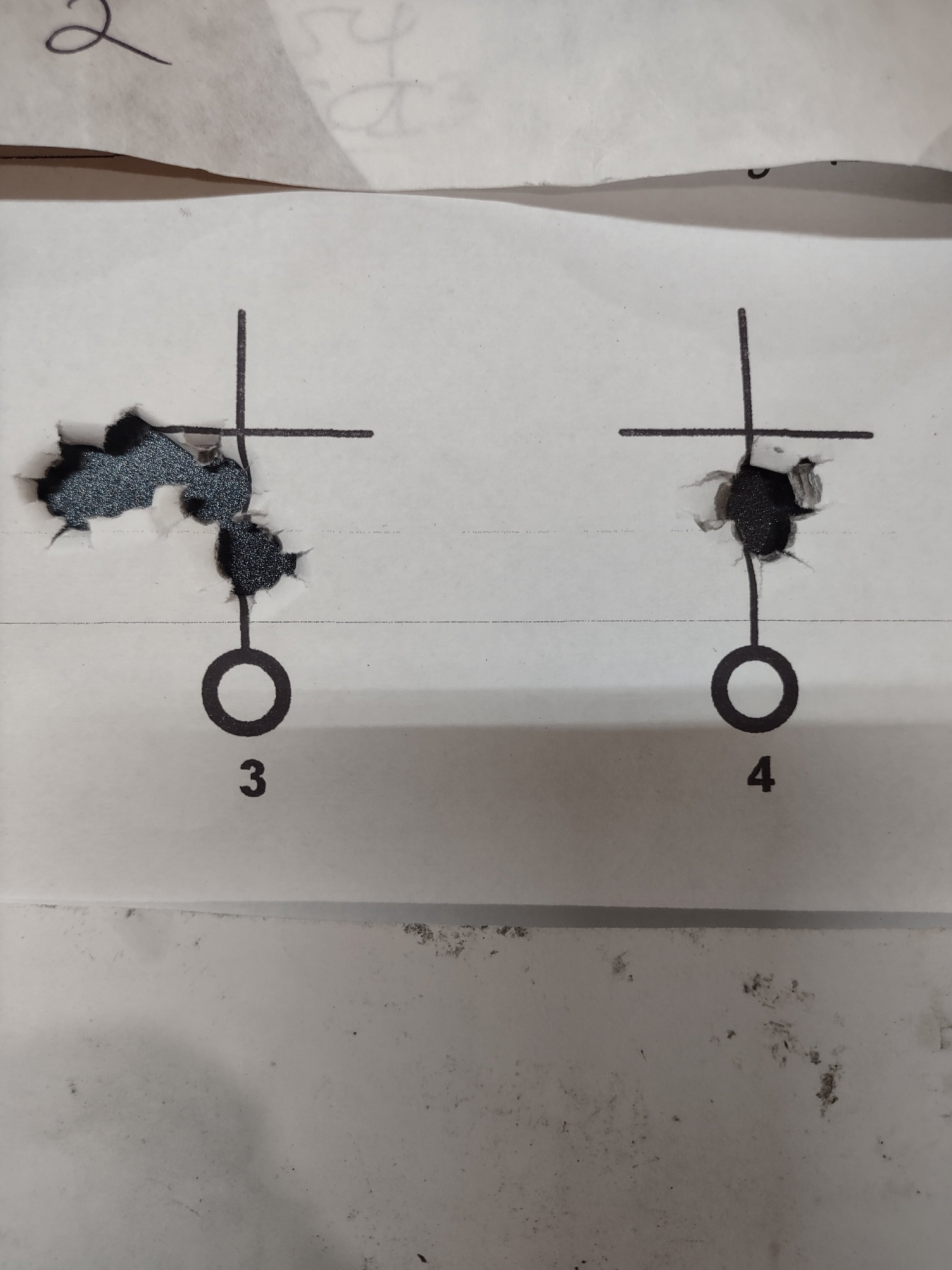

I've been shooting AR's for 30 years, have built a ton of them. My target AR15 (223) shoots 3/8", 100 yard groups pretty easily and consistently from the magazine.
Built another AR10 308 with top tier products... because I'm pigheaded and won't give up.
Matched AERO upper and lower
Nightforce ATACR 7-35 F1 Mil C
ARC M Brace mount
Midwest industries FF handguard
SLR adjustable gas block, 9 oz. buffer
Triggertech Diamond trigger
Craddock Precision custom Bartlien heavy 18" barrel
Rubber City Armory bolt carrier with JP high pressure bolt headspaced to the barrel.
Handloading using Sierra, Berger 168, 169 and 175 hpbt, Lapua brass, etc. etc.
Probably pounded 5-6 hundred dollars of components into the berm......
All Magazine fed...because that's how it's supposed to shoot.
Every group always looks like the one on the LEFT.....
TODAY out of frustration I had 5 rounds left exactly like the ones in the left target......and for some unknown reason I decided to single feed them. I pushed a round into the chamber and dropped the bolt release for each one.
Single feed is on the right!!!!!! WTF. Seriously. 0.142" 5 shot group.
Why the difference? Is it a result of the violent forces of the BCG slamming back and forth? Sort of depressing since it's a semi auto......
What is happening during the BCG cycling process that's introducing so much inaccuracy?
This has been discussed on here quite a bit if I remember correctly. Some say BCG settles differently when using semi auto vs bolt release vs racking the charging handle and letting that send the BCG forward. I believe the consensus is the BCG is resting at slightly different positions for each style and shows up on target.
Someone will be along shortly to correct me
Not enough neck tension on the brass and changing CBTO on bolt close? Sharp edges on the barrel extension chewing up bullet jackets?
I've tested different neck tensions with SAC bushings and expander mandrels from loose to tight. Makes no difference. The brass comes out like it was shot out of a bolt gun. Barely even feel or see anything on the case rim.

when you chamber a round from the magazine, run the charging handle and eject the round, is the bullet all scratched up from chambering? mine were getting tore up pretty bad. Polishing the feed ramps helped it out and tightened the groups back up.
I'll check....but I'd hope that for $760.00 Craddock Precision would have done this.... but I'll check.
It is my opinion that any round with a “longer” bullet sticking out the front of the brass, has more negative impact on the bullet’s seating as it is extracted from the mag, and is ran up the barrel extension/feed ramps.
The bullet gets slammed forward into the feed ramp(s), and “hopefully” the round is aligned as best as possible as it is chambered.
-when you single feed rounds you can slide them in nice and easy and not effect how the bullet is seated
Here’s a test…if you have a Concentricity Tool (I have a Hornady brand), set some rounds up that are perfectly concentric.
Then just run them thorugh the mag/feed cycle, without shooting them, by just pulling the charging handle back…running several rounds through.
Then check to see if the concentricity changes.
As mentioned, you could always use a smaller bushing to increase the neck tension on your brass when reloading.
-In a 6.5 CM, I would assume the 140 ELD will be more affected by the feeding cycle than let’s say a 123 ELD would.
My 2 cents
Shoot a 5x5 from the mag, then another single feeding.
Do this for 4 or 5 different seating depths and 4 or 5 neck tensions.
By the time you have enough data to figure it out, it’ll be time to call up Craddock for another barrel.
Or… accept that sub moa (which the left group appears to be) is exceptional for any semi auto.

Already sent the barrel back.... No issues found. Can't see it's anything with the barrel since it shot a 0.147" group single feeding it. I have to conclude that the rifle is accurate, my loads are accurate and I can shoot it accurately.... But something is happening during the BCG cycling that is screwing up something.... What that something is I have no idea......
Just to check out if my handloads are the issue.... I've fired factory FGGM and Federal T308T..... No difference when magazine fed. I have two different BCG's and nothing changes....
Just spit balling here, but have you checked the mag height in the magwell? Long shot, but could be your mag catch is holding the mag too low causing too steep of a feed angle. Once an empty mag is seated and the mag catch is engaged, how much up and down play is there?
IMO which is worth less than free.............
The one on the left is dead the one on the right is really dead. It is a semi auto which again IMO is not a precision gun. Yes they can be super accurate but it really is not what they were made for.
I saw something similar, but with an extra twist. Full mag would always stack the first two rounds in the same hole but eventually give 1.5” groups, single feeding by throwing a round in the chamber and dropping the bolt would give 0.7” groups. Suspected rounds getting messed up on feeding but couldn’t measure a setback or anything else on chambered then extracted rounds. Tried single feeding from the mag (pushed the round into the empty mag, then dropped the bolt) and got… 0.7” groups.
Clearly whatever was going on was from having the rounds *riding in the mag*. I was loading to just under mag length and I suspect the bullet tips were hitting/dragging on the inside of the front of the mag. I tried seating bullets 0.050” deeper and got consistent 0.7-0.8” groups from the mag.
Edit: this was in 6.5CM, Aero receivers, bedded Proof barrel, JP high pressure bolt, PMAGs. Was consistent across loads using Hornady and Alpha brass, 142 and 140 SMKs.

From another older thread here the theory was the alternating left-right pressure on the bolt carrier from the rounds in the magazine.
Thumper580, what powder(s) are you using in your loads?
The reason I ask, is that in the past, I've used temp sensitive powders before min an AR load...
And by the time I got to the 3rd and 4th shots, the chamber had gotten so hot from the previous rounds, the temp powder in the brass/round was increasing, and the velocities climbed dramatically....greatly effecting the grouping of any shots after 1 and 2...
This impact is not as great in a bolt gun, even with a round like a 300 RUM or 338 Edge using large amounts of N570.
Because all of the gas is going forward, and not heating up the chamber like an AR does. When the round is extracted while the powder/gas is pushing the bullet out of the barrel, and some of the hot gas is coming back into the chamber.

Typical 308 powders... IMR4064, IMR4895 and this group in the photo was Varget....
Maybe nothing? I would think your routine is different when you single feed. Comparable to a bolt gun, cycling the bolt vs single feed? Maybe there is more time between shots?
I'm not speed shooting it... Taking time between shots. For the reply about it being a semi auto, we obviously think differently. If this was a muzzle loader I'd be doing the exact same thing... How accurate can I get the weapon to shoot.... Not just make noise.
My 2 cents

I have an AR15 (Colt) that would shoot to one POI when feeding rds from the left side of the mag and another POI when feeding from the right side. Someone on another forum suggested that I remove the ejector and round off the sharp edges of the ejector face. This did indeed help a lot with my problem and I now do this to all of my ejectors if they are not already rounded. The theory is that when feeding from the right side of the mag, the ejector's sharp edges were providing more resistance when the case head slides up the bolt face during feeding. This would result in the BCG settling in a slightly different position relative to the round and chamber. Allegedly. True or not, the problem pretty much went away when I rounded the ejector.
I round mine by chucking the ejector into a drill and holding the ejector at an angle against an old "carborundum" sharpening stone while spinning it with the drill. All it takes is to round off the sharp edge.
Since that time (early 2000's) I've seen pictures of high end bolts with with the ejector face being completely hemispherical.
Personally, I'd want to shoot a few more groups single loaded to see if it repeated.
Groups shot from a machine rest will vary a bunch from really small to rather large with most groups near the middle of the range. I'm thinking this is not new news but the one .146 group could simply be one of the really small groups.

I thought the same thing. Didn't shoot several... Only one more 5 shot group, single feed.... It measured 0.176...
I see that I share some of the same opinions as a few of those above me.
Any large frame AR that will consistently shoot sub-minute (from the magazine) and is reliable, is a winner. I know that doesn't solve the accuracy disparity, but it is a perspective of serviceability.
I definitely believe that the force required to strip a round from the magazine and chamber it (starting at an angle no less) is going to have a negative effect on the bullet/seating. It wouldn't hurt to measure, then chamber and then eject at least 5 dummy (or live if you were at the range) rounds. I'd be looking hard at the condition of the jacket, nose, CBTO, and concentricity/runout.

I submit that if someone needs a second shot ready to go so quickly that they carrying a semiautomatic rifle, they are likely shooting at a decent-sized target that has a heartbeat, thus negating the need for a point zero zero zero zero one MOA group capability, unless gaming of course.
-Stan

Really, it is almost difficult to take a good shooter with a good rifle build, and using good ammo... shoot as poorly as 2 MOA these days from a rested setup. We're pretty spoiled.
However, I've noticed that my accuracy devolves pretty quickly when I'm trying to shoot at multiple running pigs in the middle of the night. No amount of pinpoint accuracy in the rig there is going to help when you step in a cow flop as you shift left/right and one of your feet starts to slide out from under you.
So, what you are saying is that; match precision is not needed on stationary live targets at modest ranges, and wasted on those same targets when moving?
I don’t put a bolt together without doing this for larger case head cartridges.
The Dutch started doing it with their AR-10 production way back in the late 1950s-1960s, and those rifles tend to be freakin’ accurate, unbelievably so in the samples I have shot.
iu
I mainly got into that technique from Hi-Power shooters who were shooting 6mm PPC, then 6mm AR, using Colt 7.62x39 and later Grendel bolts when Grendel came along in the early 2000s.
The reason I do it is for reliable right side cartridge presentation, and I never though about it contributing to consistent chambering and bolt lock-up. Could be another contributing factor into why I consistently see such good results with pretty much every barrel I have built-up around.
45-90 also points out that he uses tunable alignment bearings on his bolt carriers, so the tail can’t get out-of-center at any time during the cycling of the action.
Les Baer and someone else used to make Match carriers with oversized rails that ride inside the carrier raceway tighter, though that can degrade reliability really quick as the gun fouls.
There’s also a buffer with a rounded alignment dome that sits in the center of the back of your carrier to keep it aligned.
Squaring the receiver face and uses high-end barrel extensions make a difference.
When you add all these little techniques up, it can start shaving off fractions of an inch in average group sizes.
I feel it’s best to start from the get-go with as many things setting you up for success if you’re truly chasing bug hole groups.
I wish AA still made that tri-lobal firing pin that doesn’t drag as much inside the firing pin channel.

1. Not sure I get the question but it's straight up and down...level. Insert mag and push bolt release.
2. Typically 5 rounds for load development.
3. Tubb flat wire spring and a 9oz. heavy buffer to increase dwell time prior to extraction. Much easier on the case rim.. Barely feel any extractor activity on the rim.

A 0.142" 5-shot group?!? I don't care how you did it. I'd pay you to teach me your technique. LMK if you're ever in Arizona.
What follows is just one person's opinion. To get the best performance out of a "loosey-goosey" gas gun, it helps if we minimize variables.
1. You're creating a whole lot of wildly different dynamics chambering the first round with the rifle oriented vertically. Try getting behind the gun, loading the bipod just as you do when shooting, and then hitting the bolt release. That way, that first round into the chamber from the magazine is getting treated a lot more like rounds 2 through 5. This totally solved my "first round flyer" issue.
2. Loading five and shooting five is what we typically do in load development. Let me suggest a slightly different, very simple approach which may reduce your group size. Have you noticed how easy the first round loads in a magazine, with increasingly more effort required with each round loaded? That increase you're feeling round to round varies significantly over the first five rounds. This translates into different amounts of upward pressure on the bottom of bolt carrier from the top round in the magazine. Rounds 6 - 10 load with less difference in effort required than do 1 - 5. This means that the upward pressure on the bottom bolt carrier from the top round in the magazine varies less during rounds 6-10 than 1-5. I get better 5-shot group results with the first five out of a magazine loaded with ten rounds than I do when I simply jam five in the magazine. A geriatric Camp Perry champ taught me this trick 25 years ago. This totally solved my occasional "last round flyer" issue. I swear it wasn't me...
3. Nothing against Tubb springs here. David Tubb is IMO national hero status, and his work in putting metal on meat continues quietly but unabated to this day. But, I think experimenting with different recoil springs and buffer weights - and maybe even a JP LMOS bolt carrier - may produce some interesting results. For what it's worth, I get my best results in a .308 gas gun with a JP LMOS bolt carrier (with your same high pressure bolt), JP big block carbine recoil spring, adjustable gas block, and ... H2 buffer. Recoil is nothing with this combo. I can get similar accuracy results with a JP SCS, but the recoil increase is noticeable to me.
BTW - I've bought like $50K worth of Craddock barrels. Craddock Precision polishes feed ramps on gas gun barrel extensions with the best of them. He is, quite simply, the best there is at what he does. I passionately hate the fact so many people know this, and lead times are as long as they are. If you complain about your rifle that shoots 0.142" groups, he's probably going to want to buy it from you.
