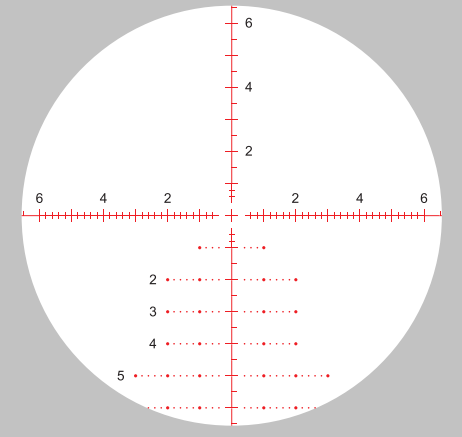

Here a cronus btr in mil with .2 dashes

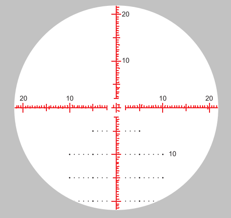

Here it is in moa with 1moa dashes, looks pretty nicely proportioned to me
I filled the moa with dashes in between to simulate the half moa dashes (which equates to .15 mils). Looks a bit cluttered and I could see myself getting lost in it.

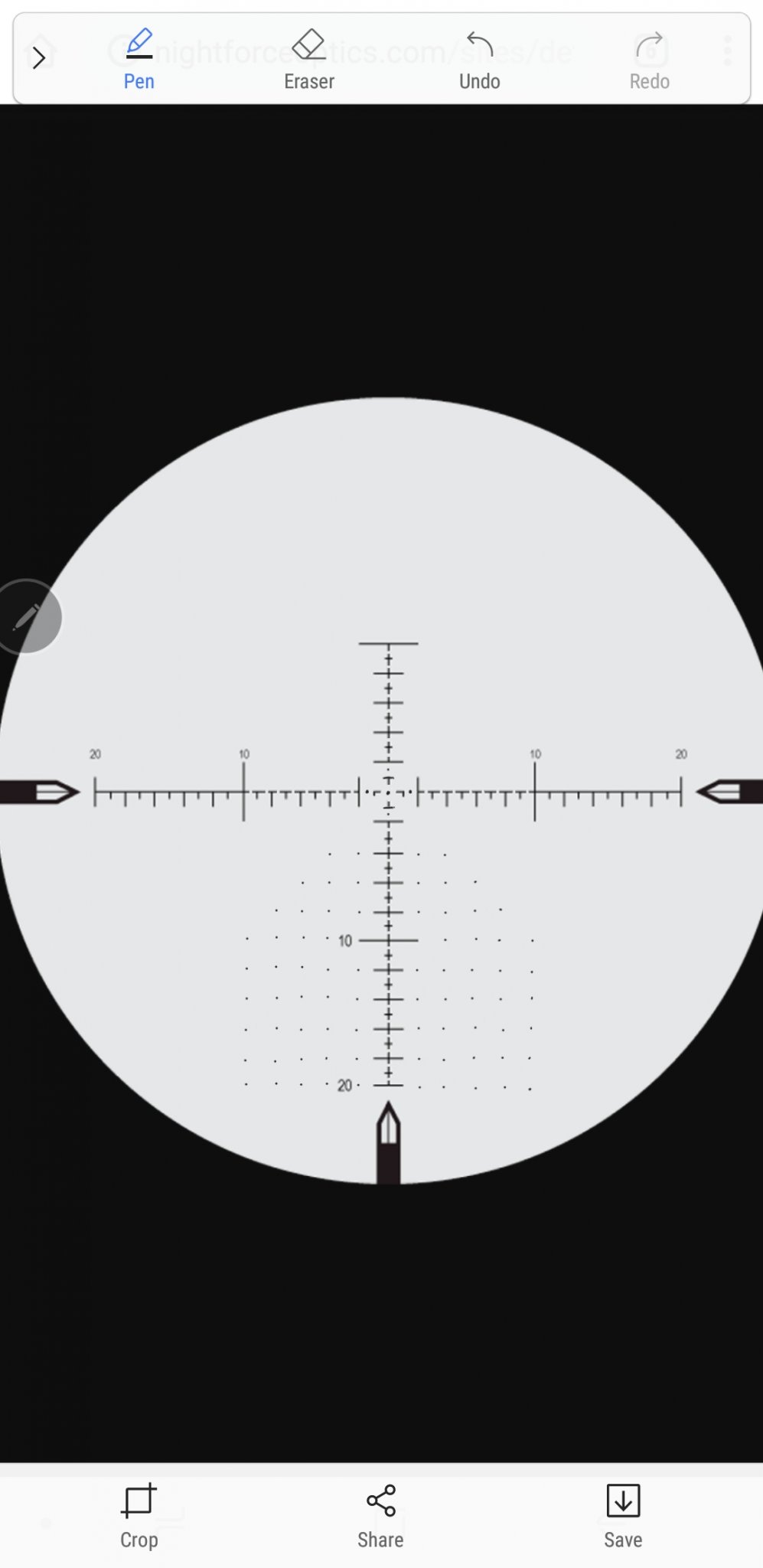

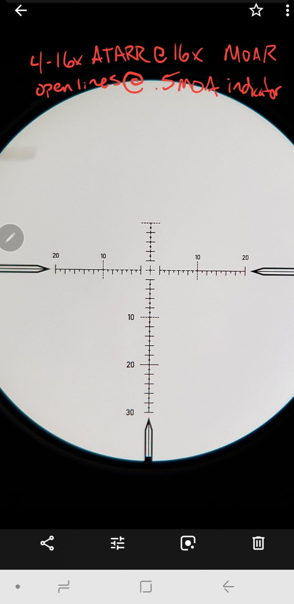

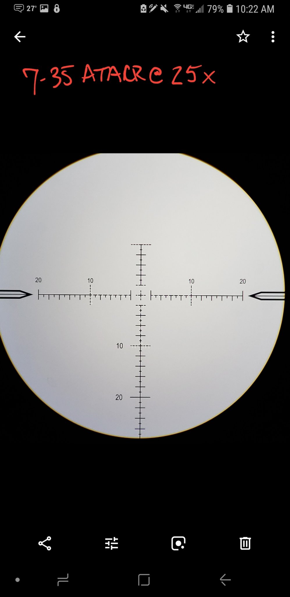

I agree that .5MOA hash would be too cluttered, which is why I was thinking more of open spots to indicate .5MOA. A .5 open indicator would likely only work on higher mag range (18-30x) but that power would only be used for precision at longer range. Inside 500 or so, wind isn't as influential holding between two 1moa lines would probably work (and does). I'm going to take photos of actual reticles through scope and see if I can photo shop on a 16x ATACR and 7-35 at different magnification levels.
I’m a MOA guy and I really like that NF reticle, is that new or something photoshopped?
Photoshop... It's a MOAR reticle with gaps at each .5MOA. concept was to prevent clutter but use the gap to have a .5moa wind/elevation hold marks. Who knows? Maybe a company out there will create something similar.

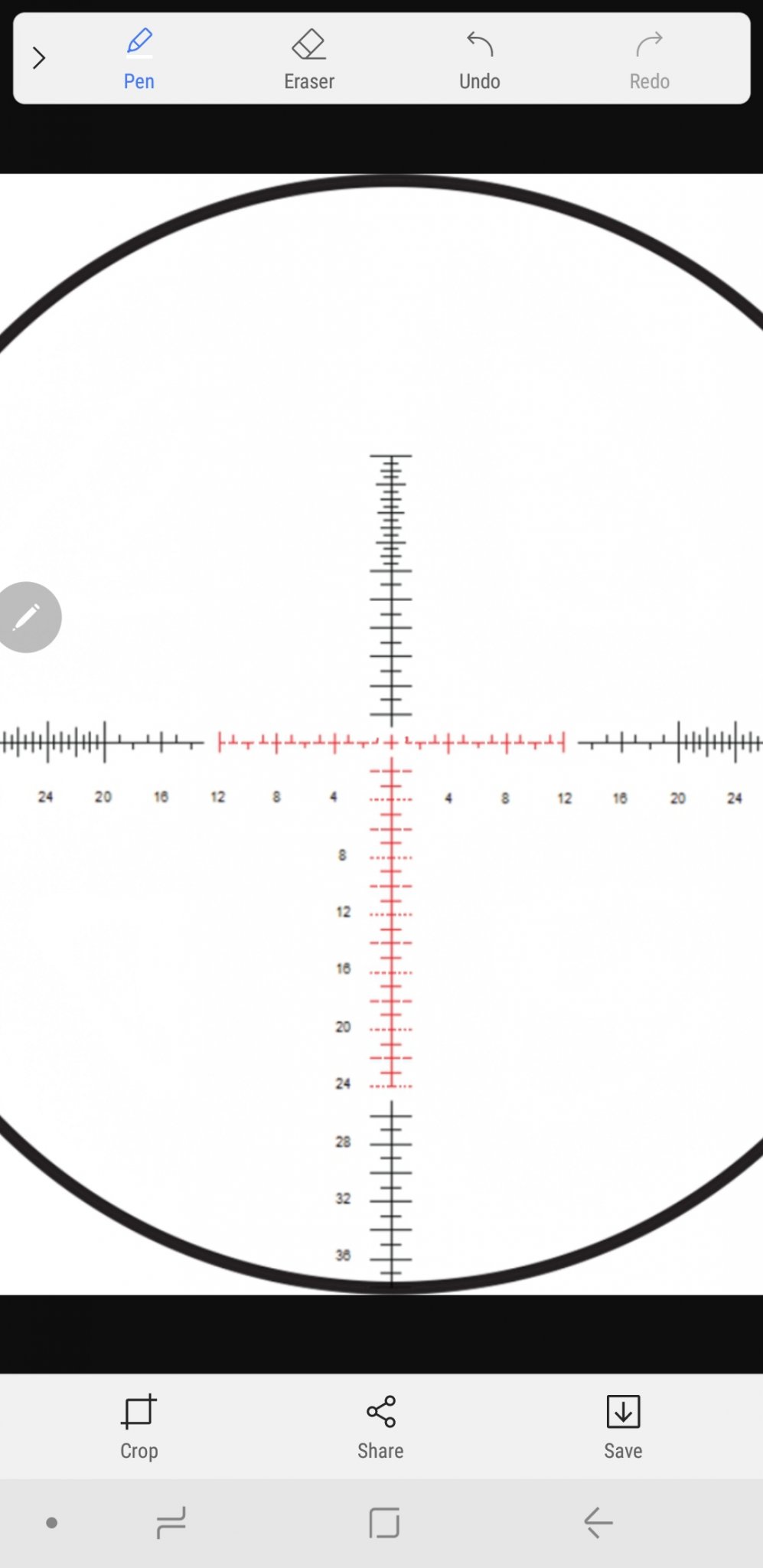

Mocked up the Burris SCR the same way:
I too like the MOAR. Un cluttered is one reason why. As for half min. wind holds if I think I need it I favor the target.
The modified reticle is work well done. I can see real value in it , especially the grid.
