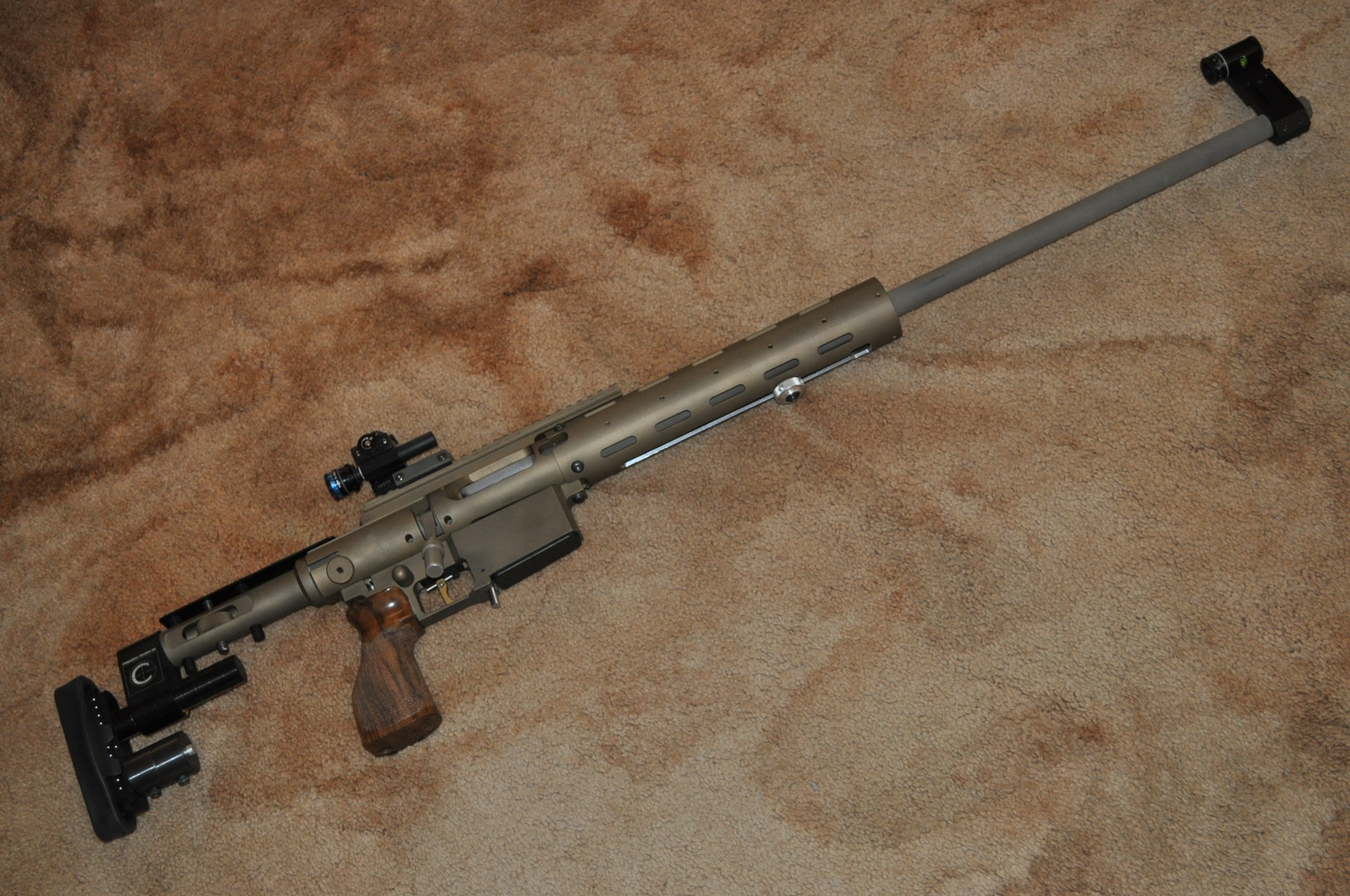

This is my Eliseo RTS, set up for XC HP, with a Pearce TG action -not glued in-, 28" Krieger sendero contour in 6.5x47, CG trigger, PNW rear/Riles tallboy front sights, and Doan Trevor custom pistol grip made up from left over pieces of English walnut out of a nice blank Doan turned into an extremely nice sporter stock for a CMP M52 that I rebarreled. This was my 2nd Eliseo tubegun, the first being a R5 in 6BR, also using a Pearce TG action.
These were my first Pearce actions; they run extremely smooth, and accuracy out of both has been excellent. I ordered an extra bolt with the first one, with 223 boltface, and have a 30" Bartlein med. Palma 223 1-7.2tw for it that I throated out an extra .080" for use with Berger 90VLDs - so I can swap back & forth between the 223 & 6BR by changing bbls & bolts.
The RTS shoots great at 600, using RL-17 & Berger 130VLDs at a little over 2900fps. I run S107MKs at 3000+fps for 300, and 85gr FBHP Bergers at 3100fps at 200. Far as I'm concerned, there's not a better XC cartridge out there than the 6.5x47....oh yeah - forgot - your mind's made up on the 243.

You're welcome. The R5 was the 1st bolt rifle I ran in XC matches - before that, I'd been a SR shooter until legging out, then went with 6HAGAR & 6RAT spacegun uppers. The learning curve associated with running a stick shift was a little frustrating at first, but when I got to the point where I could run through all four strings of rapids w/o an alibi, I felt like I'd really accomplished something.
Only regret with the R5 was not going with a 6 Dasher instead of the BR, but I'd had questions whether the Dasher would feed as smoothly as the BR. I built another R5 for a friend & customer in Dasher, but his sons got into high school & college sports about the time I finished it, and AFAIK, he's yet to run it in a XC match.
After getting the RTS 6.5x47 up & running, the BR's lack of performance relative to the Dasher became a moot point, since the 6.5 has so much more performance than either the Dasher or BR. And the RTS ran better in the rapids than the R5, since I didn't have to run the bolt as quickly while ejecting empties in order to prevent an empty BR case just flipping around 180* and remaining in the action.

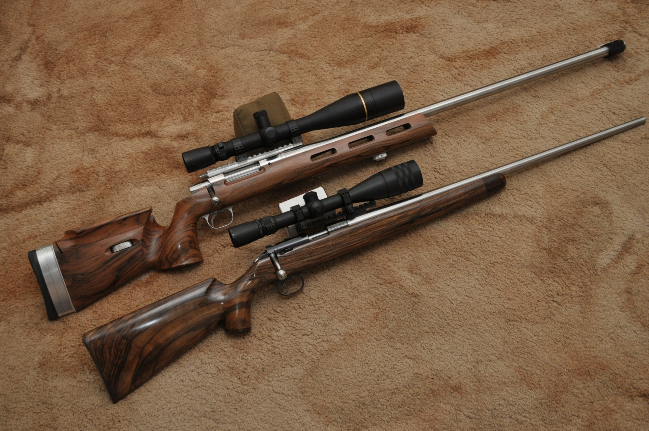

I use smallbore rifles as trainers for mid & LR prone. I've got an Anschutz 1611 with a stock that's basically the same as the Robertson H&H prone stocks on my CF LR rifles. The 1st M52D I received from the CMP was in good enough shape to restore as a target rifle, so that's what I did. However, the 2nd one was not in very good shape, with a ratty bore, and the bolt's S/N not matching the action's, so I had Mike Ross re-barrel it with a Broughton sporter weight match bbl, and asked Doan Trevor to make me a copy of the 52B Sporter stock. I'll have to dig around on the desktop computer to try to find a decent photo of it to add to this reply later. 'Bout forgot to add that I was lucky enough to be able to get both my M52 triggers worked over by Karl Kenyon before he passed away. Talk about an improvement in triggers!
Good luck with whatever route you decide to travel - I'm sure you'll enjoy shooting a tubegun.
ETA - This is the only photo of the M52 Sporter I could find - along with it is a BAT 3L prone rifle with a McGee Trudy pattern prone stock, also finished by Doan Trevor. Calling Doan a craftsman isn't enough - the guy's an artist in wood.
