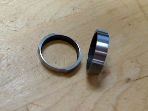

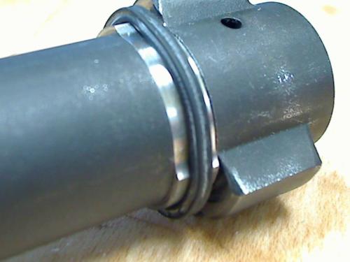

This is an option I came up with that may be the best of all worlds and comes with a bonus.
Pads leave plenty of running room for dirt but remove all movement when locked up.
Bonus is the downward pressure of a couple of thou help offset the misalignment of the cartridge caused by extractor tension. ;-)

The bushings I posted a picture of were my first attempt at Borden bump style bushings. After I installed them,I turned the bumps down to zero fit and finished them by hand. They may not be for everyone but I guarantee that you can get a vault tight fit when locked and factory loose bolt when it is not. In addition, they don't change headspace, so it's a cheap retrofit if you're not doing a full build. Much cheaper than replacing the bolt.
