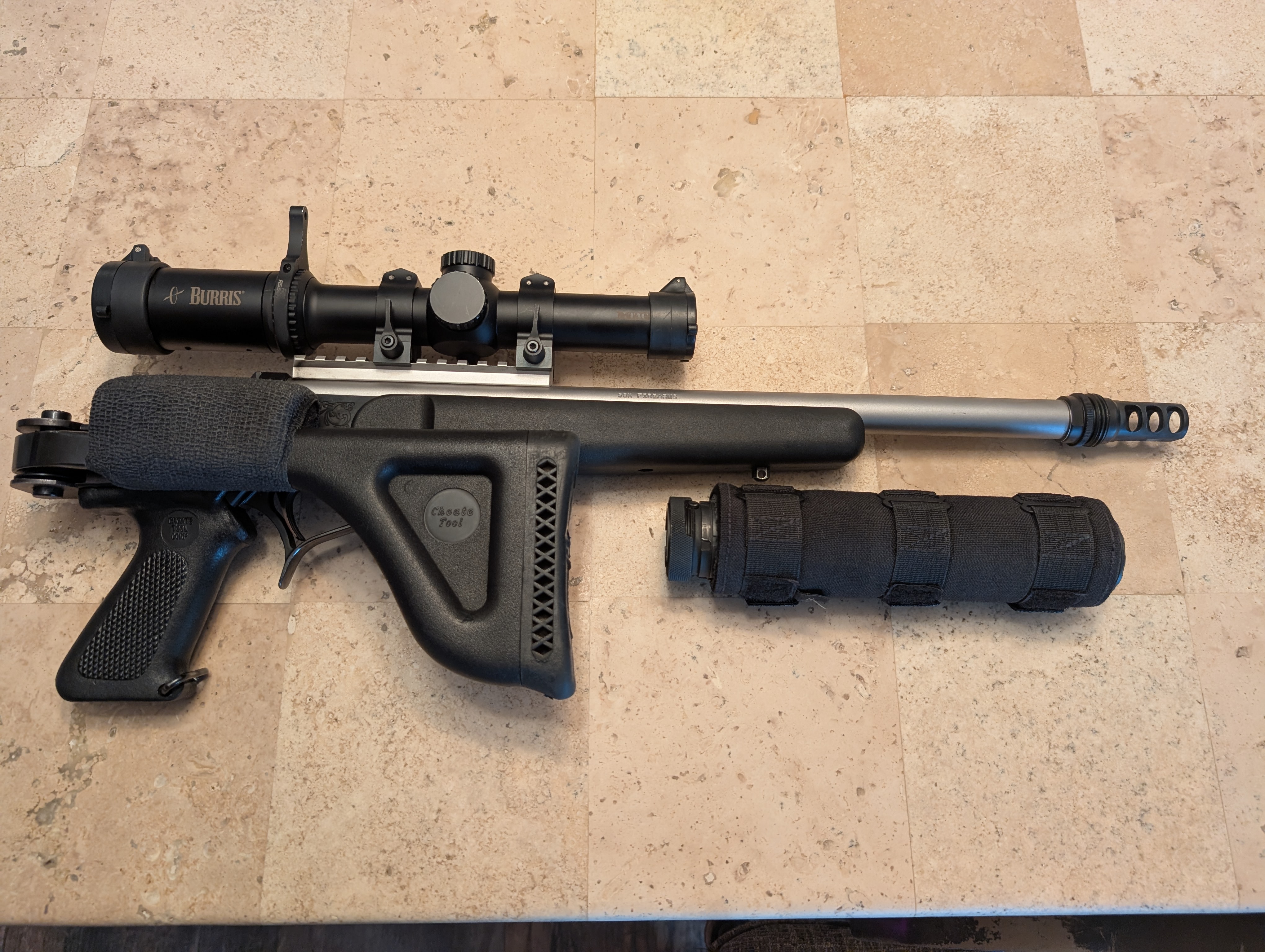

Why don't ya ask a guy who shoots one, if ya really want to know.
It is a pretty good caliber for an AR 10.
For short range super knock down power, okay with subs in the 350 gr SMK.

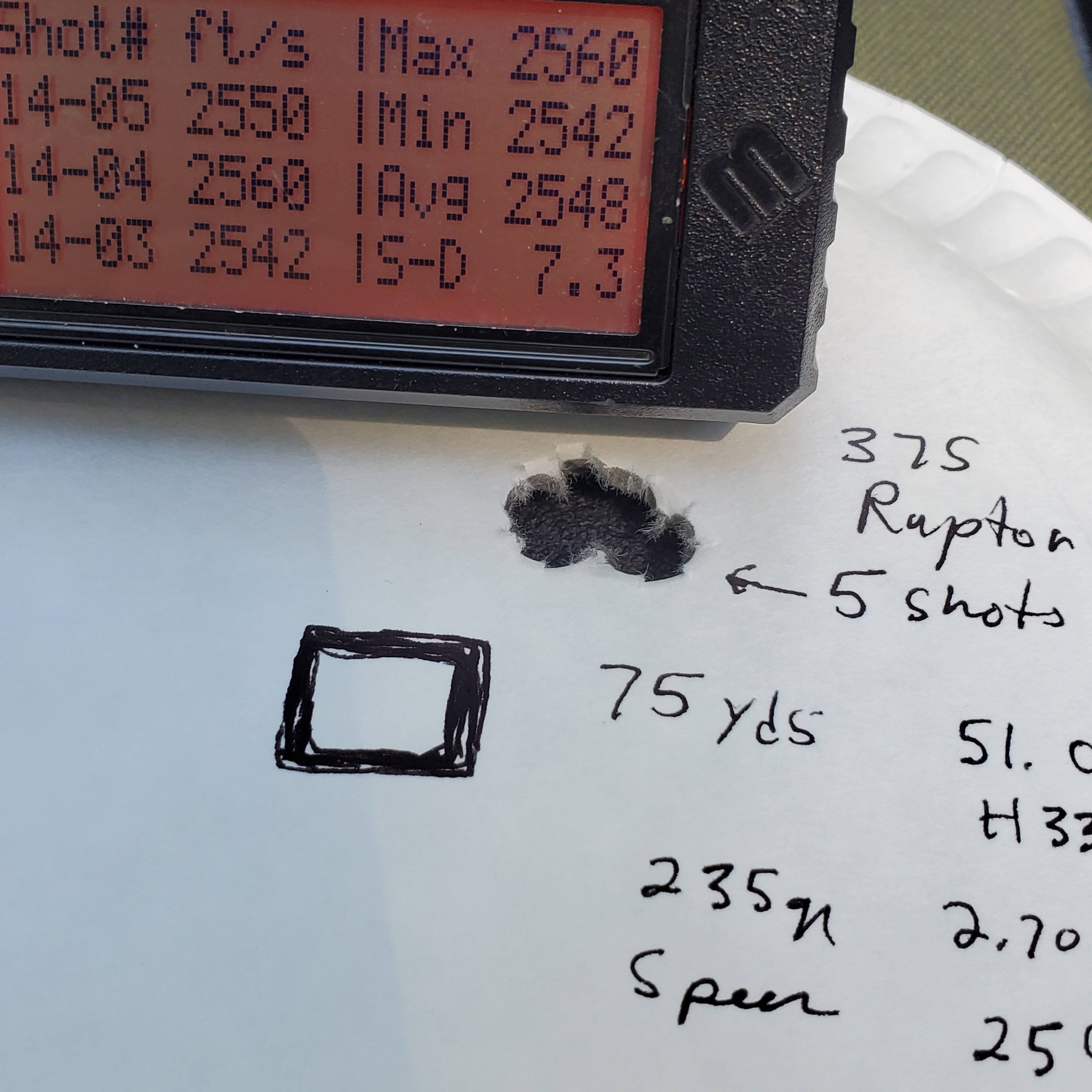

Mine has a 20" barrel so it can reach 2550 fps with a 235 gr Speer and 3400 ft/bs of muzzle energy...but that's only good on big game for about 200 yds. Because of poor BC of the bullet...but it's very accurate.
I scrapped the 3 twist 8.6 blkout unworkable...changed it to 6.5 twist and it works pretty well now in a bolt gun.
But the AR in 8.6 turned into a 375 Raptor AR. Definitely better than a 3 twist 8.6 but that is just about everything.

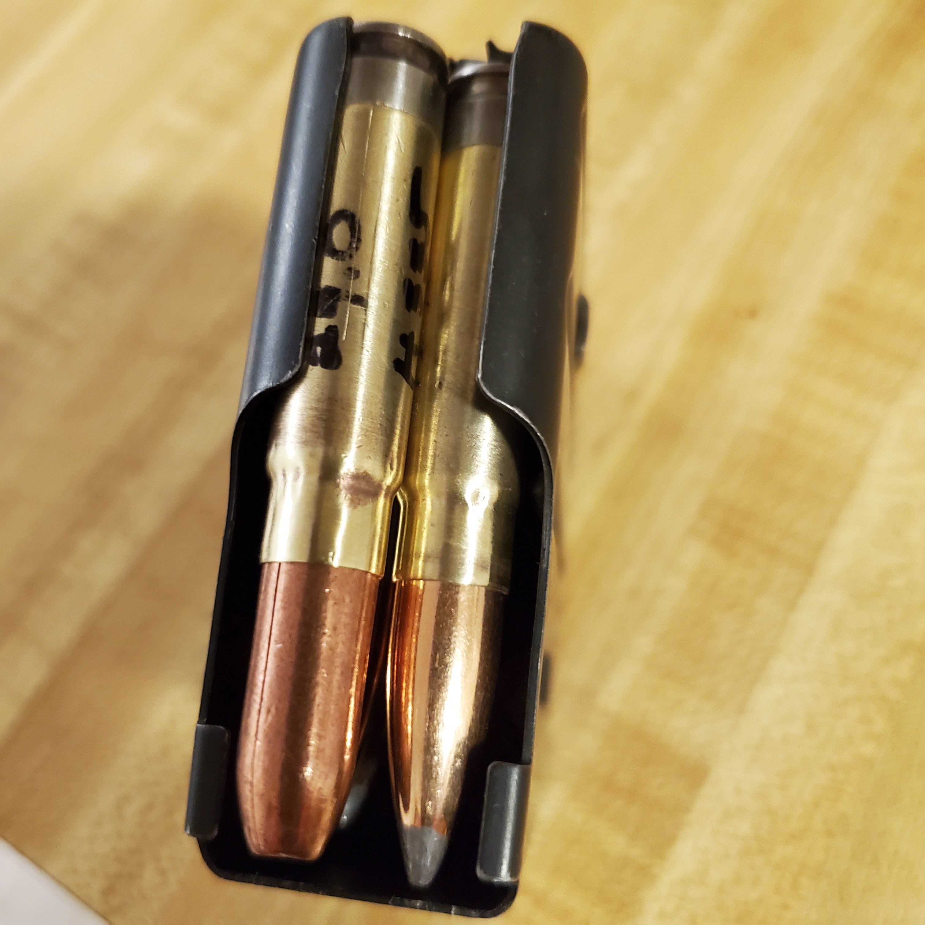

My AR 10 is modified to feed 2.940" cartridges.
Also note hybrid cases...not needed, but I have them.

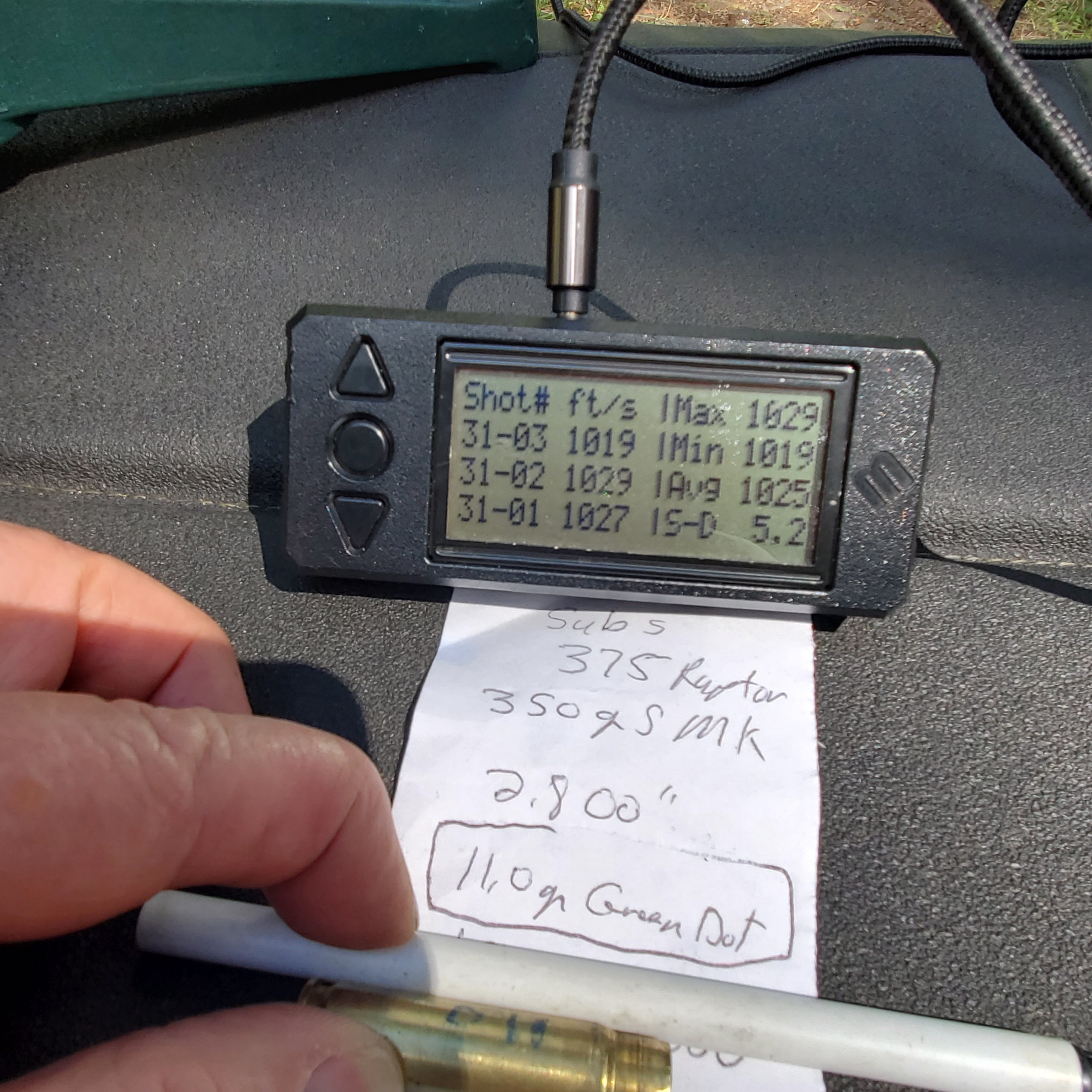

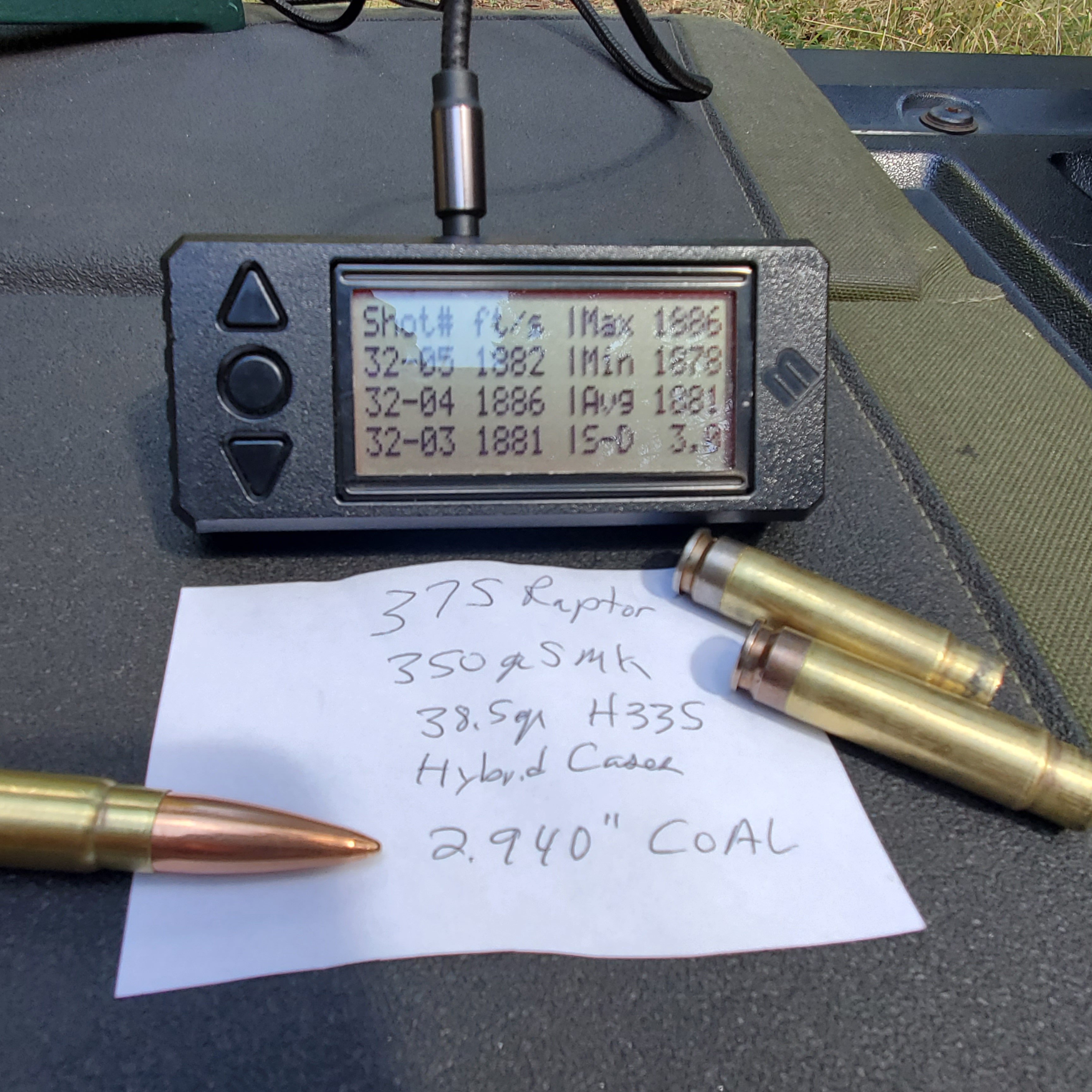

The 350 gr SMK supers have a different COAL 2.940" than the subs at 2.8" to take up powder space, as this cartridge has
Too much capacity to be excellent at subs but it does a relatively good job, supers is where it's at for short range killing power on game animals, like smacking down hogs.

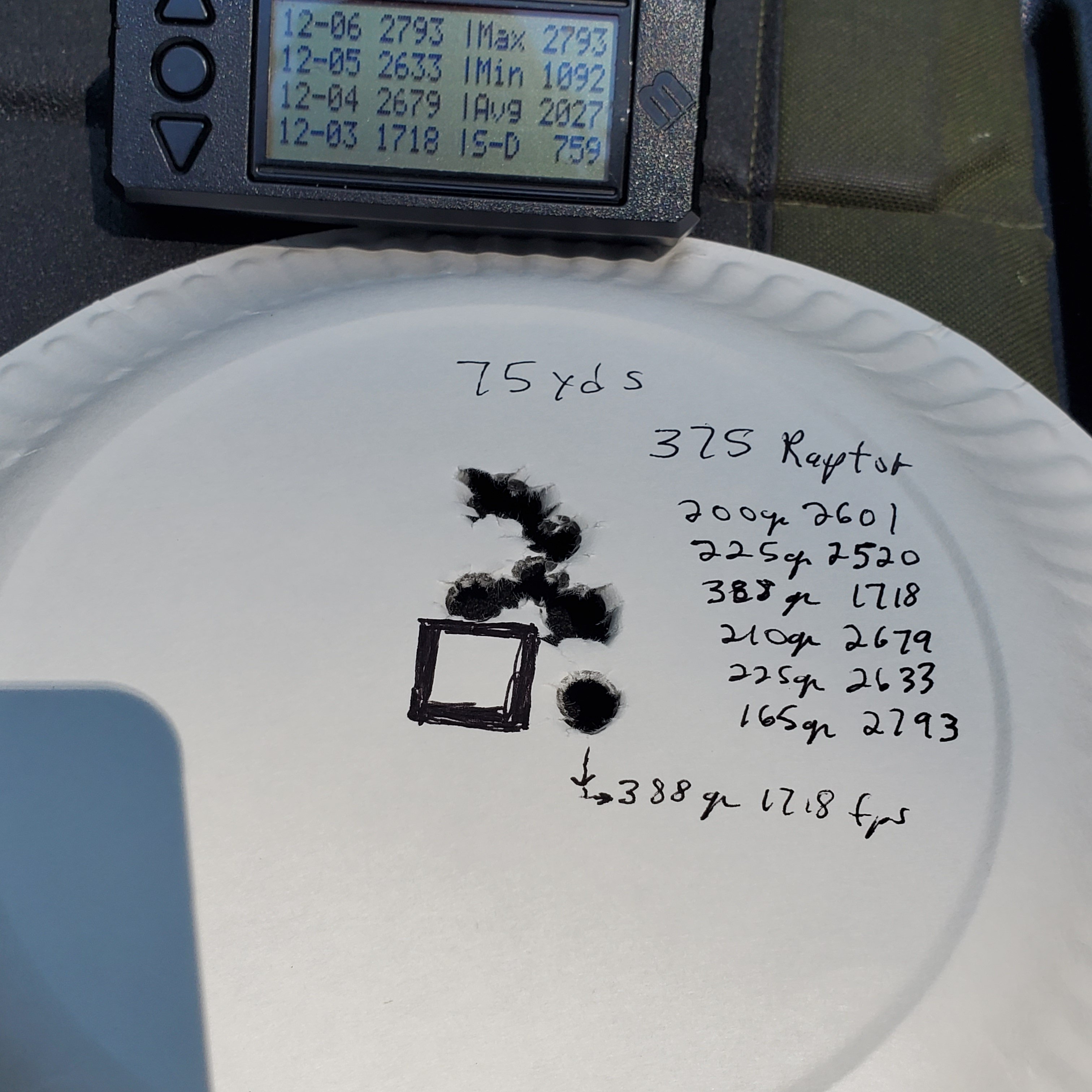

I like the 375 Raptor, it's fun to shoot, and have posted load data for it.
No hype just actual performance data, to see if the 375 Raptor might be a cartridge that fills a need for your shooting/ hunting endeavors.

I use a 20" AR 10 cause it gives the 400 gr Maker 1718 fps ...and it mushrooms 3 times the dia down to 650 fps...according to Maker....so one could still expect expansion way out past 1000 yds at this speed....if you could hit the vital area....which is doubtful.
The drop would be ridiculous at great distance...but if one chooses the right bullet ...and checkes it's performance at 650 fps in this instance.
One can potentially shoot at great distance.
There is loaded ammo with Maker bullets in 250 gr super and 400 gr subs at 1050 fps for those who don’t reload.

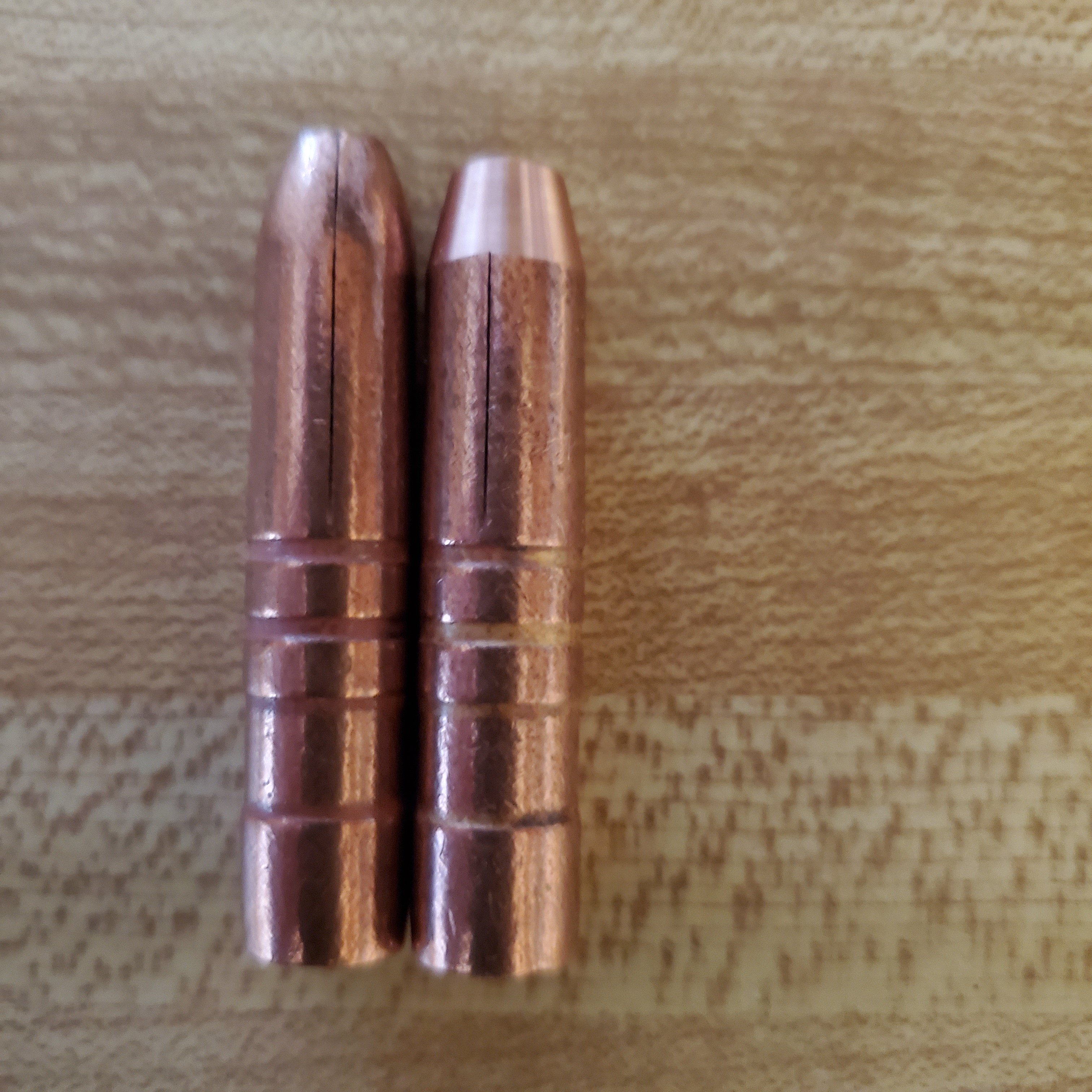

The 400 Maker is a bit lighter than 400 grs, I point mine in the lathe to 388 grs.
I ran all these different supersonic bullet weights at the same target with their varying velocities at 75 yds.
Supersonic is where the killing power is at but subs are fun to shoot.

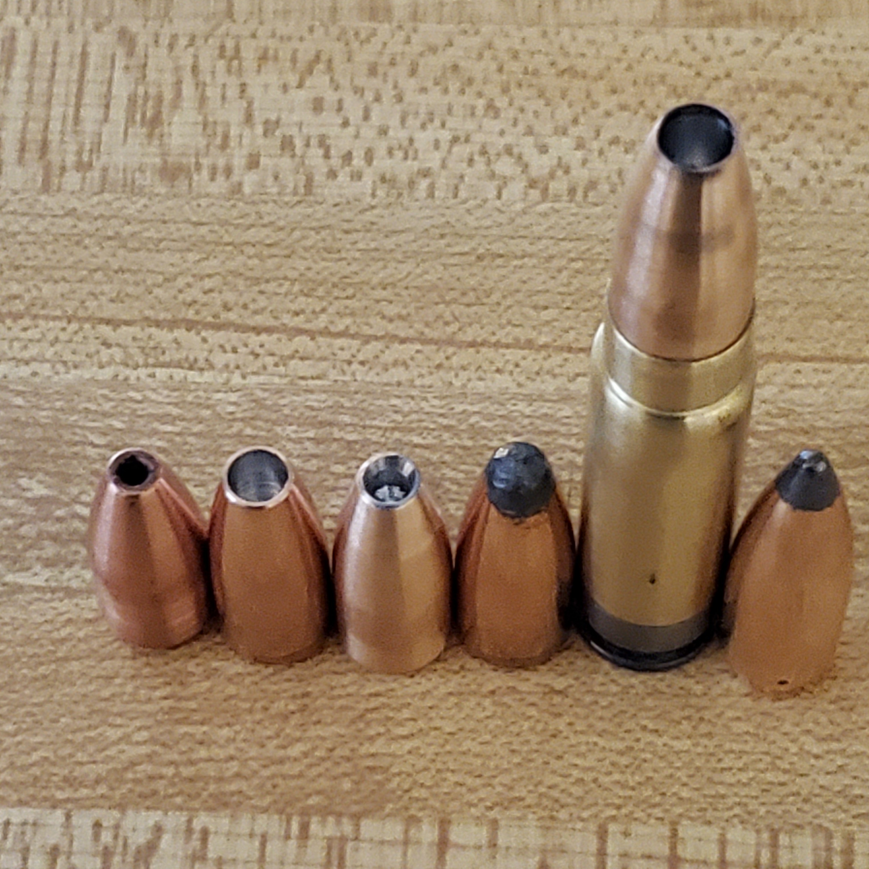

Here are lathe turned bullets, modified for different performance options.
