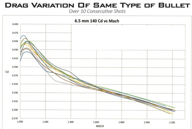

4DoF uses Cd vs. Mach data gathered with doppler radar over the entire Mach regime of flight and has some other built-in physics that handle aerodynamic jump and wind drift very accurately. The AB solver with the CDM's is also reasonably accurate although with some more limitations (mostly wind/AJ related) but should be no problem to get a 6.5 with 140's hitting out to 800+yd regardless.
If you're using a single-input BC solver... You're going to get errors with many projectiles. The BC value (G1 or G7) is fluctuating through the Mach regime so a single input value is cutting corners and will be high/low in various areas.
Anyway, lying to the program about MV is going to shift the Cd vs. Mach values the program references and usually causes bigger issues than changing BC, especially when you change temperature, altitude, locations, etc. Again, though, a single BC value is a compromised approach in 2024 IMHO.

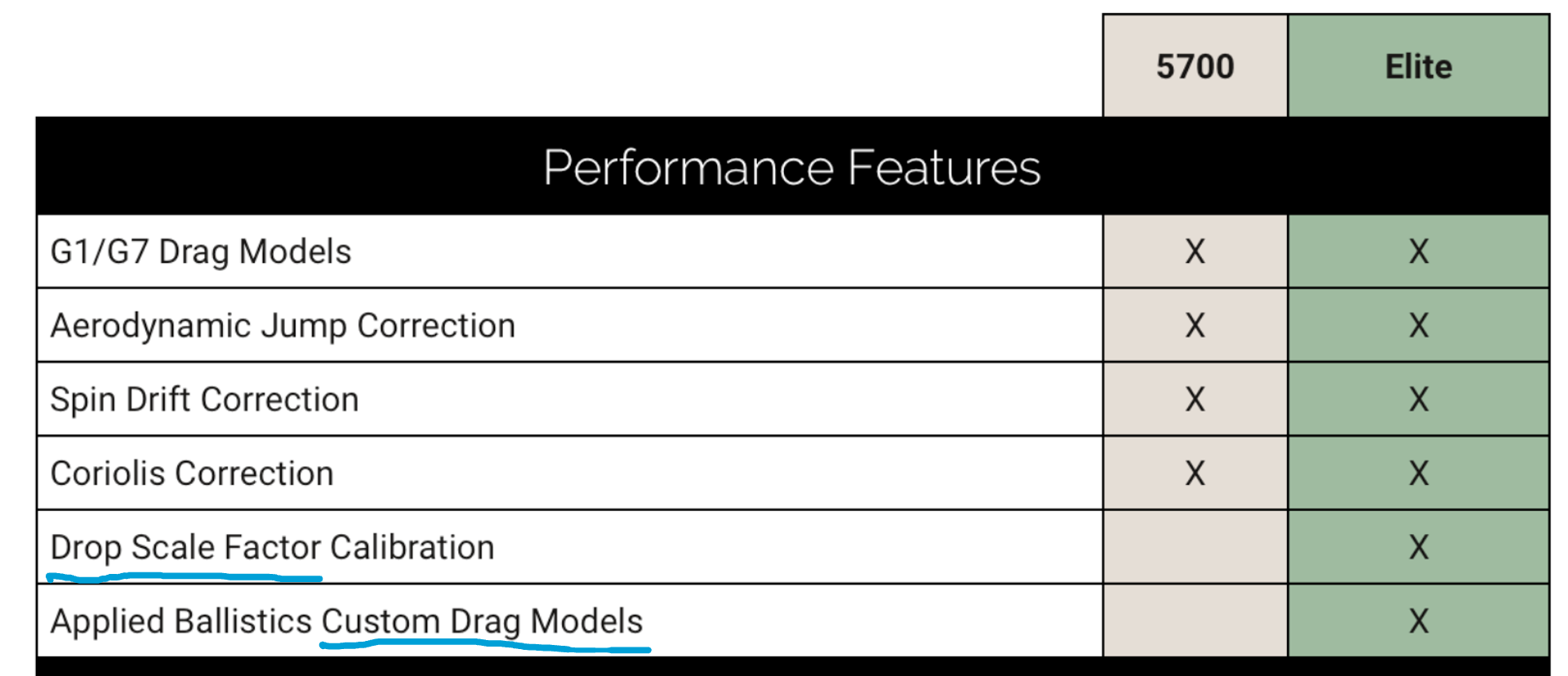

I'm using AB in my Kestrel, but I don't have access to the custom curves since I don't have the elite model. It's on my list of things to upgrade, but I haven't done it yet. This might push me there since I've seen a lot of talk about using the custom curves vs the G1 or G7.
