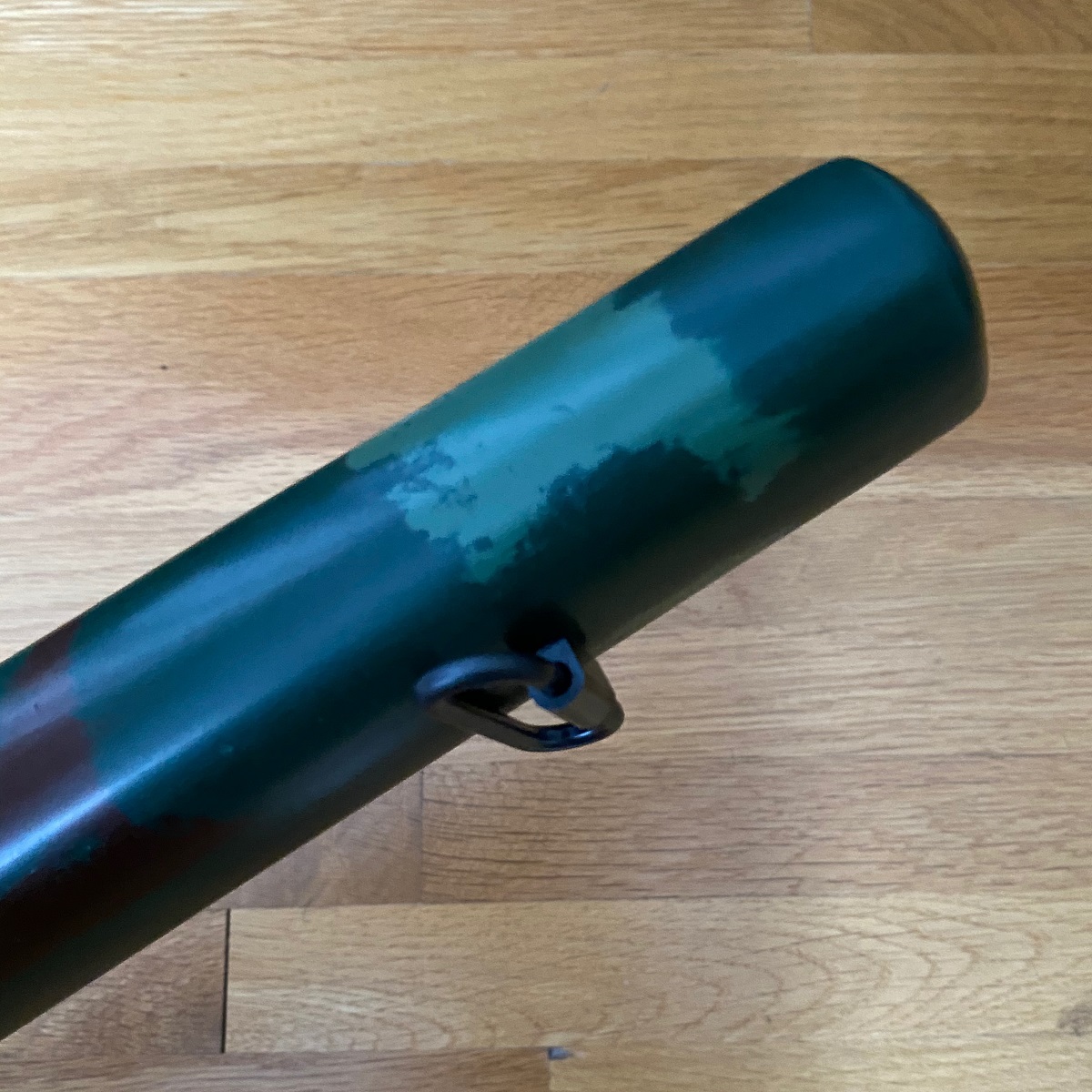

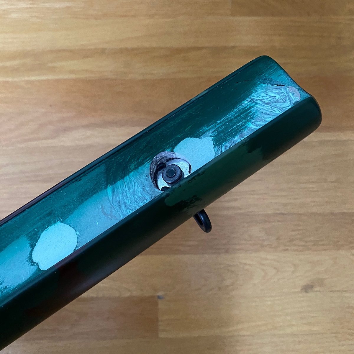

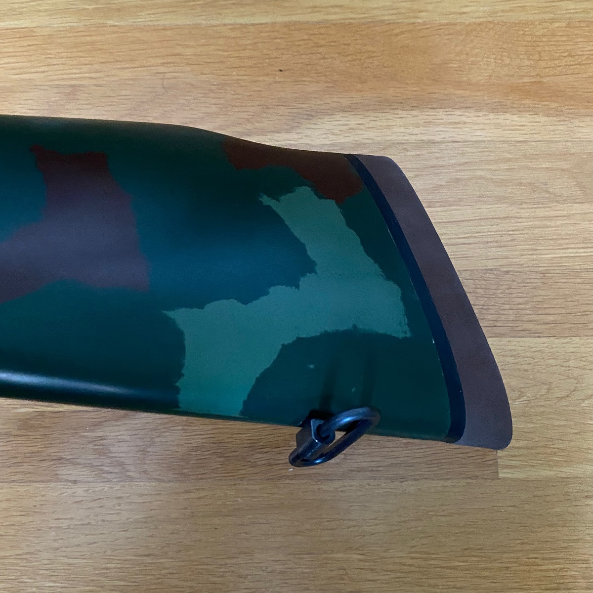

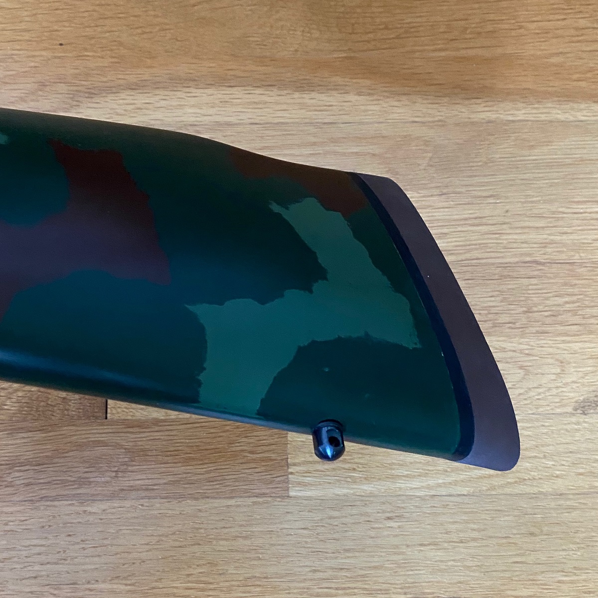

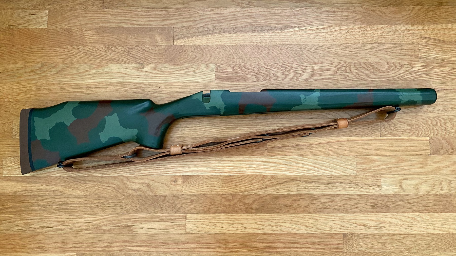

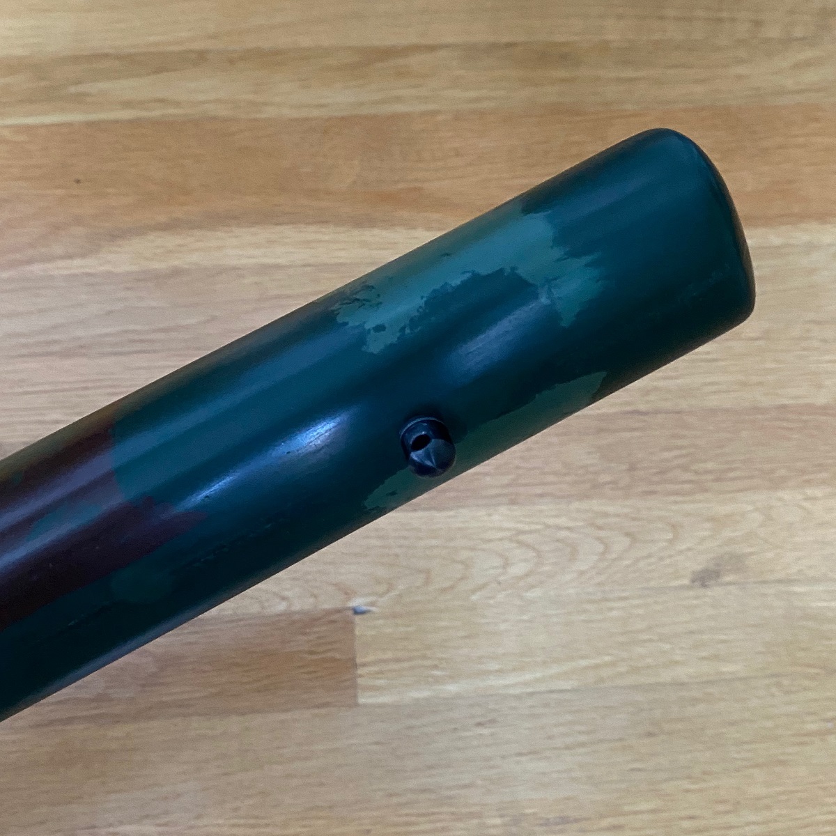

To close the loop on this thread: I found an earlier production McMillan HTG stock with a nice forest camo finish that I wanted to turn into an M40A1'ish stock by replacing the existing sling and bipod studs with direct screw-in attach sling swivels that would also be wide enough to use with a leather M1907 sling.
The final product is pictured here, with some stock work by McMillan (replacing the front two studs with a single one positioned in between, installation of a threaded insert in the rear since it previously had a wood type screw-in stud, install of thicker brown Pachmayr recoil pad since the LOP is cut for it) and custom threaded Wichita sling swivels. The custom threading on the Wichita swivel studs left a little play when screwed into the front aluminum t-nut, causing it to strip when tightened down, but this was fixed by adding a steel nut at the top from a wood stud.
