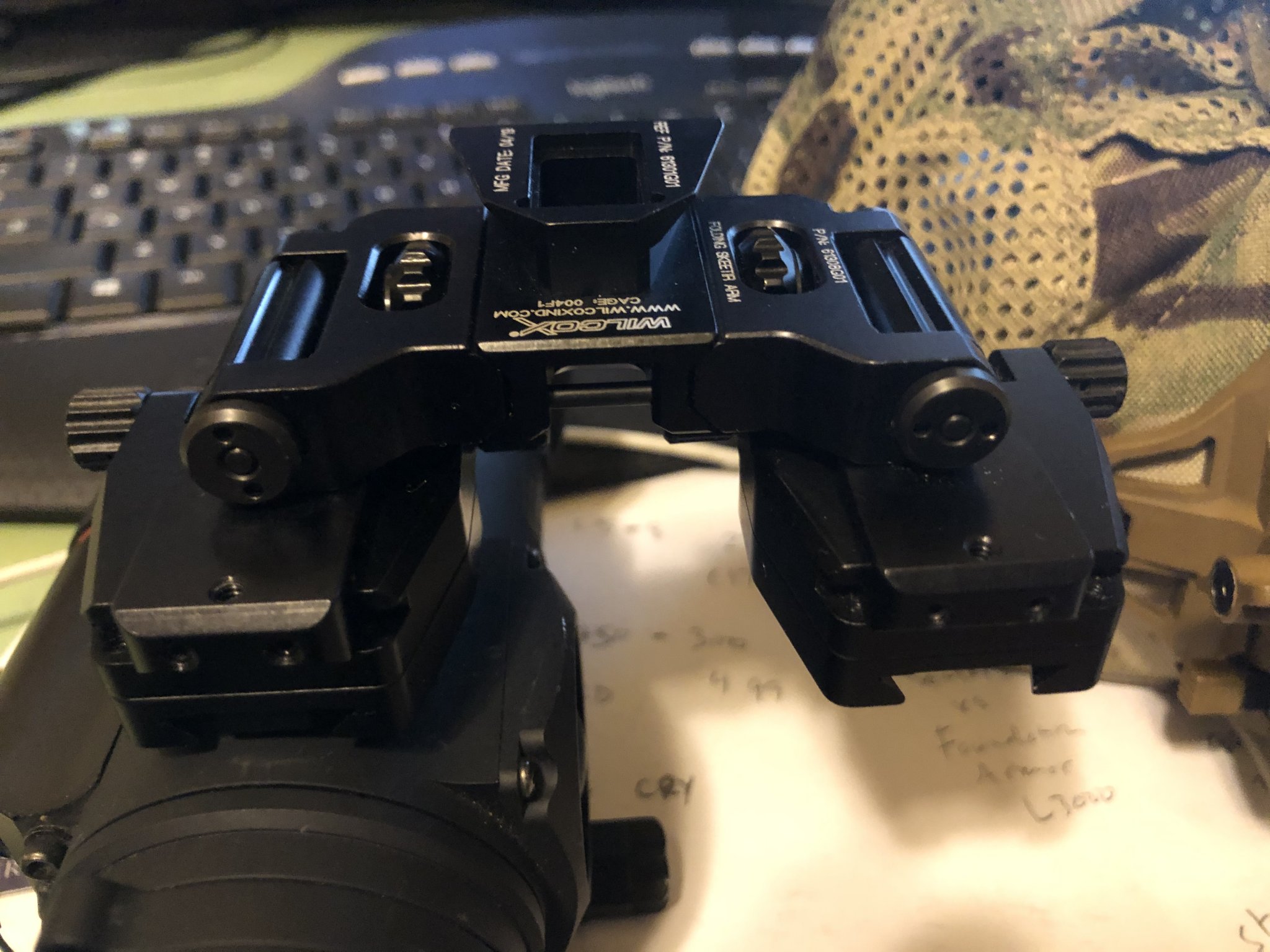

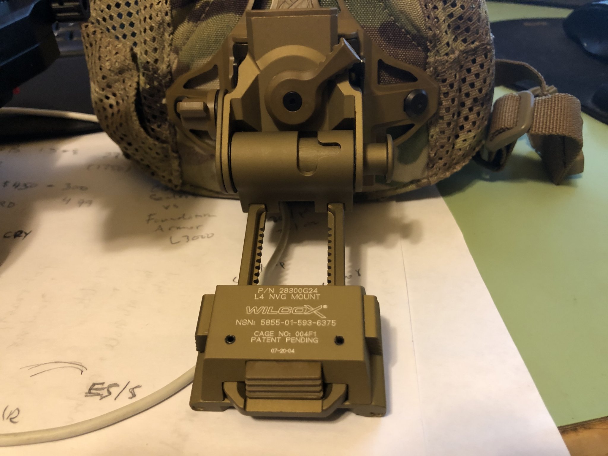

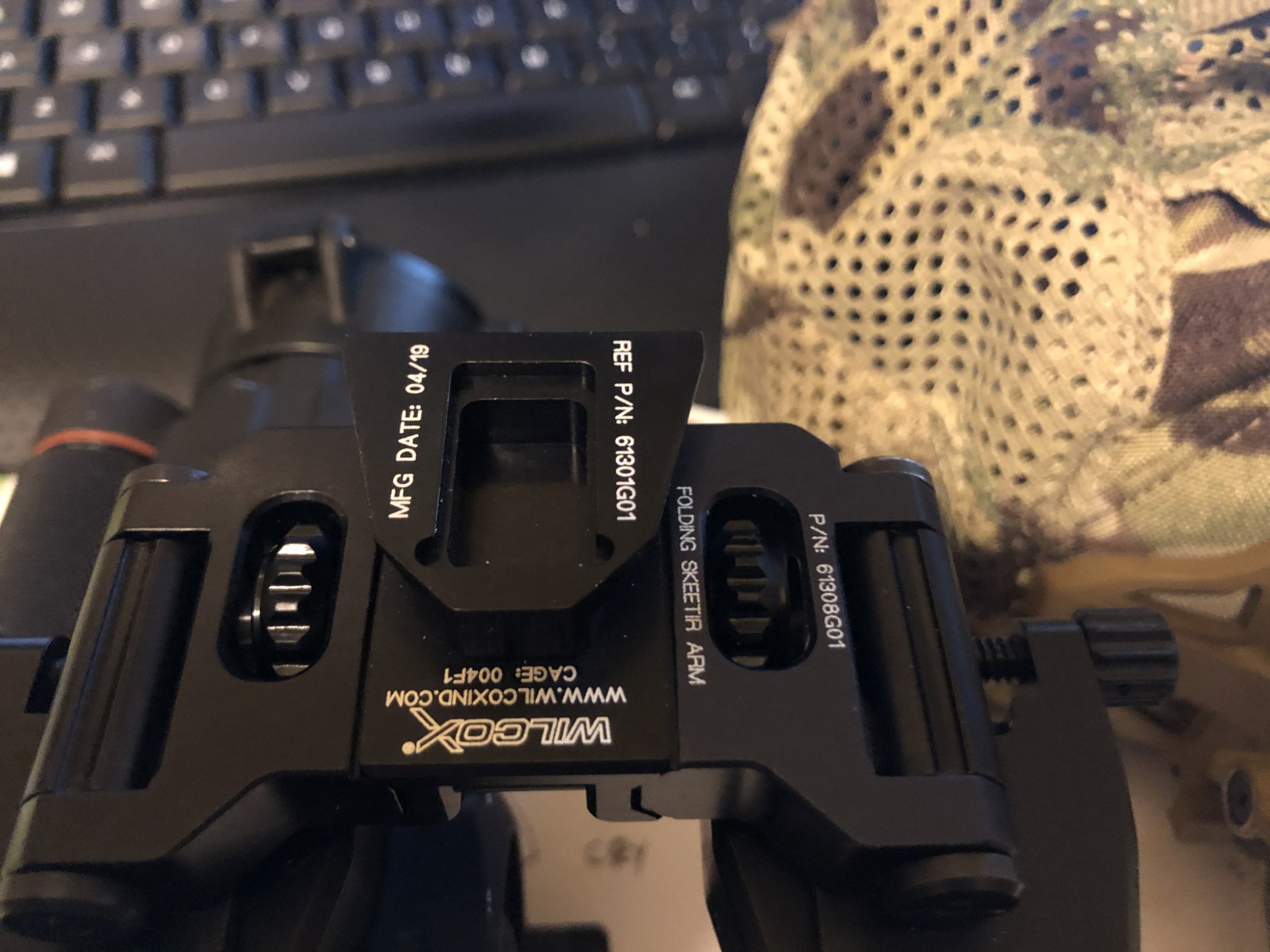

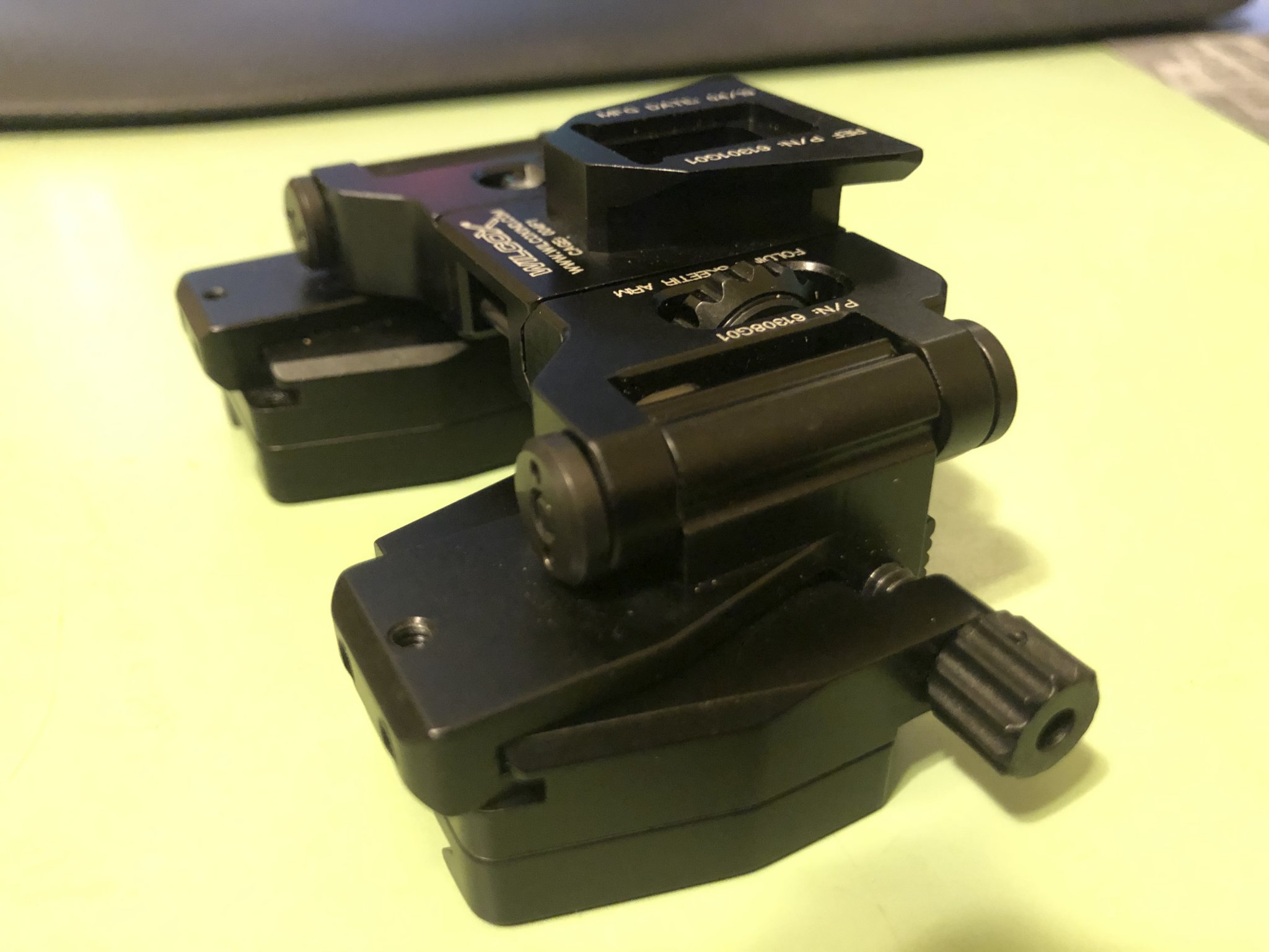

Thanks for the help guys. I’ve waited to get a helmet to make sure the night cap wasn’t the problem and after experimenting with it it seems the beige may be a bigger problem than the mount. Through my research from your recommendations it appears that most bridges don’t have the adapter set so far back on the bridge. I believe that this may be causing my issues. All this complicated for sure by trying to use a Reap instead of a more viable option.
Interested to hear your guys thoughts. Ultimately I don’t really care if the Reap experiment fails I just want to make sure I’m not in a bad spot when I get a 14 and a nox.
