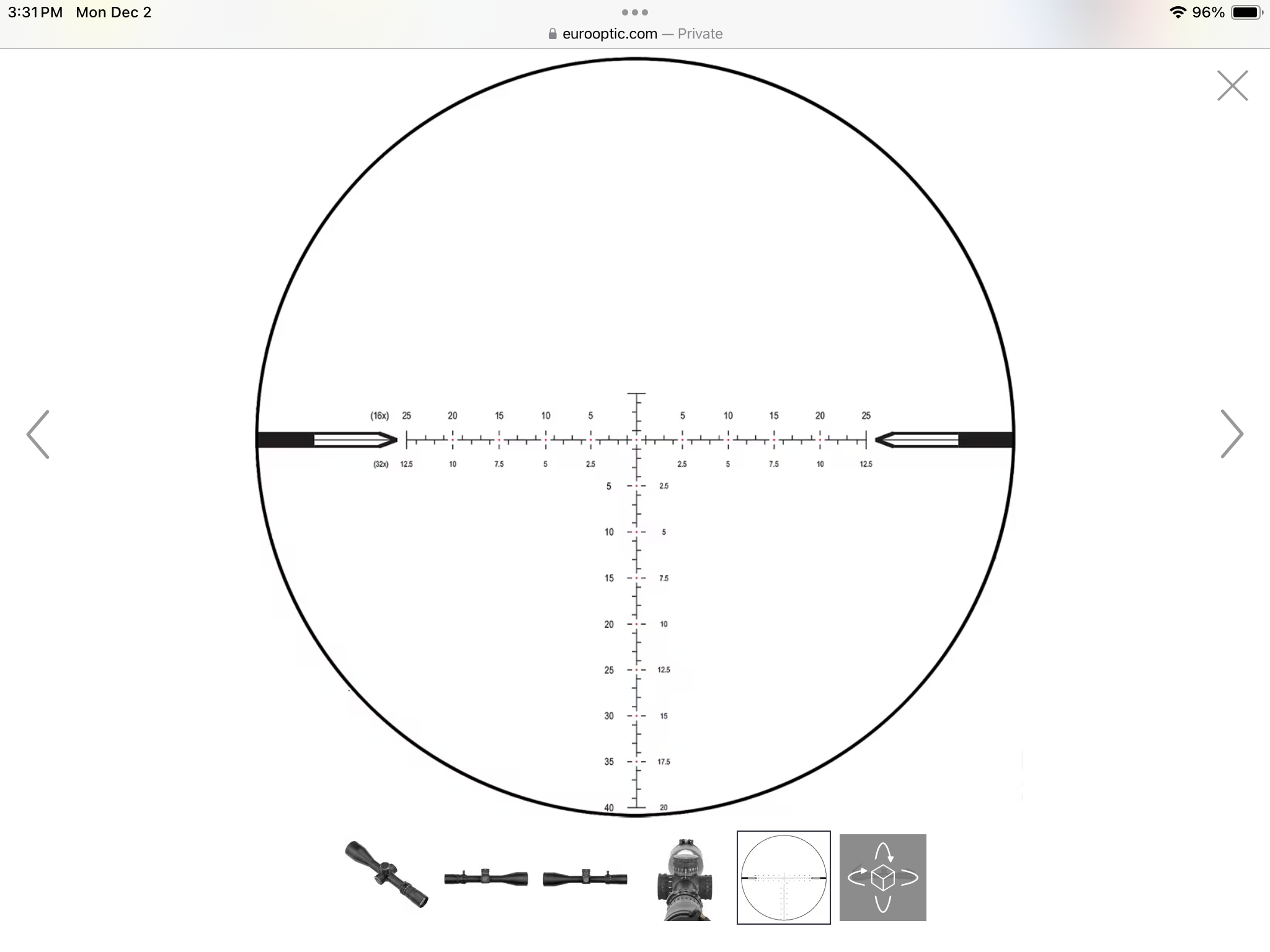

I hear you. I mainly hunt. I think the SFP reticle is better for hunting. FFP is not great on low magnification or dark backgrounds. If I shot PRS I would definitely get FFP. I’m good at the math for MOA holds at various magnifications. The Nightforce 4-32 MOAR CF2D SFP reticle indicates subtensions at both 32X and 16X. On 32X it resolves to 1/2 MOA tic marks. That’s pretty cool making holdovers even less of a guess.
