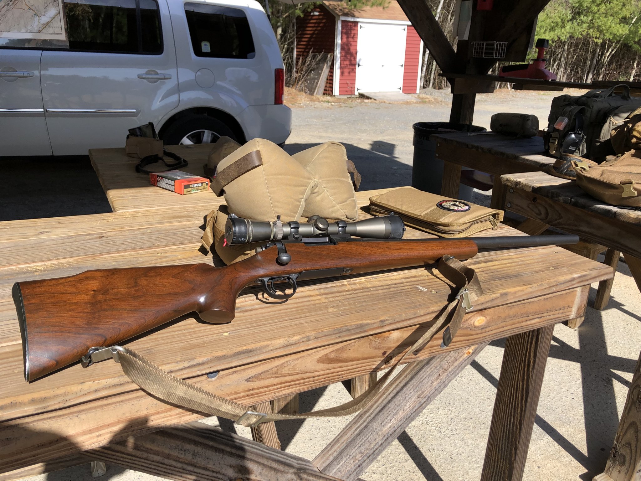

There’s something wrong with your scope friend. It looks sick.
It’s all green…
Reactions: pmclaine

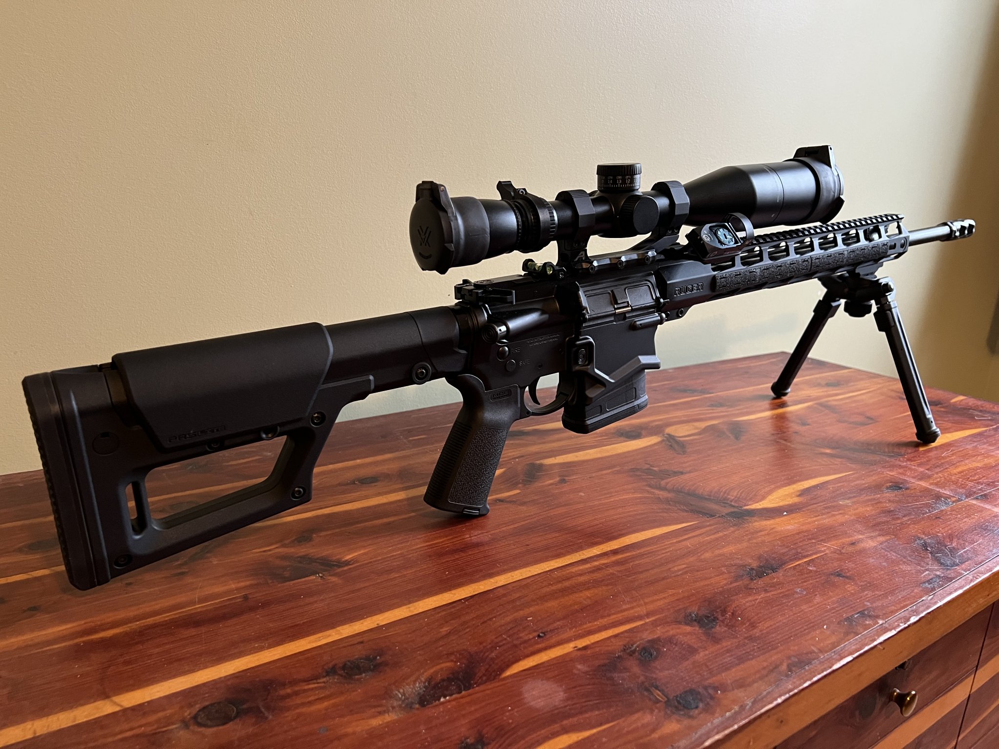

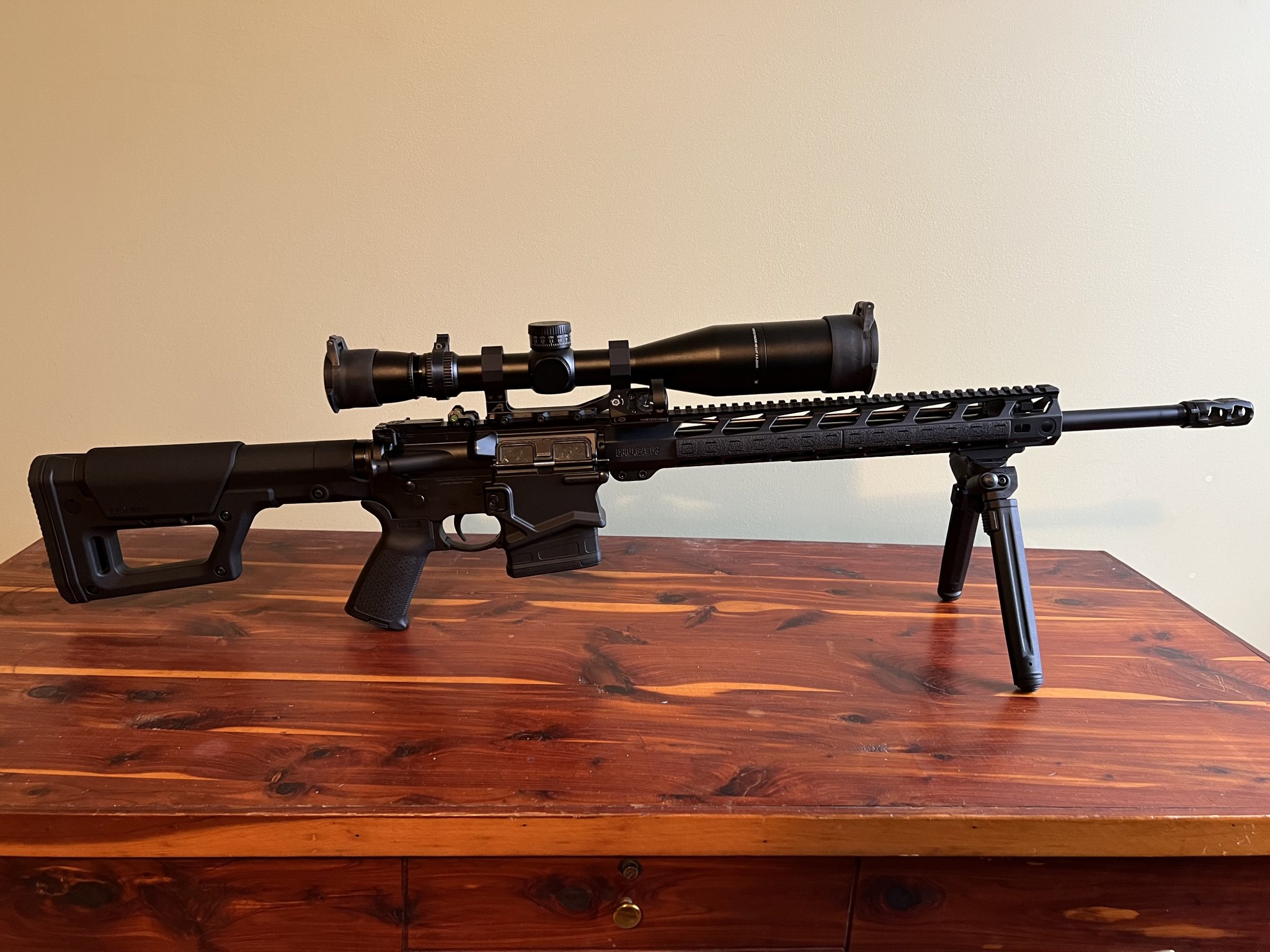

I opted for a Razor LHT 4.5-22 and so far it has been great for my 20” SFAR. Got this to be a lightweight semi-auto long range hunting rig and so far its proving to be just what the doctor ordered.
