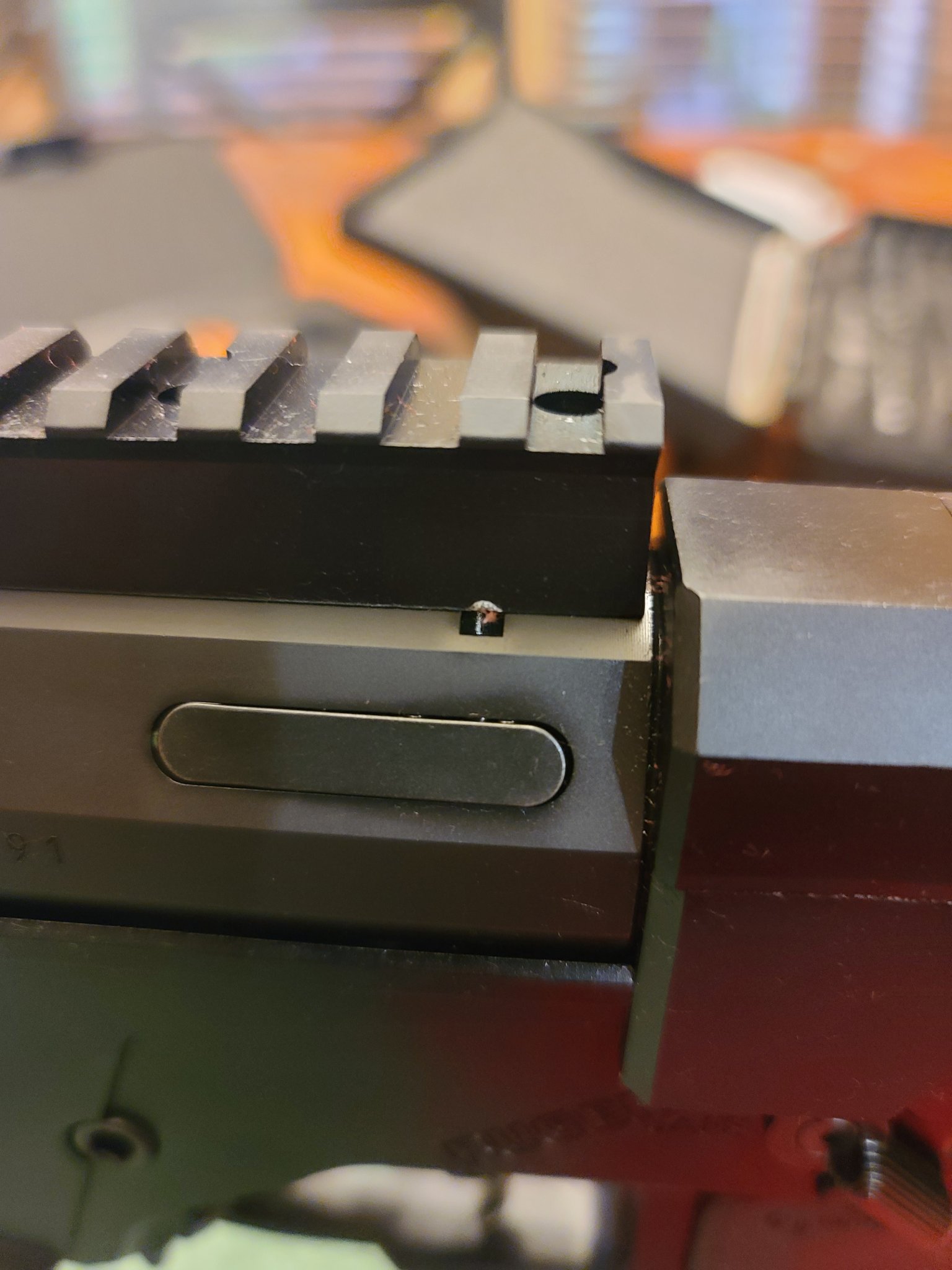

I just purchased a Ruger Precision Rifle in 338 LM and during my initial cleaning, I noticed that the rear of my scope rail was not exactly level but the front part is. It's not a drastic difference but it struck me as odd. While researching all the options and upgrades available, I came across the Anarchy Outdoors rail with built in bubble level. I figured it would be an easy swap for peace of mind. Plus with the built in level, it was a nice add on. It is only available in 0, 40, and 60 MOA and since the rifle comes with a 30 MOA cant already, my lack of knowledge assumed it would still work. As I learn more, I am concerned that I won't be able to zero at 100 yards because of lack of elevation adjustment at that angle. I'm not confident in the math to know for sure so I figured I would ask for input.
I will be running a Vortex Viper PST Gen 2- 5x25x50 with an advertised elevation adjustment of 70 MOA. It will be mounted on a set of Seekins Precision 1.26" high rings. Can anyone tell me if this will work within the usable elevation adjustment for a 100 yard zero? I ordered the rail before confirming but it hasn't shipped yet. I will be picking up the scope this week so I figured I would slow down for a second to make sure I am doing the right thing. Thanks in advance!
*Generally* the rule of thumb is to take half the total travel of the scope so 70/2 = 35 moa max inclination with still being able to safely zero at 100... So 40 moa probably is going to be a tad much for that scope
Reactions: Sig Marine
Thanks for the reply. I'm not sure that I will need to shoot at 100 yards often but it would be nice to have that option. I guess my options are to keep the stock rail or look for a different scope that has more adjustment.
So when you say that the stock rail doesn't look level what does that mean exactly ?
Because a canted rail is taller towards the shooter and shorter towards the muzzle end is this what you are seeing?
The left to right was slightly off at the back of the rail but the front was perfectly level. It was still within the bars on the bubble level but not dead center like in the front.
Can you remove the rail? It sounds like it wasnt seated squarly before torquing everything down.
Yeah, I originally planned on doing that but saw the new rail with built in level and thought I would just replace it. I will pull it and try to reinstall it. It was definitely odd and even with the slight difference, I didn't want to chance it.

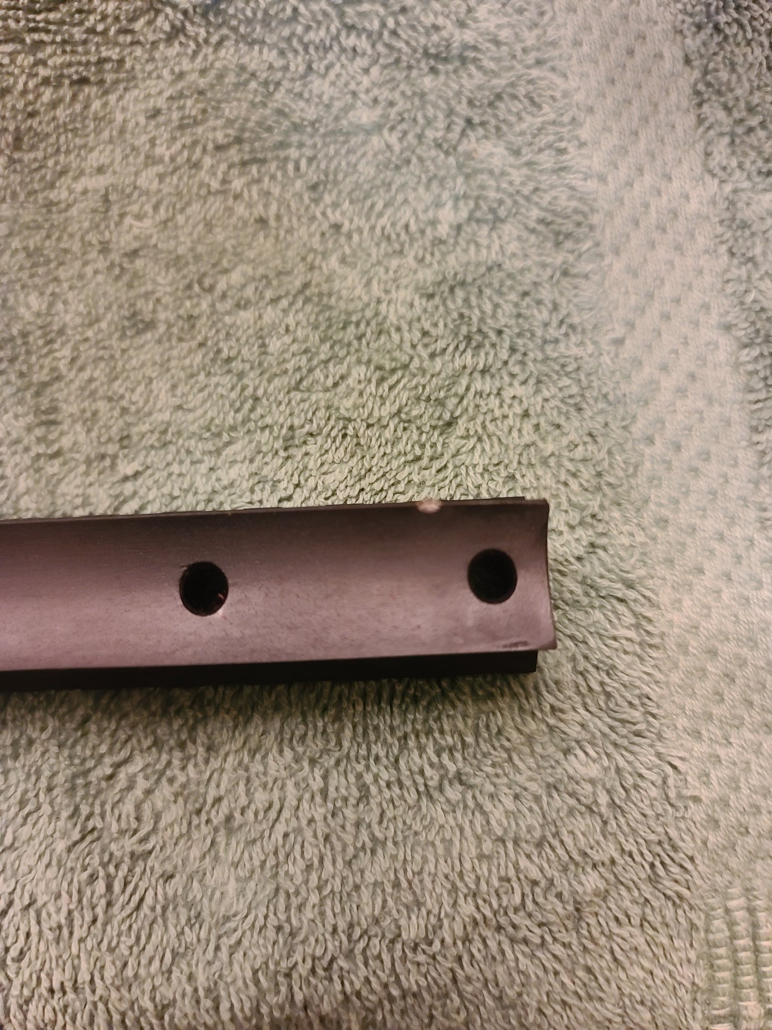

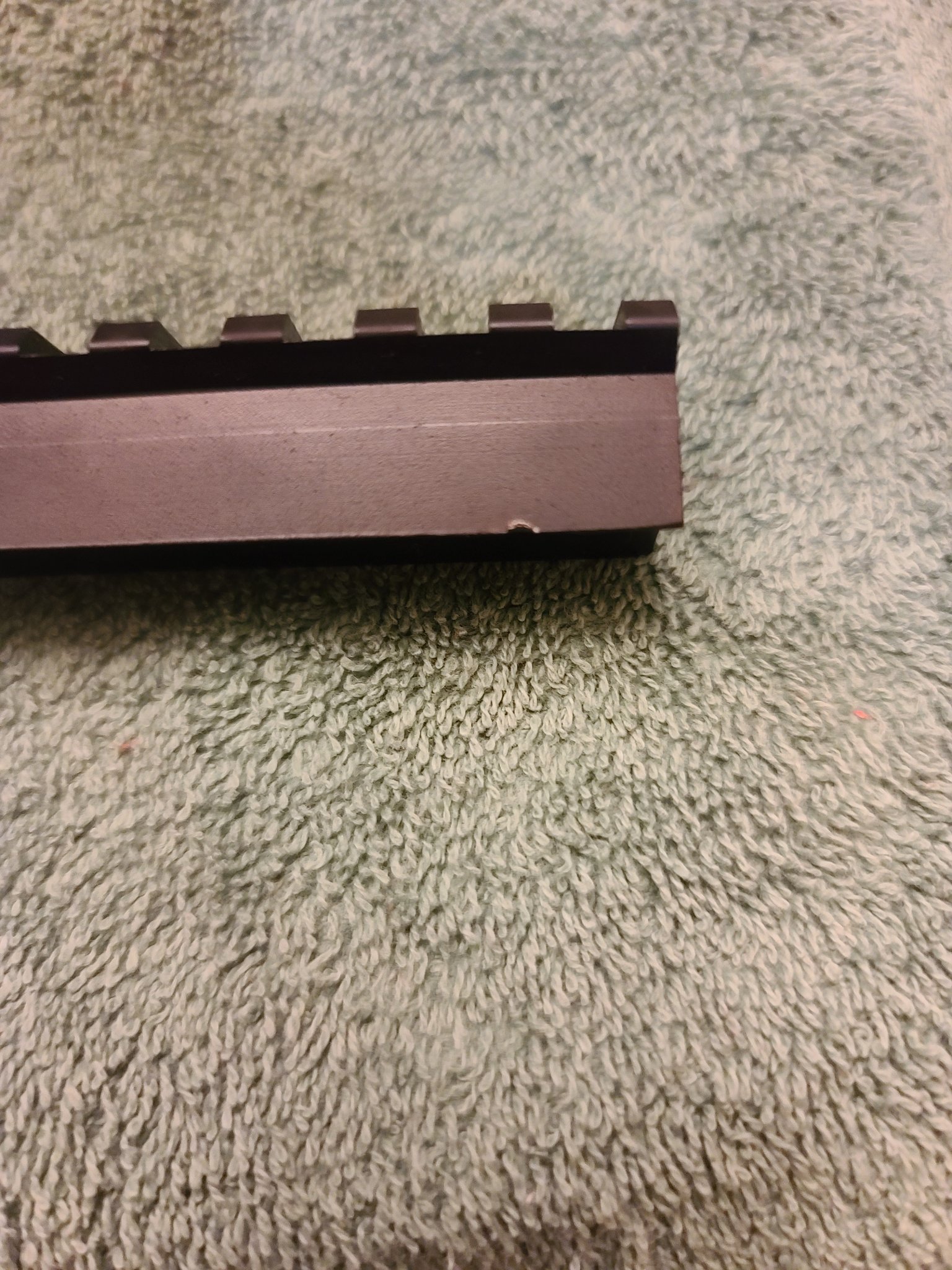

I ended up pulling the rail and the mount holes appear to be fine. I did find a gash in the bottom of the rail right at the location where the pin holding the bolt release is on the receiver. It was likely done when the rifle was assembled so it must have tweaked the rail just enough to make it slightly offset. The good news is that it should be an easier fix and not require sending the rifle to Ruger. I just need to find a new rail.
Good catch, you might have saved yourself all kinds of pfm scope problems. Grind or file the ding down below flush from the bottom and you'll be gtg.
I'll bet if you contact Ruger they'll send you a replacement. The factory rail should work well with your scope. If you switch to another with more travel, a one piece mount with 20 moa built in will let you use more of it.
