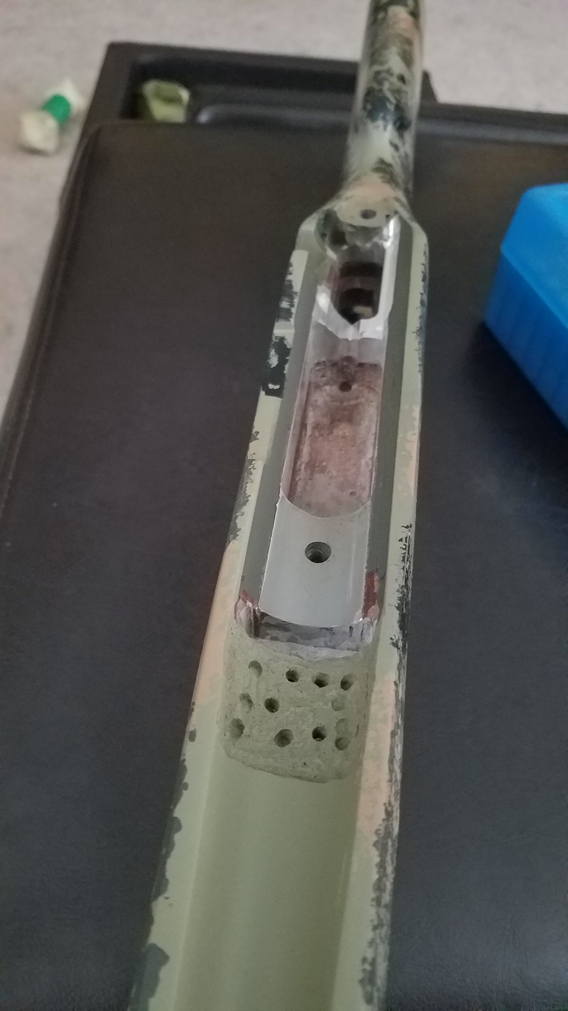

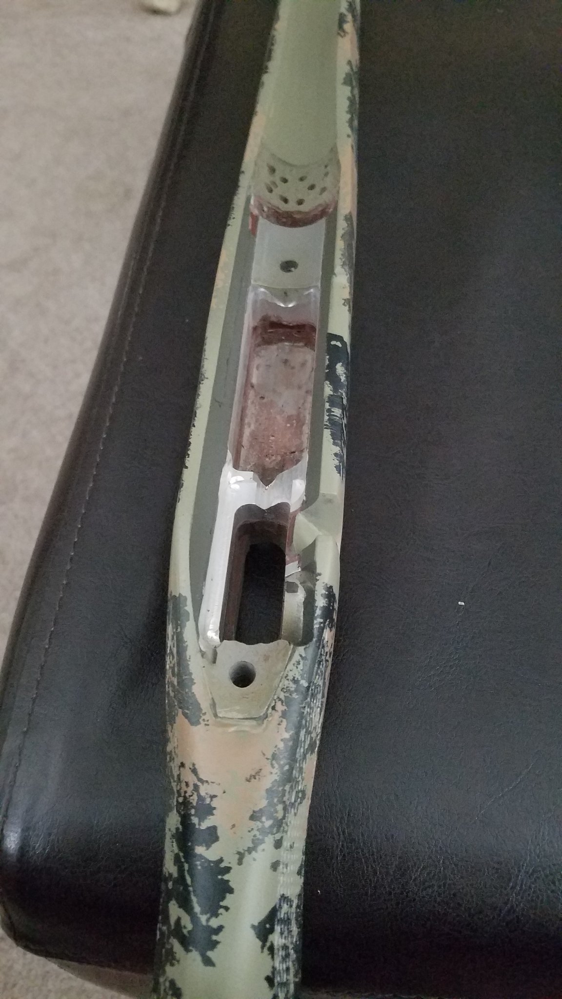

I suppose I should be more clear about what I’m doing. I’m pulling the stock to clean rust on an old rifle and then putting it back on. Will it still change much? I will obviously confirm, but if I don’t have chance to, I don’t want anything unexpected.

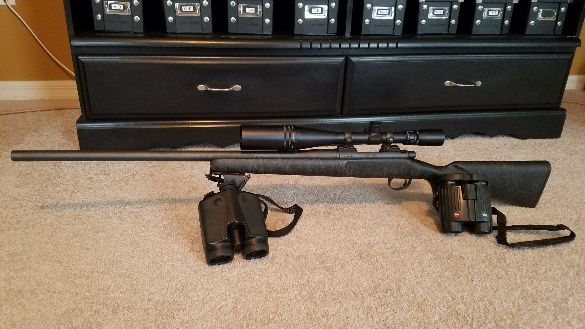

Rifle is a R700 varmint synthetic circa 1995.
Like this one?
All circa '95 stuff and it all still works.

Here's an old, really old H-S Fiberthane stock with the basic block.
The block on current stocks (92-ish to today) goes from the wrist all the way to the forward sling stud.
Previous owner bedded it for whatever reason.
I removed some of it around the recoil lug and gave it a sponge bath paint job.

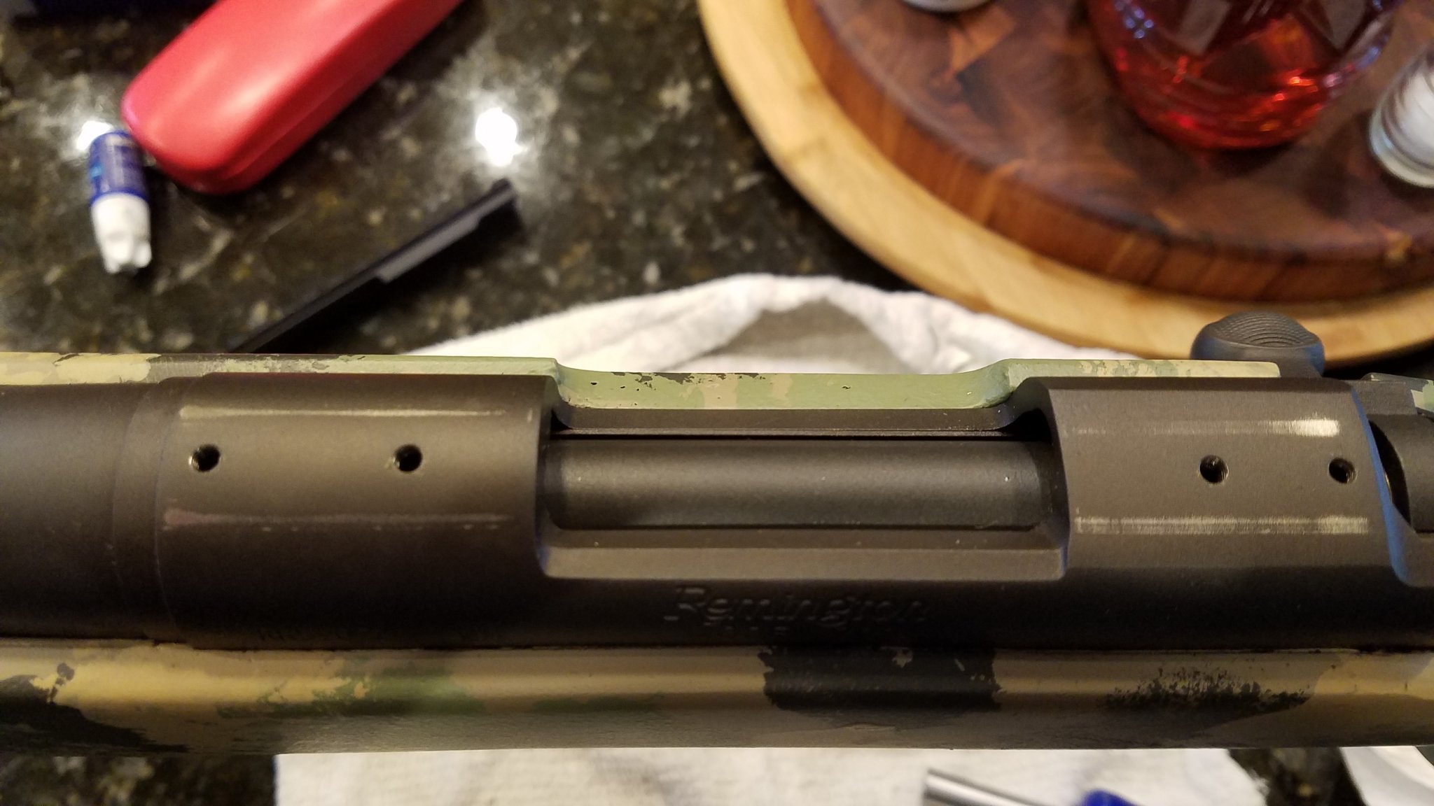

Torqued to these specs and it doesn’t feel like much. I guess I’m a little heavy handed on other things, but it feels like it should be heavier in the rear?
If the torque doesn't feel like it's much, I'll lay a bet that the screws and or the action threads have some type of lubricant on them.
65 in lb is for dry threads.
A 1/4×28 bolt has a nominal torque value of 50-70 in lbs dry.
With any lubricant applied, 40 in lb will do.
65 in lb is only 5 lb ft. Not much and you can do it with a screwdriver.
I called HS directly. They recommended 65 front and rear with the front being torqued first obviously. I have it set in and I’ll check zero Monday. I can’t imagine that it changes too much.
