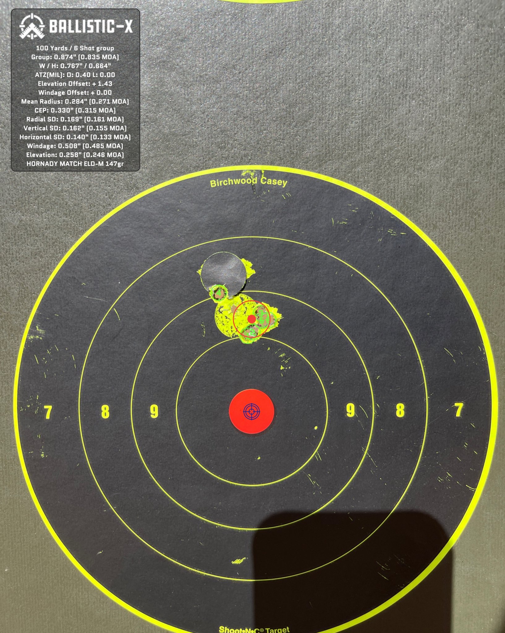

My rifle has a 20 MOA base. With a new scope I ran the adjustment all the way Down to the bottom. Came up 10mil from the bottom. On a 100yd range when firing to zero I needed another .6mil UP. Rounds impacting where I want them. Done. Yes, I'll still be fine tuning the adjustments but now it's adjusting .1 MIL here or there.
I'm not sure why anyone would tell you can't zero at 100M with your setup. All you need to do is know the ballistics for your round at 100M for whatever range you want to have as your true zero.
I.E.: If your round ballistics show 2" high @100M for a dead 0" @300M then shoot using a POA (Point of Aim) on your 100M target dead center. Just adjust your scope to bring your impacts up 2". Sure, you would want to verify this on a true 300M target.
I want to say it was told to me: "The shooter generally wants to shoot longer distances, not shorter distances after you have Zeroed the scope/rifle. Why are you not setting up the scope to give you the most adjustable travel UP. Cause it's rare when you need to adjust Down."
This is my 100yd ZERO. I hold the scope reticle center on the red dot (3/4" in diameter). As long as my rounds are impact at 1+" high, maybe 2+"high, I'm happy cause that's telling me I should be stacking rounds on top the red dot at 200yds (more like 225-250 yds depending on ballistics). Yes, I need a longer target range to verify.
