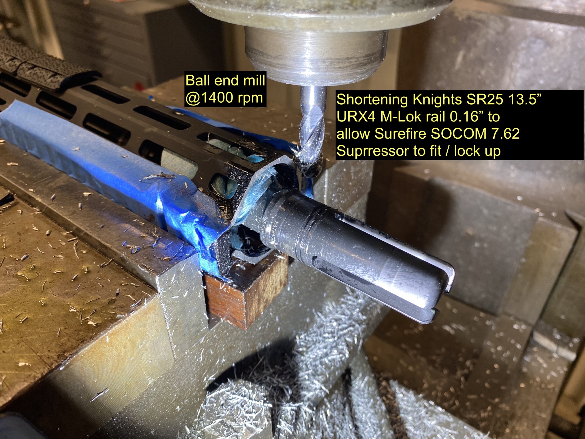

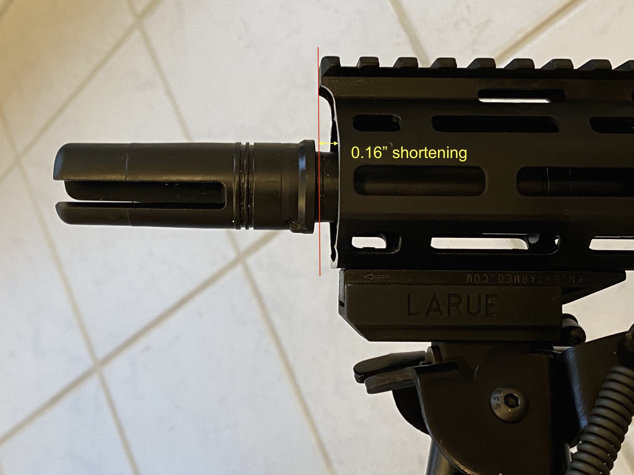

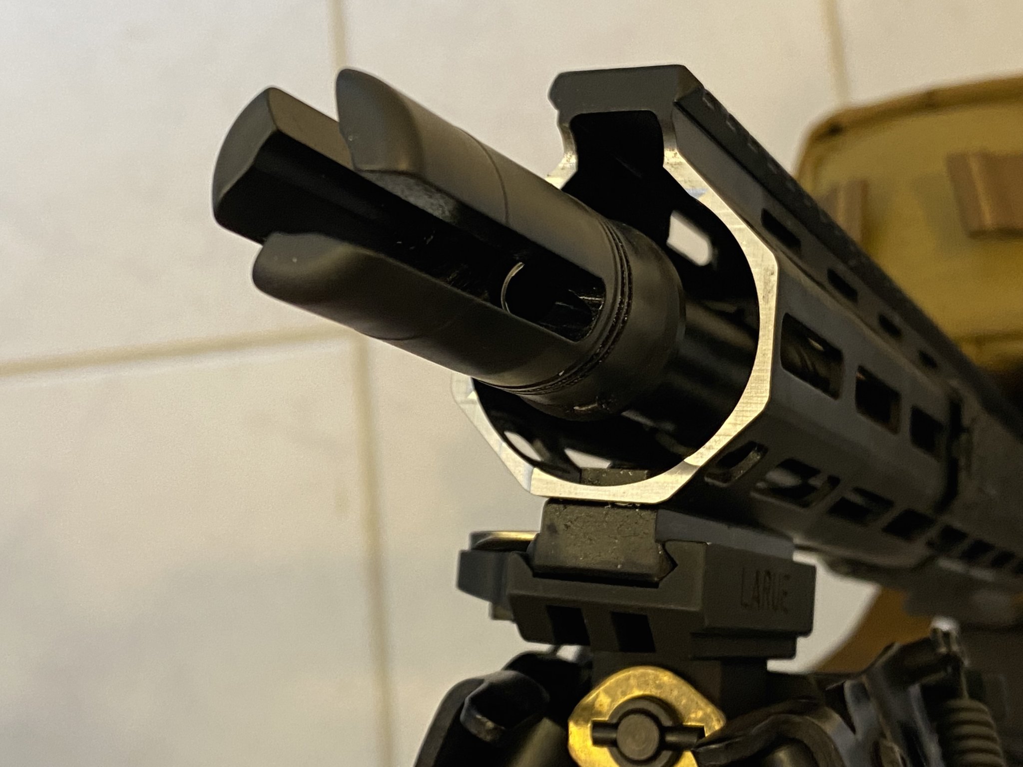

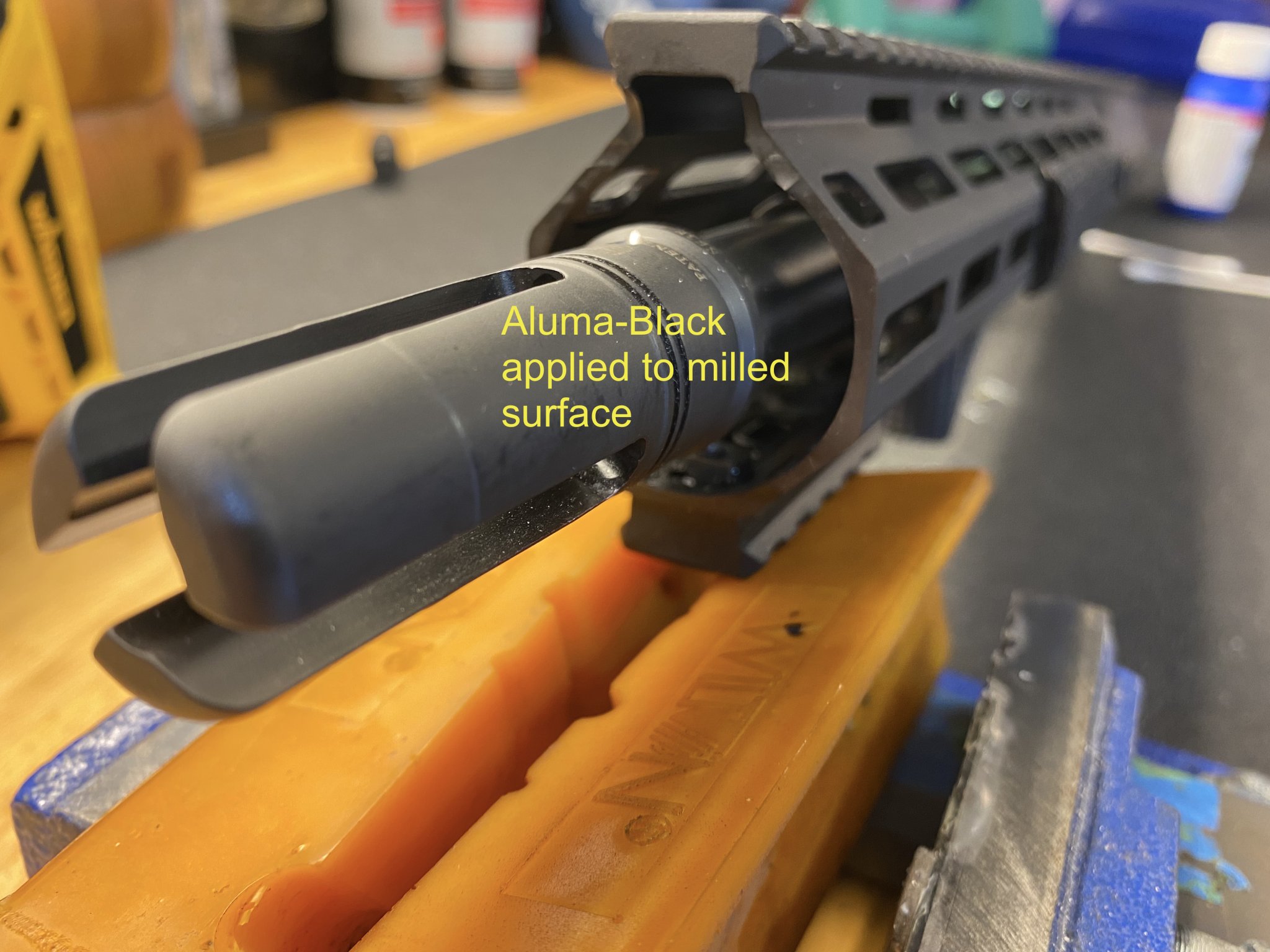

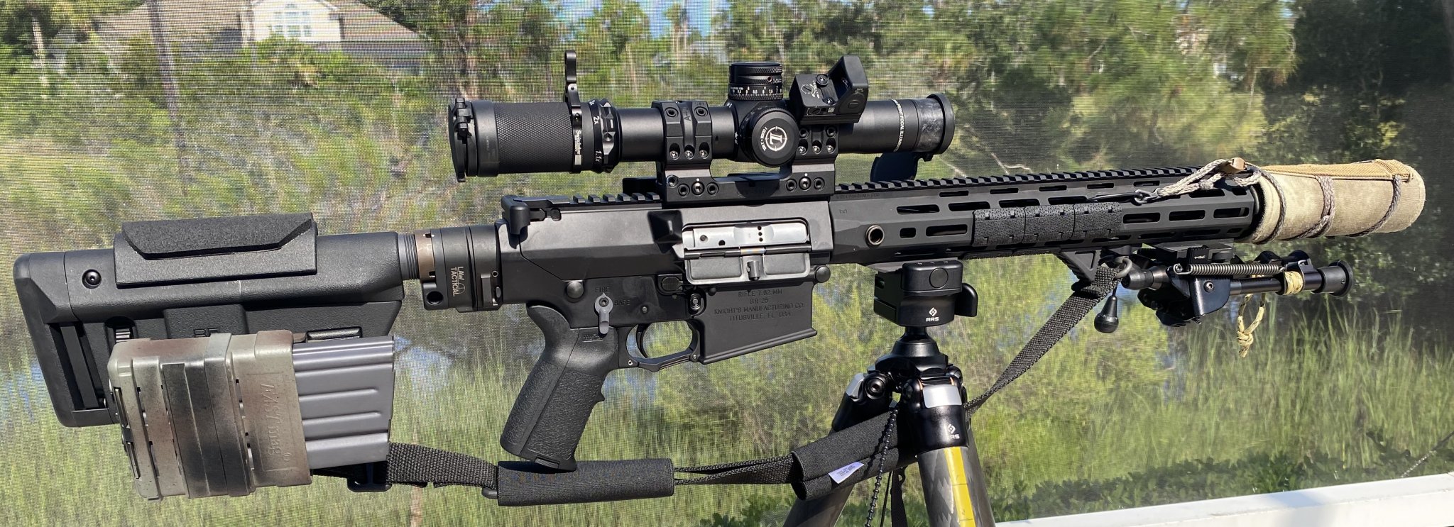

My SR-25 ACC 14.5" came with the 13.5" URX4 Mlok which was ~0.2" too long to allow using a Surefire SOCOM2 and have its
ratcheting collar lock fully engaged, as the collar moves rearward when loosening it. I milled off just enough for a proper fit. I speculate that
the 13" variant was mfg. for this common fitment problem.
IMG_9808KAC SR-25 SureFire SOCOM Fitting to URX4 Rail Modification 07.05.21 copy.jpg
IMG_9813KAC SR-25 SureFire SOCOM Fitting to URX4 Rail Modification 07.05.21 copy.jpg
IMG_9814KAC SR-25 SureFire SOCOM Fitting to URX4 Rail Modification 07.05.21 copy.jpg
IMG_9832KAC SR-25 SureFire SOCOM Fitting to URX4 Rail Modification ALUMA-BLACK 07.06.21 copy.jpg

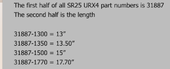

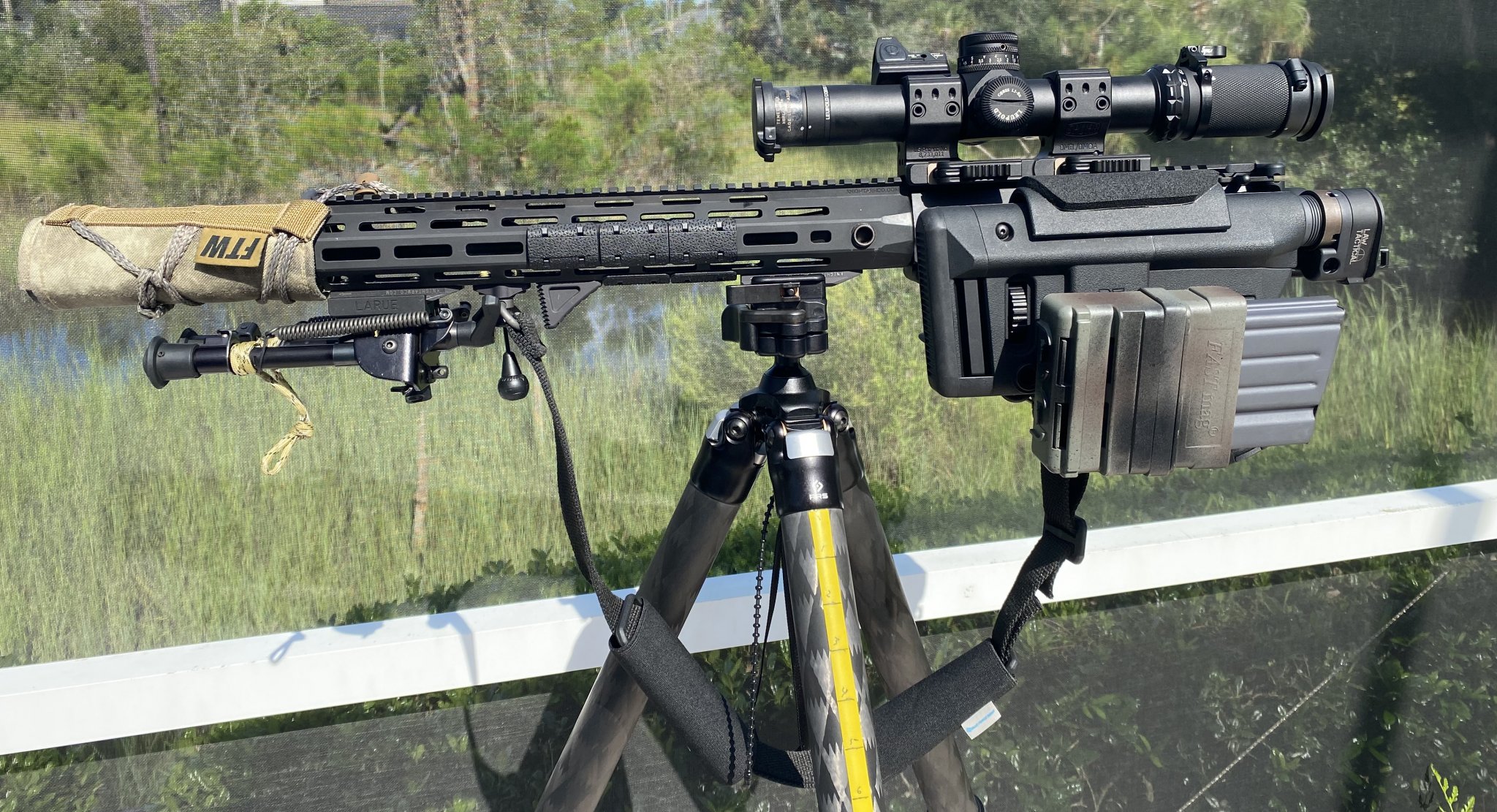

IMG_0181KAC SR-25 WITH SUPPRESSOR BLACK SCOPE & SLING RMR MOUNTED POOLSIDE 07.30.21 CROPPED copy.jpg
IMG_0167KAC SR-25 WITH SUPPRESSOR BLACK SCOPE & SLING RMR MOUNTED POOLSIDE 07.30.21 CROPPED copy.jpg
Nice millwork but I’ll wait.
