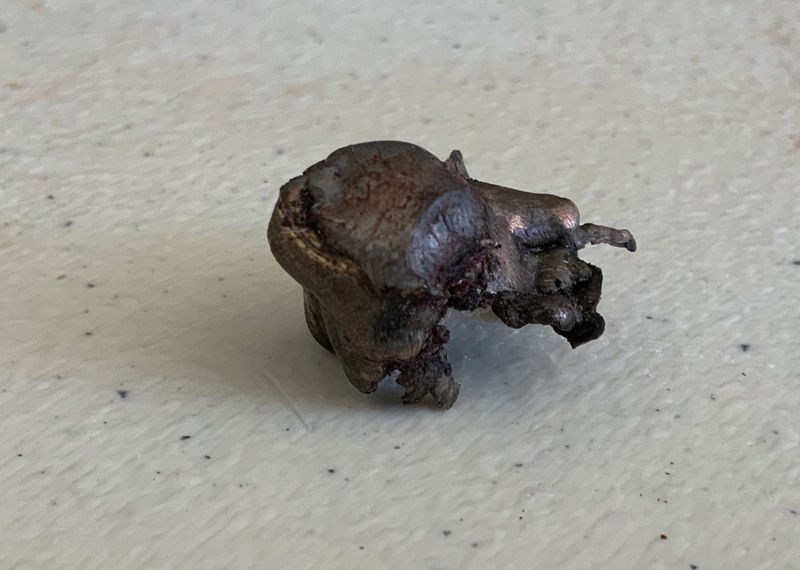

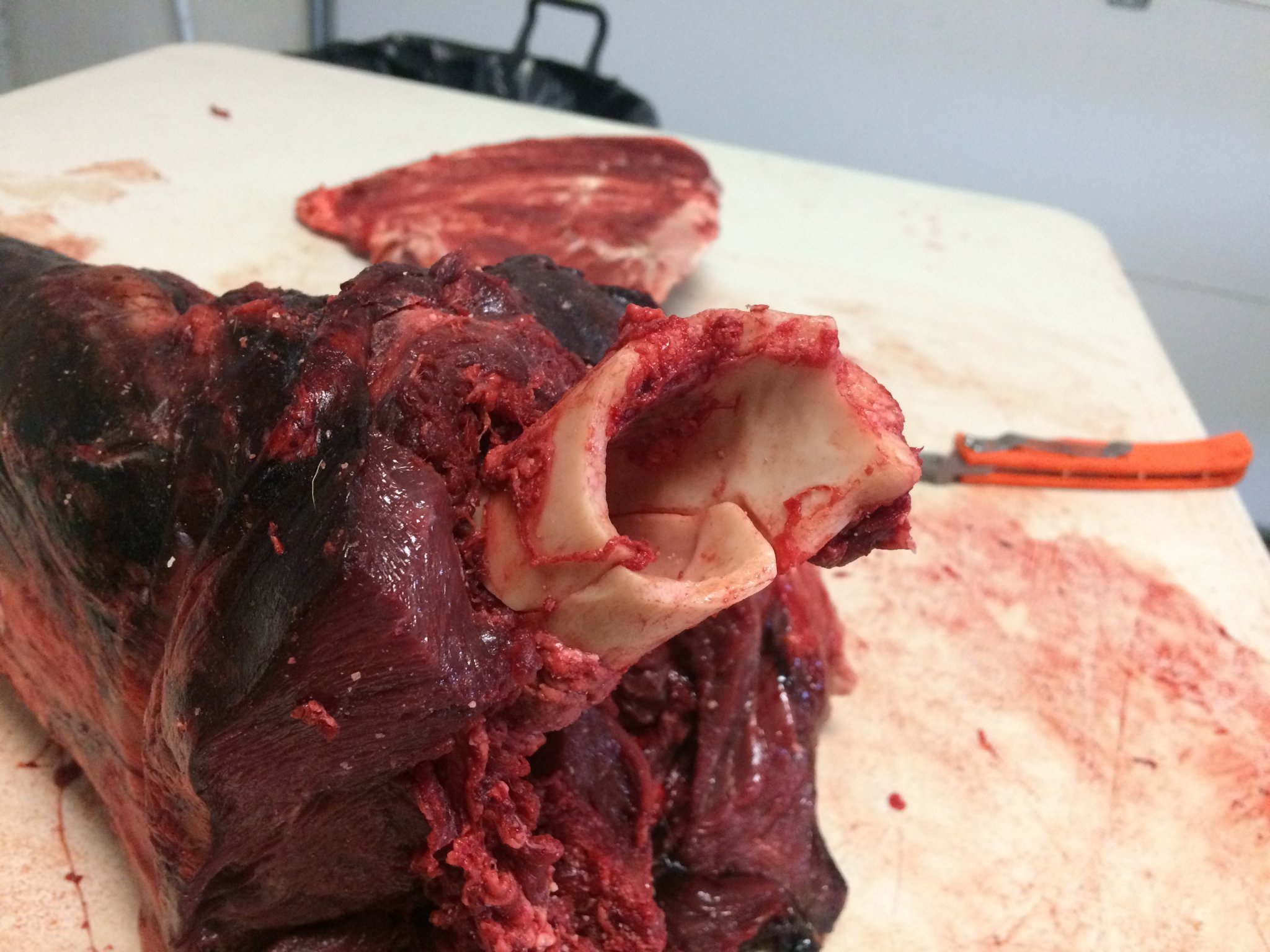

I shot this cow (so a bit bigger than your whitetail) a few years ago, 7mm Rem Mag at 375 yards.
The 162 ELDX centerpunched the humerus just below the shoulder knuckle (a big bone), traversed the ribcage hitting ribs on both sides, and lodged under the hide.
I don’t recall the final bullet weight but it didn’t separate.
She died before I could count to 10.
