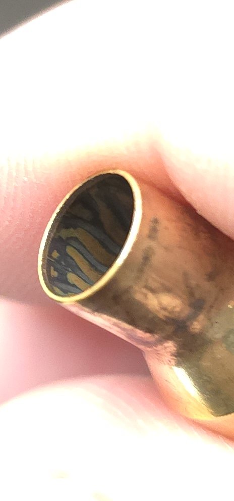

Will this brass still make accurate ammo
JRBullock1987
Sep 8, 2023
227
47
Washington
11 firings.
Alpha munitions 6.5cm OCD LRP brass
Ive Annealed every firing. Now theres these wonky ridges on the insides of the necks and can feel them slightly on the outside but theyre not as pronounced as the insides are. When I resize I always full length size using the sac die with the expander mandrel inside so its all in one step. Does anyone know what causes this? And how to avoid this in the future? My other lots of brass dont have them at 5 and 4 firings.
That pic was taken after firing and annealing, I haven't resized them yet. I'll resize a couple and send a picture in and see if anybody can tell if it's smoothing those wrinkles out or not. I'm using the .286 bushing with the .2625 expander, mandrel. my neck thickness is about .145"

Yeah my suppressor really coats the outside so it takes forever to dry tumble the outside clean. By then the inside is clean. Sucks cause id like to keep some residue on the inside of the necks
you have to brush the inside to remove the scale or what ever it is from annealing them. What you are seeing is the brass is galling inside the neck.
That's what I thought when I saw that for the first time and thinking I should also see something like that on the bearing surfaces of pulled bullets. So I pulled some bullets to take a look; bearing surfaces were as smooth as they were before seating with no signs of galling or scrapes. If there's brass partials, like what might come off a chamfer from a dull cutting tool, that galls the inside of the neck that's brass, they'd surely do the same to the softer surface of a bullet. Huh?

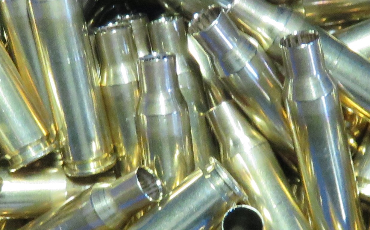

What’s your dry tumbling process? I use Flitz in my walnut media, and if I saw what you’re seeing, I’d tumble a few test pieces for a longer period of time and see if that removed it.
If it did, I’d do the whole batch that way, with the expectation that I’d have to rechamfer the necks after.
11 firings.
Given how much residue is still on the outside of the case I also think they’re just not getting cleaned well. My walnut tumbler with fitz give me very clean and shiny brass (left)
