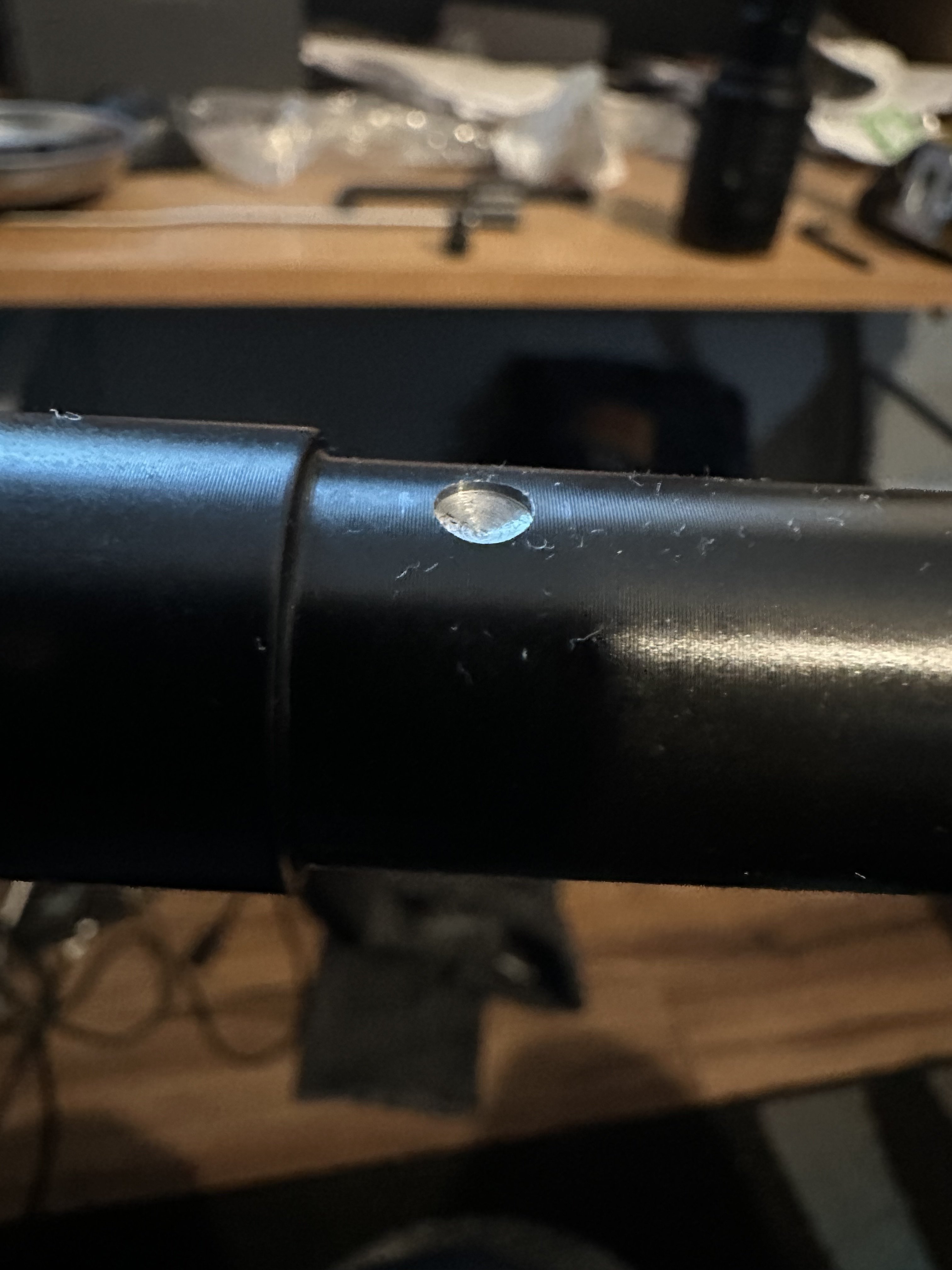

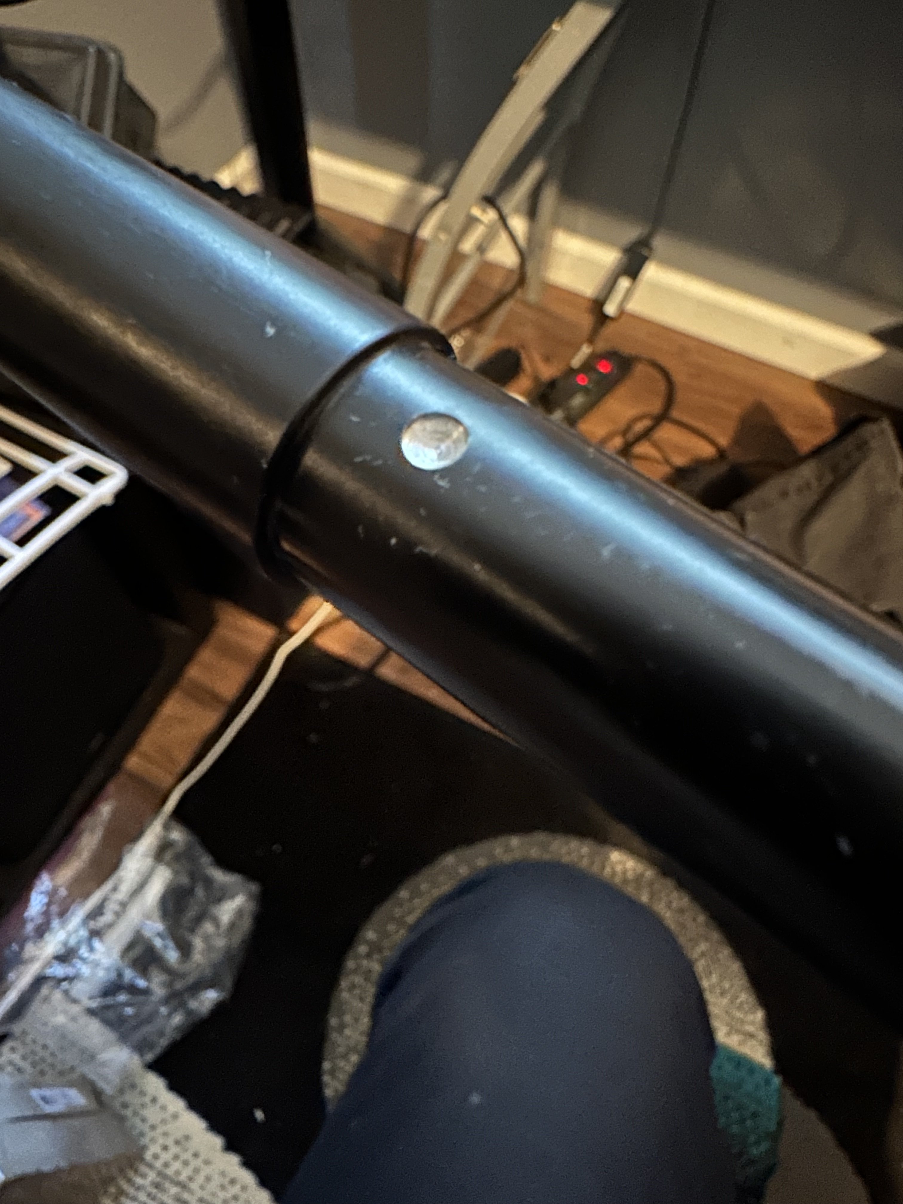

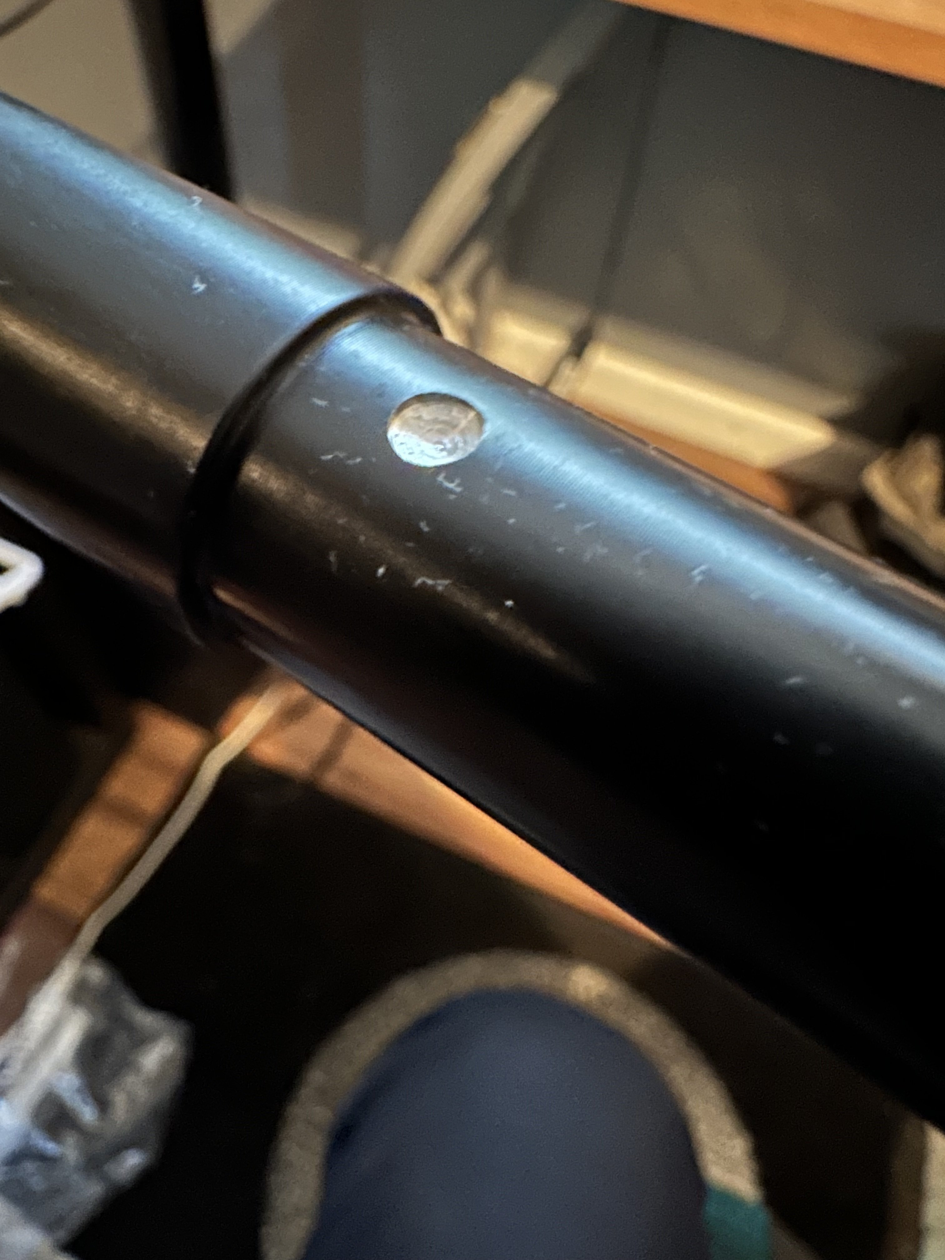

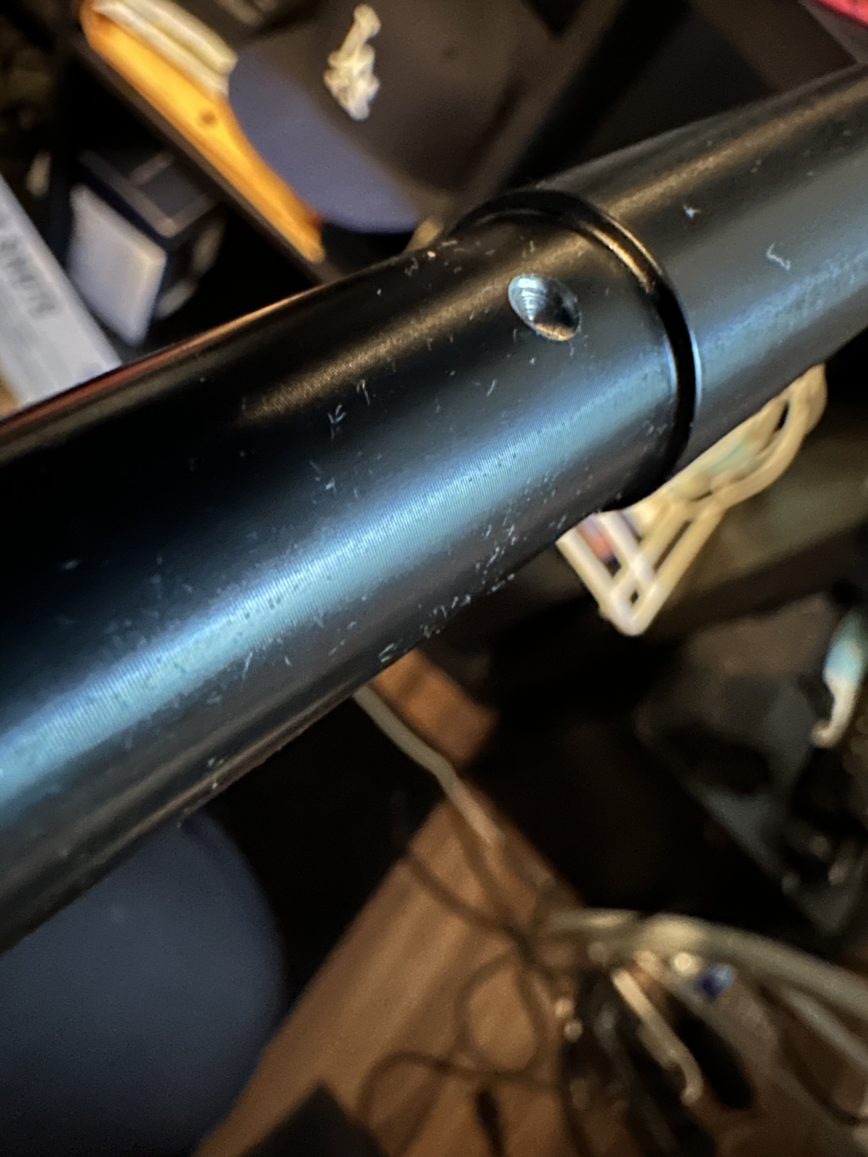

M Msnipe Private Minuteman Mar 5, 2025 1 0 Usa May 24, 2025 #1 May 24, 2025 #1 I think I may have dimpled this a little to deep and wanted to know if anyone thought it might have affect on accuracy. This is a ballistic advantage spr profile 416 nitride barrel. Attachments IMG_7295.jpeg 1.1 MB · Views: 50 IMG_7294.jpeg 761.5 KB · Views: 51 IMG_7293.jpeg 1.1 MB · Views: 51 IMG_7292.jpeg 1.2 MB · Views: 54
USK308 Sergeant of the Hide Full Member Minuteman Aug 4, 2021 250 251 Metro Denver, Colorado www.uskestrel.com May 26, 2025 #2 May 26, 2025 #2 No; your gas block will be set/aligned properly on the gas port using that dimple!!! Reactions: oldrifleman
TonyTheTiger Like a Boss Full Member Minuteman Feb 14, 2017 5,359 9,307 May 27, 2025 #3 May 27, 2025 #3 No. Reactions: matt33
6 610yd Private Minuteman May 1, 2025 38 29 NY Wednesday at 5:11 PM #4 Wednesday at 5:11 PM #4 Use a knurled set screw and don't crank it down too much.
