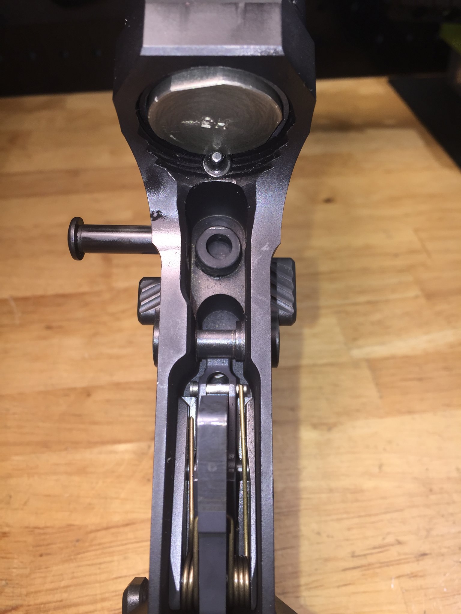

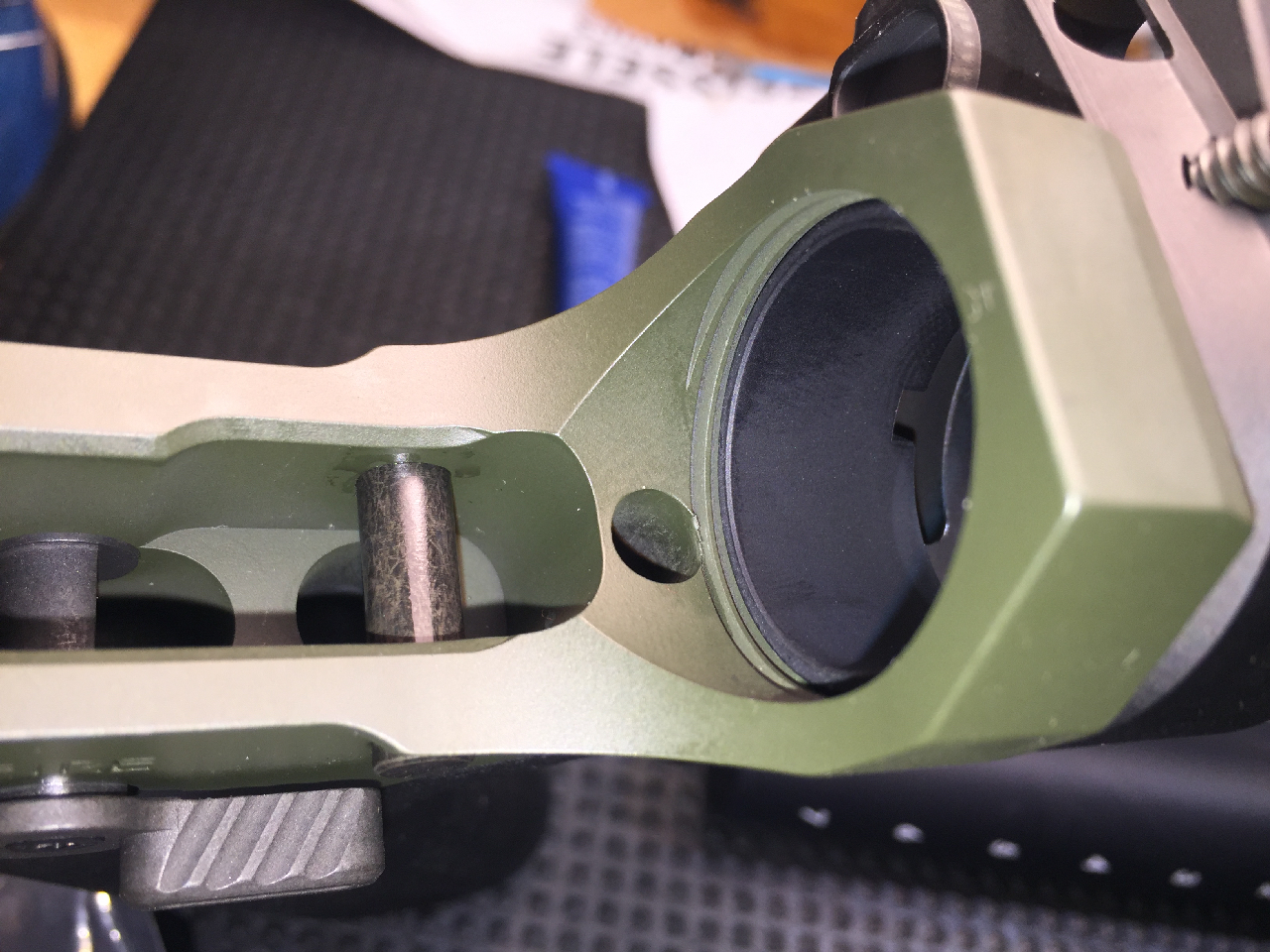

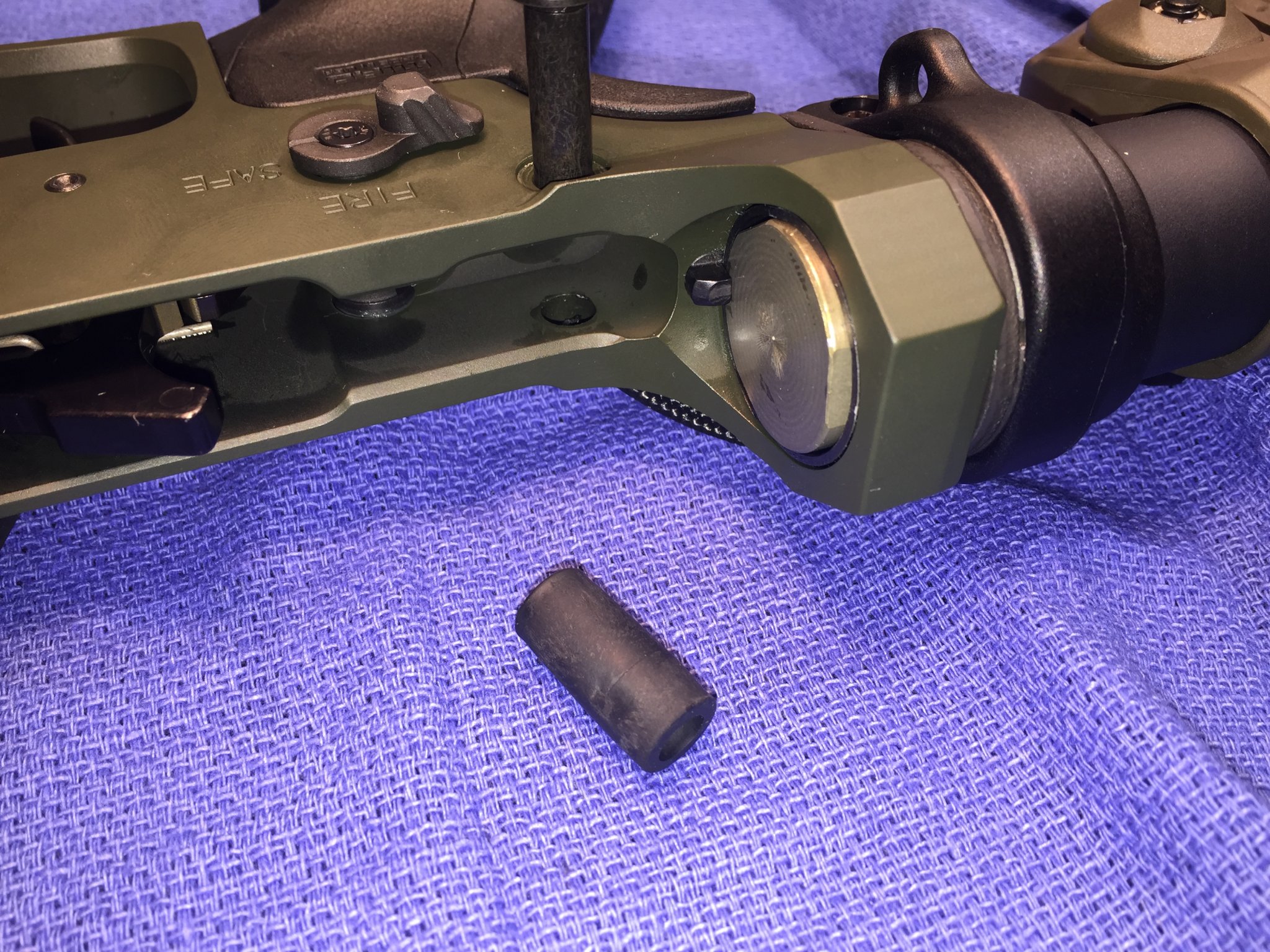

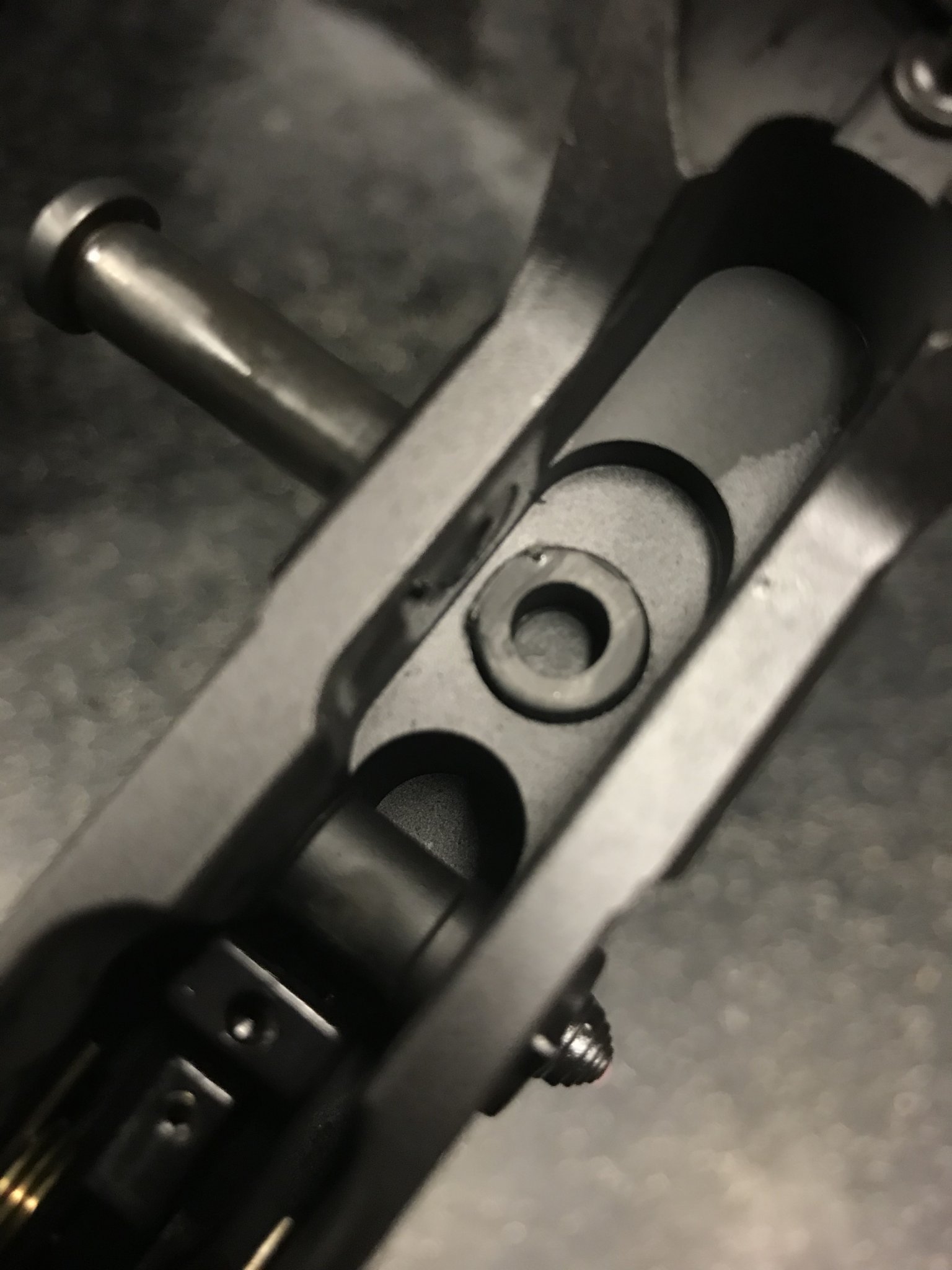

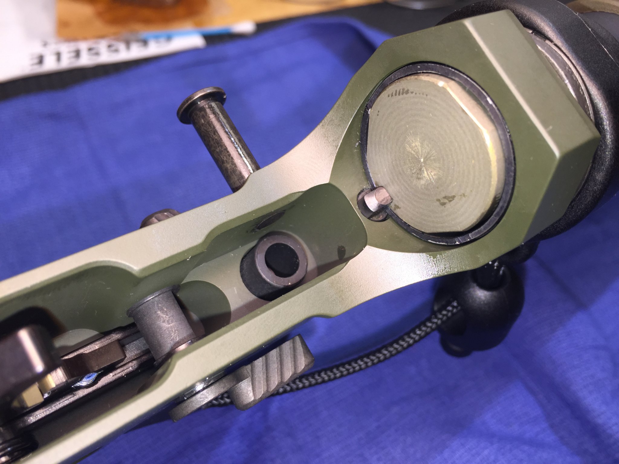

They simply insert into the usual recess site where a tension screw would be installed. The recess is not threaded 1/4-28 tpi, but is easy to do if one prefers to use a nylon screw.
This lower is a Wilson AR9 SBR.
This one in a Wilson 6.8 SPC II SBR.
