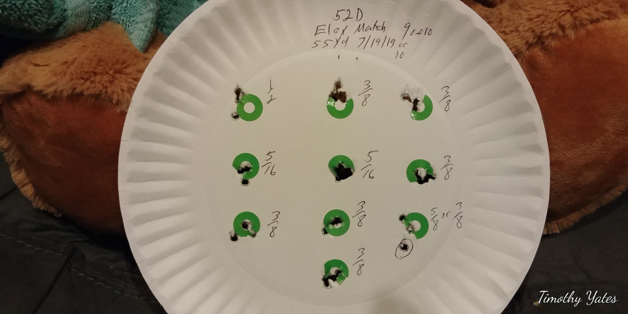

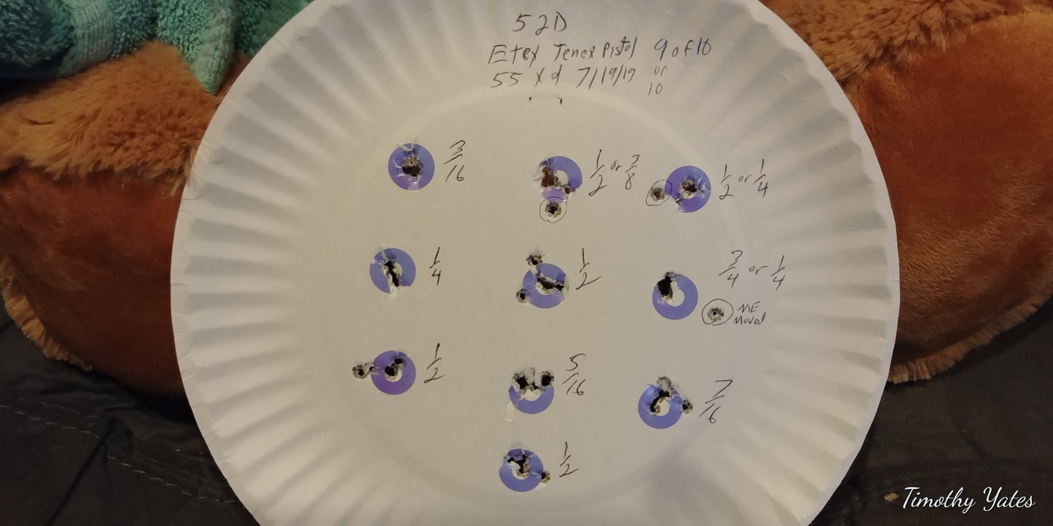

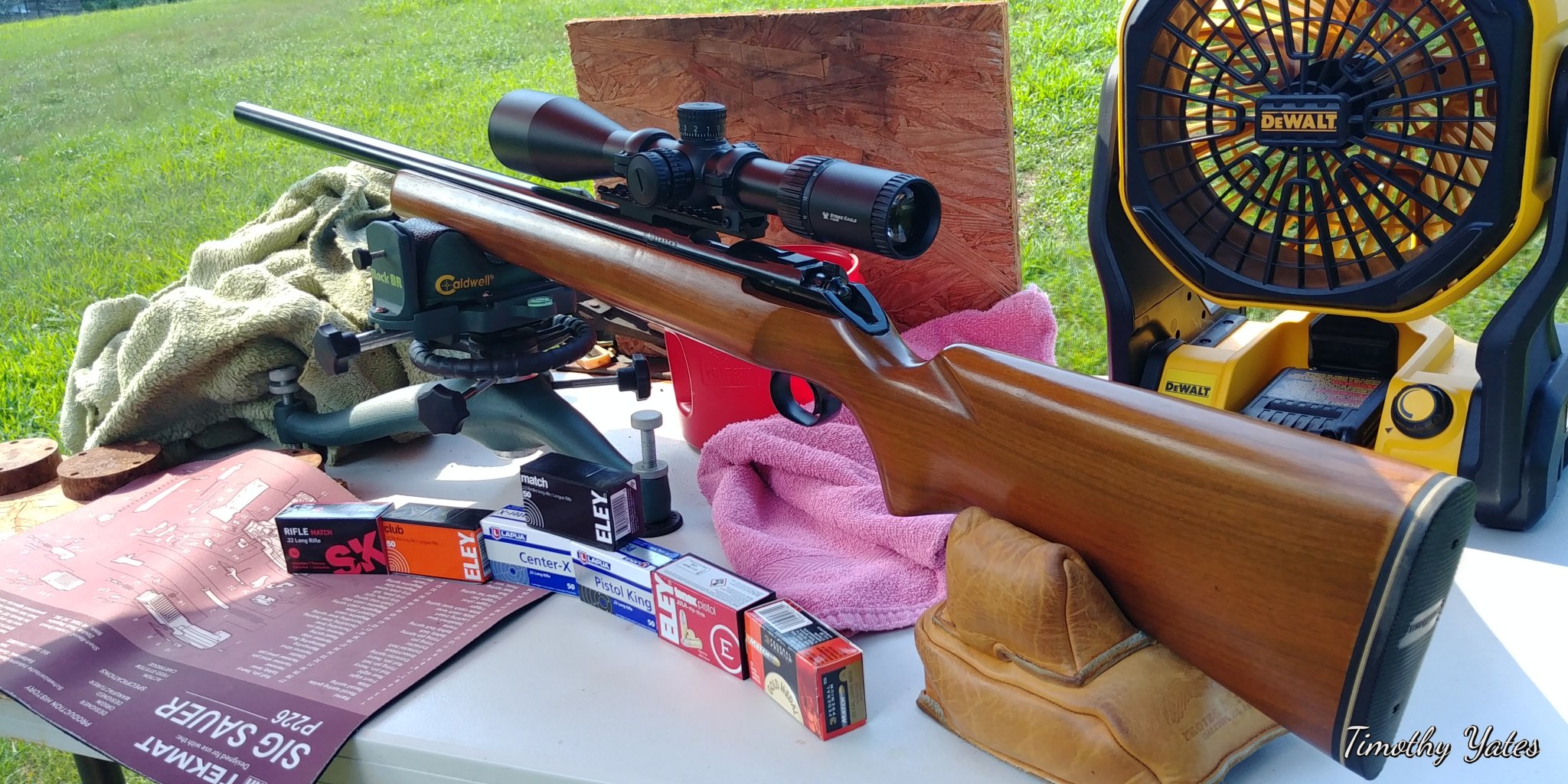

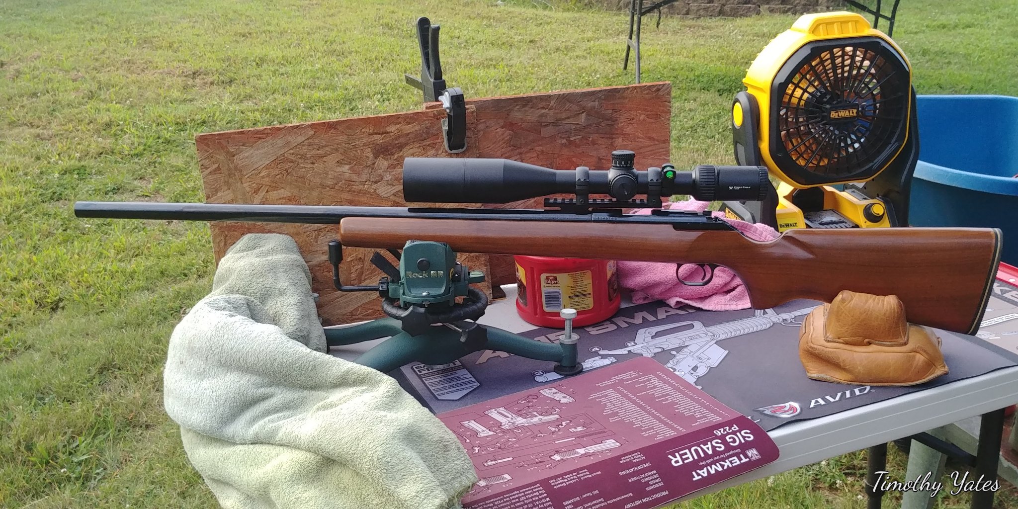

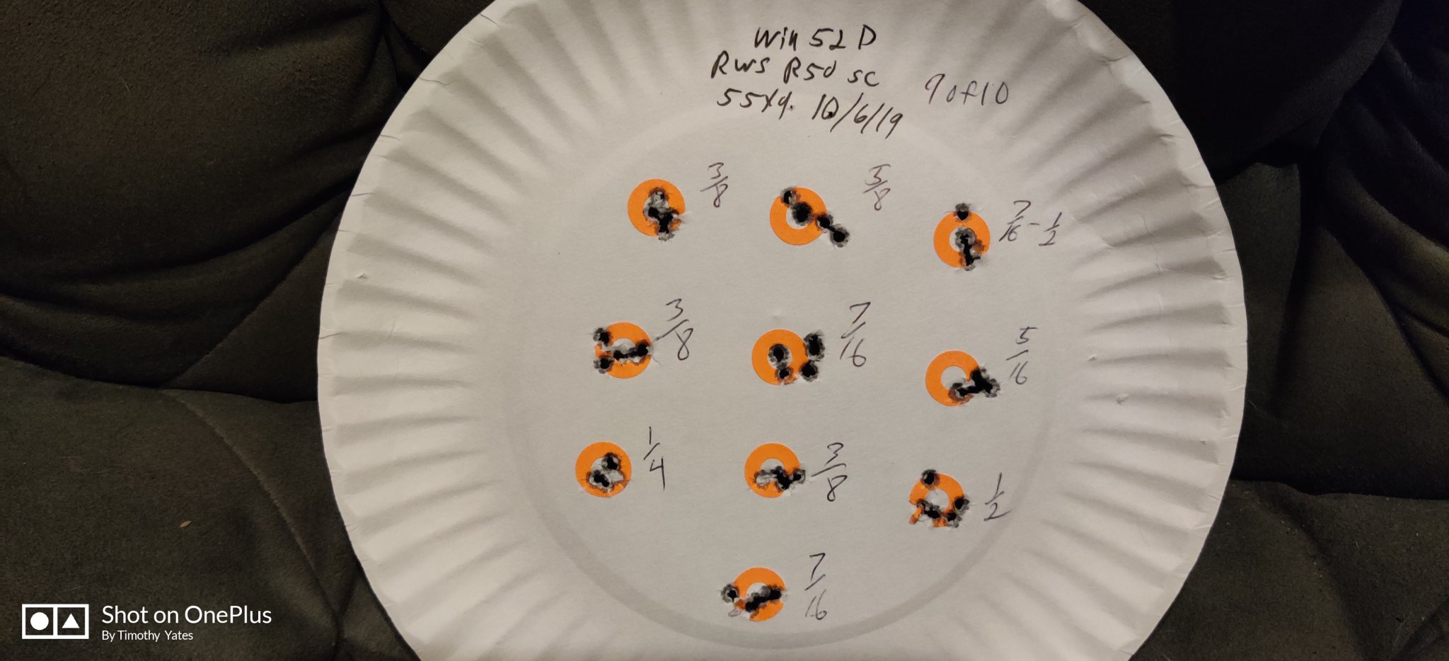

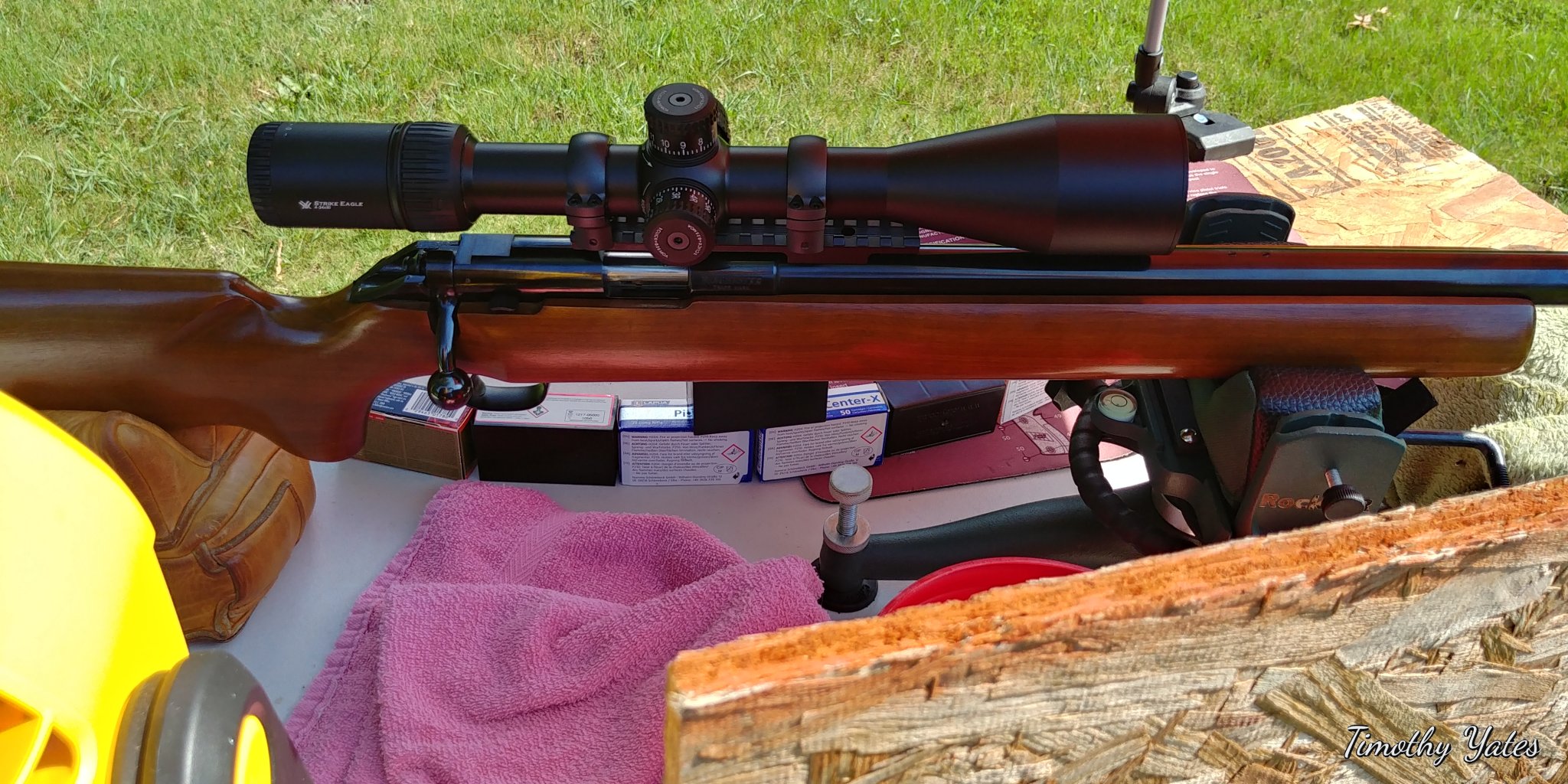

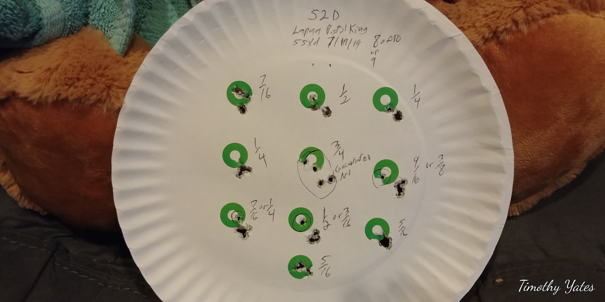

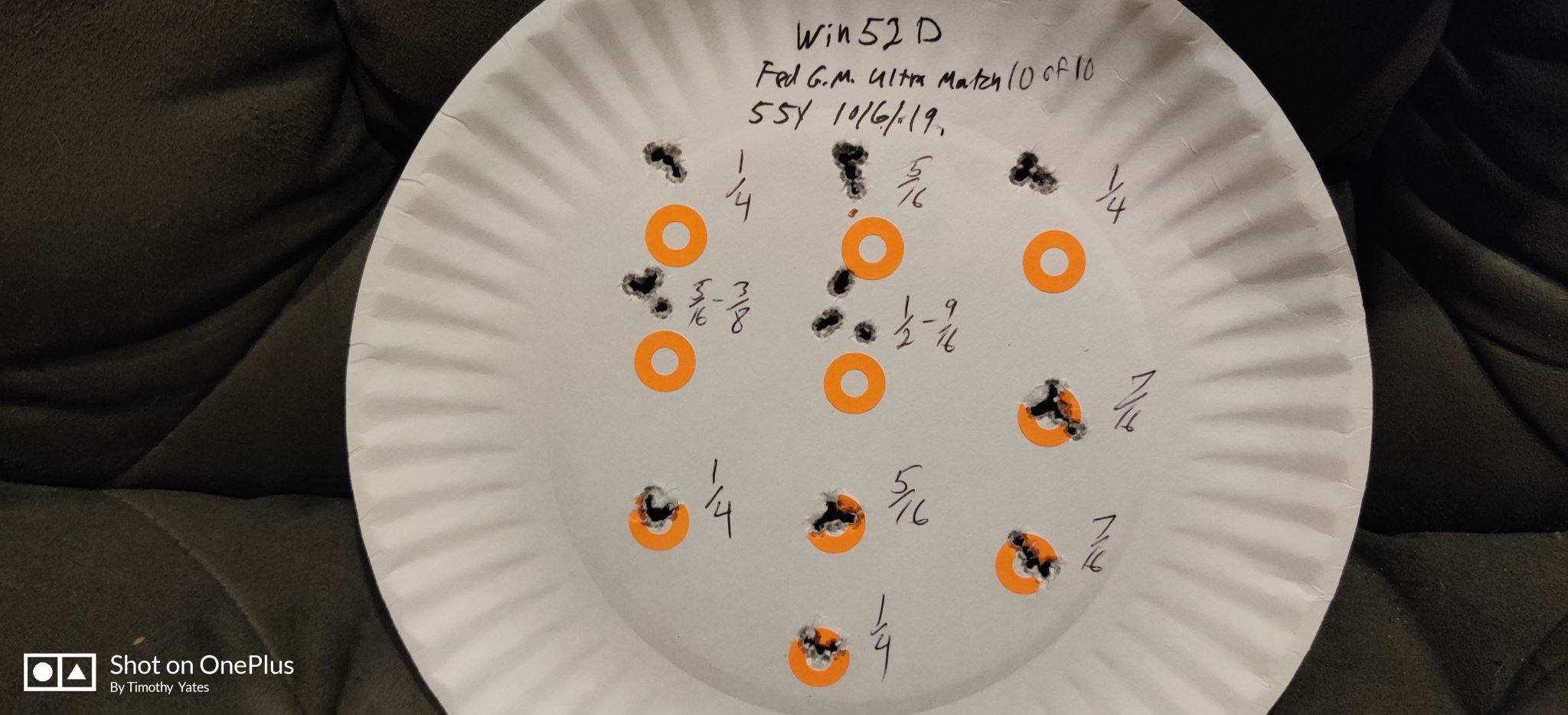

I paid $1,035 for this Win 52D. It is near 100%. Shoots as good as anything I have. I'd never sell this one, they are just too hard to find in this condition. Plus it does shoot pretty good. I am also using the EGW scope base. Five different types of ammo shown below.

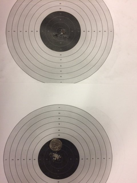

I couldn't help myself, I had to shoot it. So after cleaning, drying, lubing it up and adjusting the trigger it was time to see if it would go bang. I installed a set of Redfield Palma rear and International front sights. With all the rain we've had the back yard where I shoot to 100 yards is too soft to set up and shoot. I have a bullet trap set up behind my shop where I shoot pistols, if I set my air gun bench up in the back door, it's 35 yards to the trap.
This target is nothing to brag about, but with the set up I was shooting off of it's not really that bad. I was shooting down hill off my front rest only. With it adjusted all the way down the butt plate was way up on my shoulder, normally I'll use the rest and a bag. Also the barrel was squeaky clean, 20 shots before I shot this target. This is the same target we shoot offhand at 10 meters with air rifles.
Enough excuses
