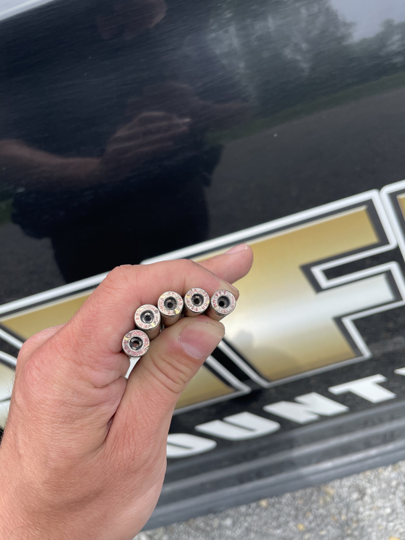

Primers pop out when fired?!?!? Causes a fail to feed jam.

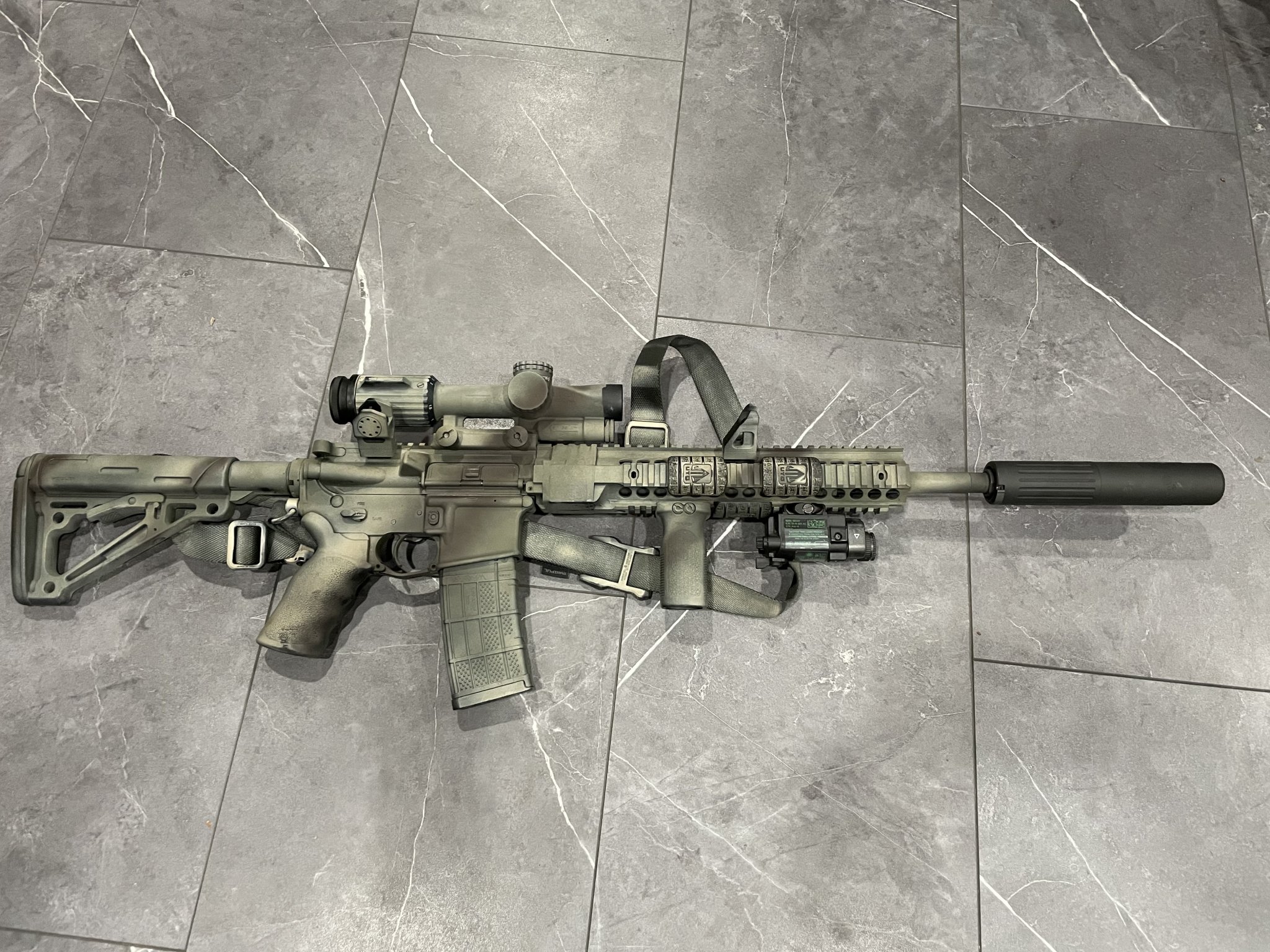

Bushmaster XM 15 MOE model so it has a mid length gas system and roughly an inch thick diameter barrel up to the gas block.
And for perspective, I think I had about four or five primers eject in roughly 14 rounds fired

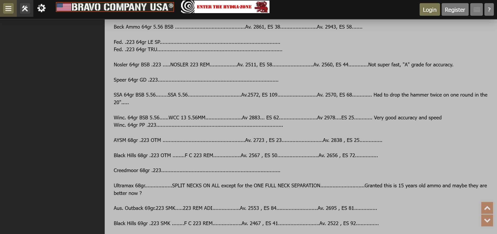

FWIW... the stuff from 2013 was loaded stout. No popped primers, but I only shot enough ( 20rds ) each barrel length to chronograph.
Molon also showed about 2796fps from his 20" Colt barrel.
https://www.ar15.com/ammo/project/self_defense_ammo_faq/MOLON/Winchester Ranger RA556B 64gr BSB.htm
SG Ammo chrono'd some current production 4 months ago.. 20" barrel 2910fps.

Well, I just found five more with popped out primers. When my captain figures out which lot number it is, I’ll try to post it on here for you guys. It is all marked WMA 23.

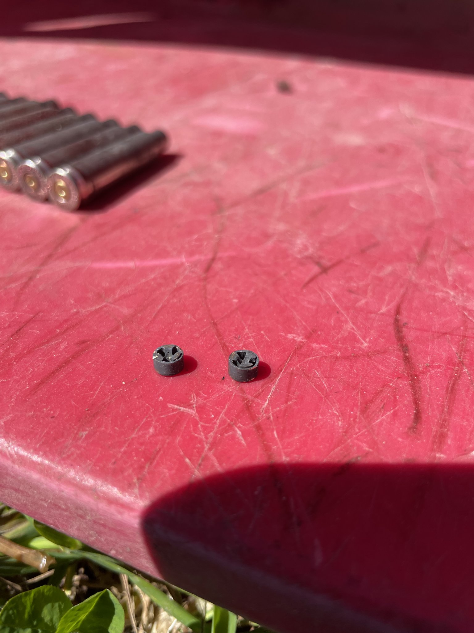

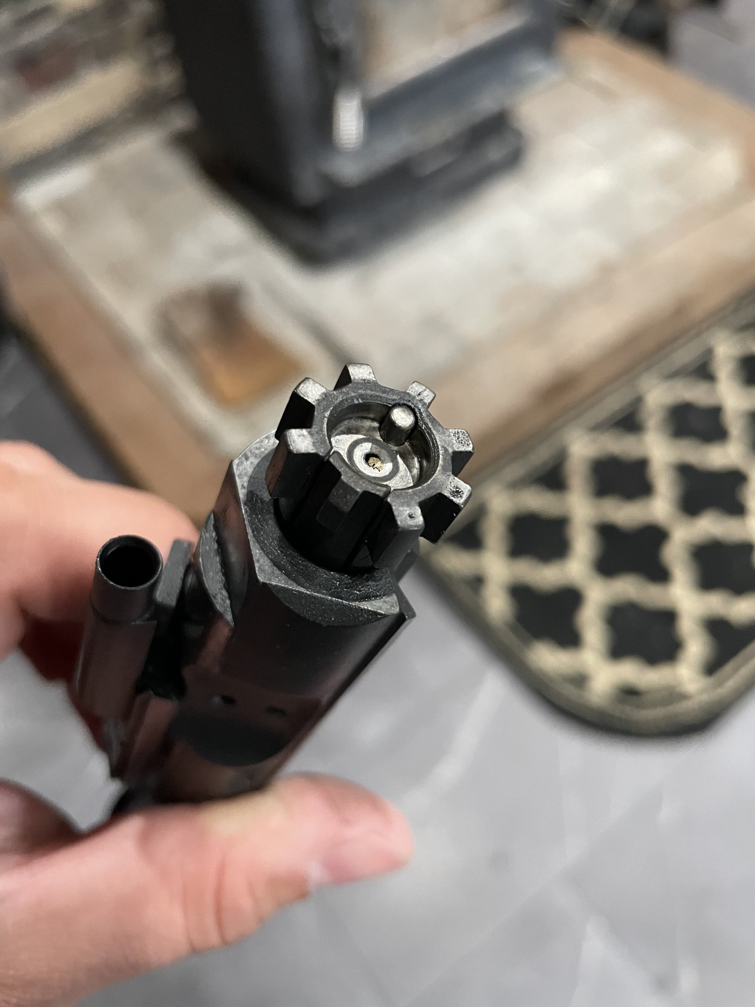

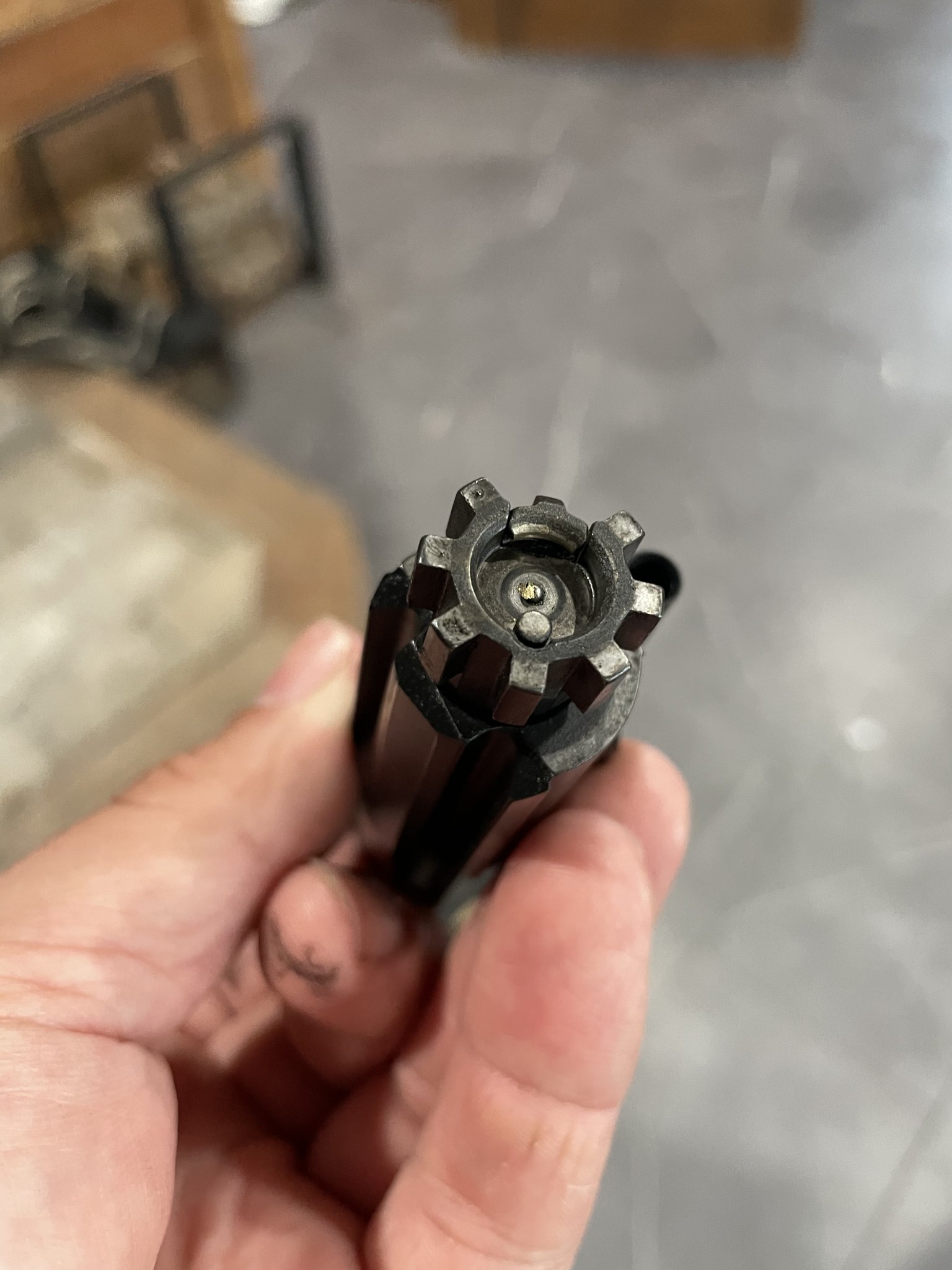

I didnt get a photo of the primers that popped out, but here is a picture of the firing pin protruding from the bolt head with a small piece of brass on it from the primer most likely.
Id take it apart and inspect closer. I meant what did the shells look like that the primers DIDNT pop out, like how far in is the firing pin hitting? Nice smooth impact? pin dont look very smooth and round. Just a thought..
Hadn’t even considered that I’ll have to go look at them when I get back home. At least I can check to make sure they’re not loose as well.

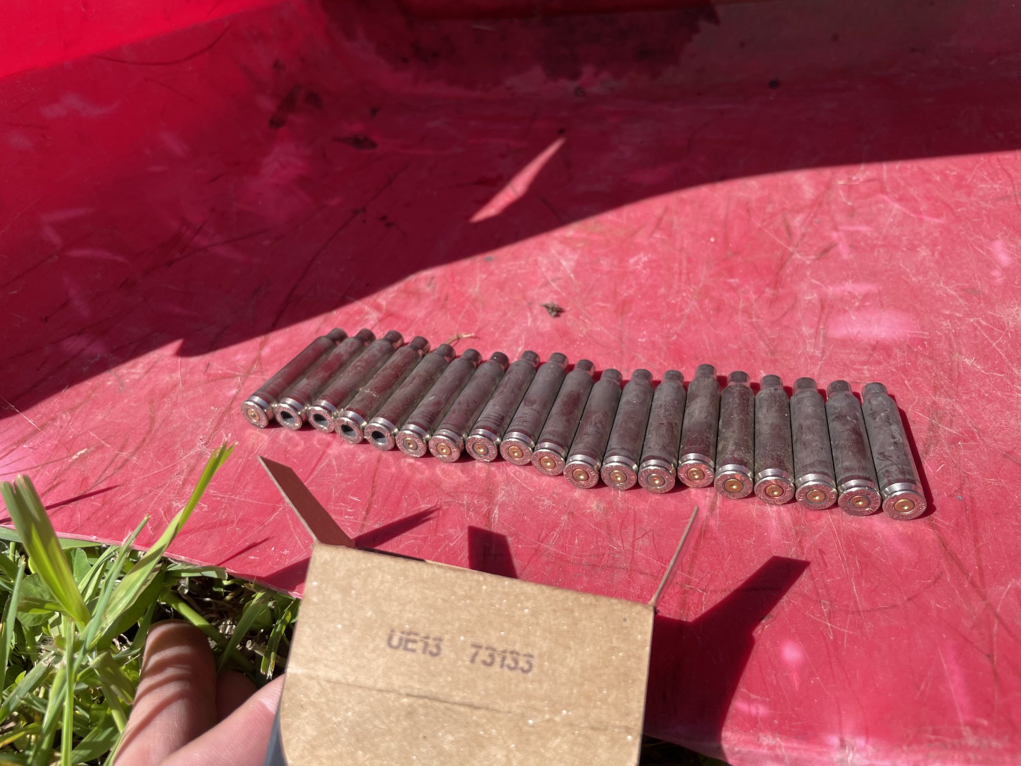

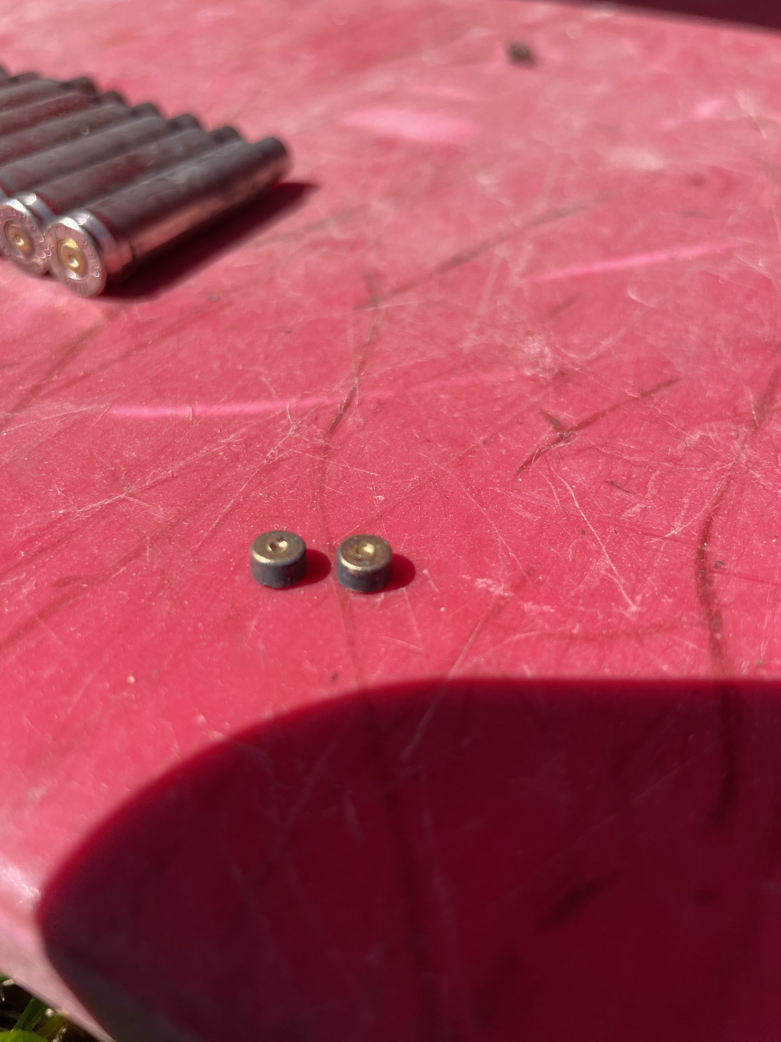

UE13 73133
Captain gave me some extra ammo to test between our lot numbers. This is the lot number I believe almost all of my ammo is from, and it had five primers eject and one prime or almost blow out.
One primer missing is not photo because I found it right afterwards.

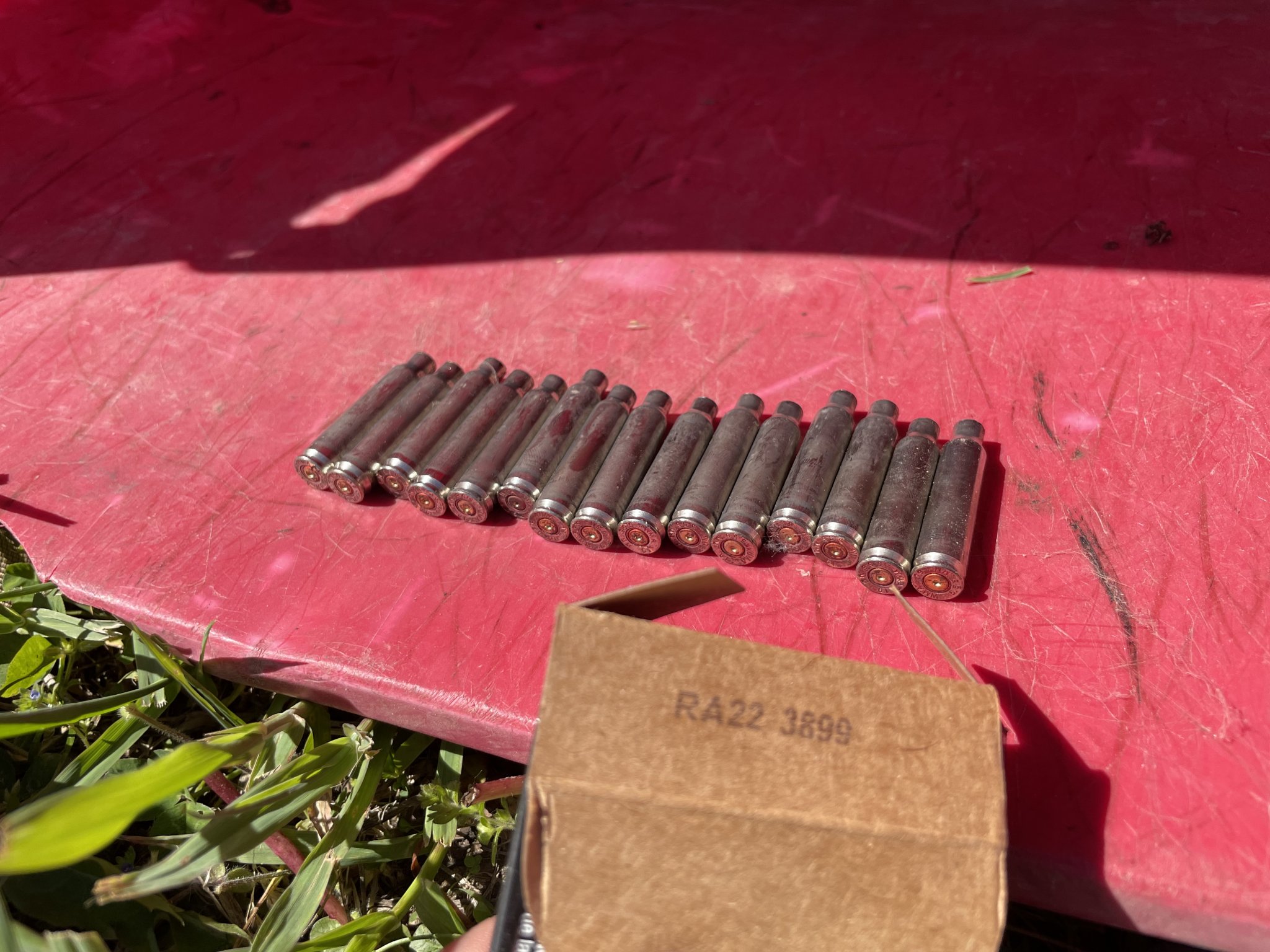

This is our other lot number 20 rounds zero problems
I have also fired M855 through the same rifle with no problems so there’s are two controls for the test

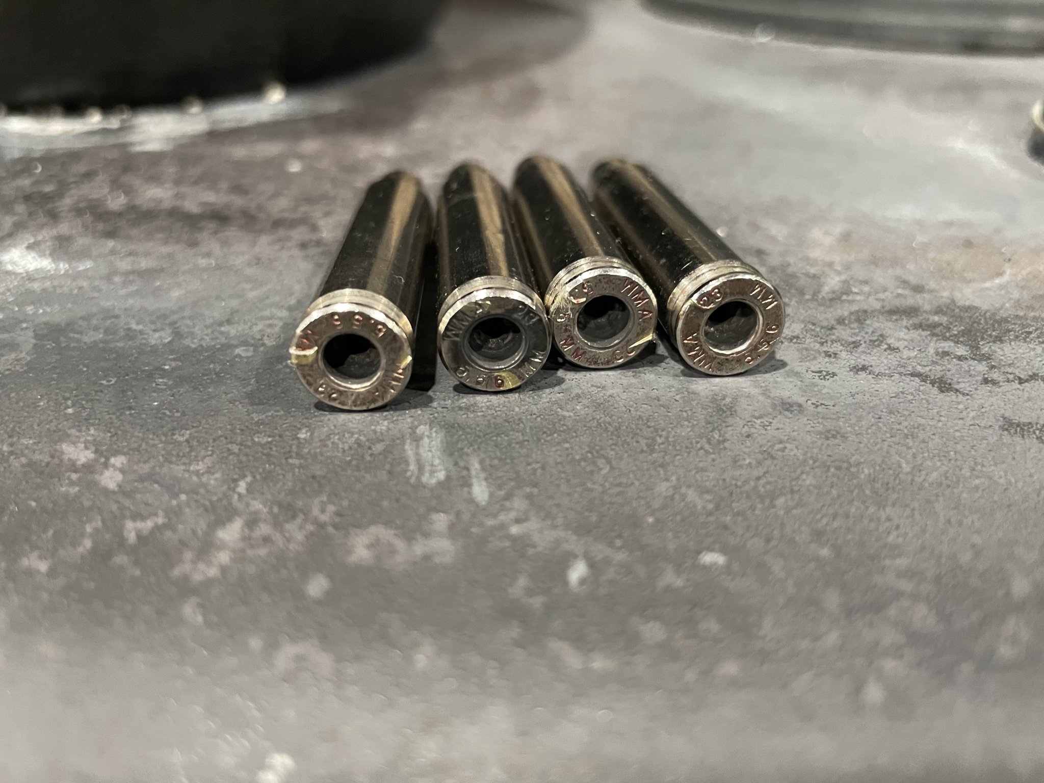

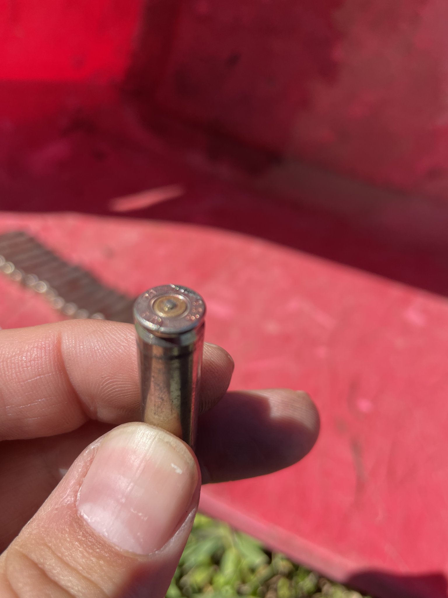

Based on the pic above that has to be the most aggressive and nasty looking bullet crimp I've ever seen.
Does the ops ammo look that way?
Sorry, that last photos a little blurry
the primer it is popped out. Looks like a little firing pin is protruding out from the primer.
Do you have the tools to verify base to the datum line on the shoulder to check to see if the headspace on the ammunition in question is correct ?
Have you performed any dimensional measurements on the ammunition ?

Given that you’ve had multiple blown primers, inspect the tip of your firing pin for any dents, cracks, or burrs.
If any of those are present, you need a new firing pin because it will be more prone to pierced primers.

I would 100% disassemble the bolt, pull the extractor, ejector, pin all out and clean it and then look at it closely.. it looks so dirty in the pics to see if anything is damaged.. or moving freely. Or perhaps its so overgassed its so violent? The flat wire spring you just put in too weak? There is something mechanically not working correctly it looks to me. If it were just the primers popping out maybe the ammo, but you got some other markings on the cases as well... makes me think its not the ammo.
