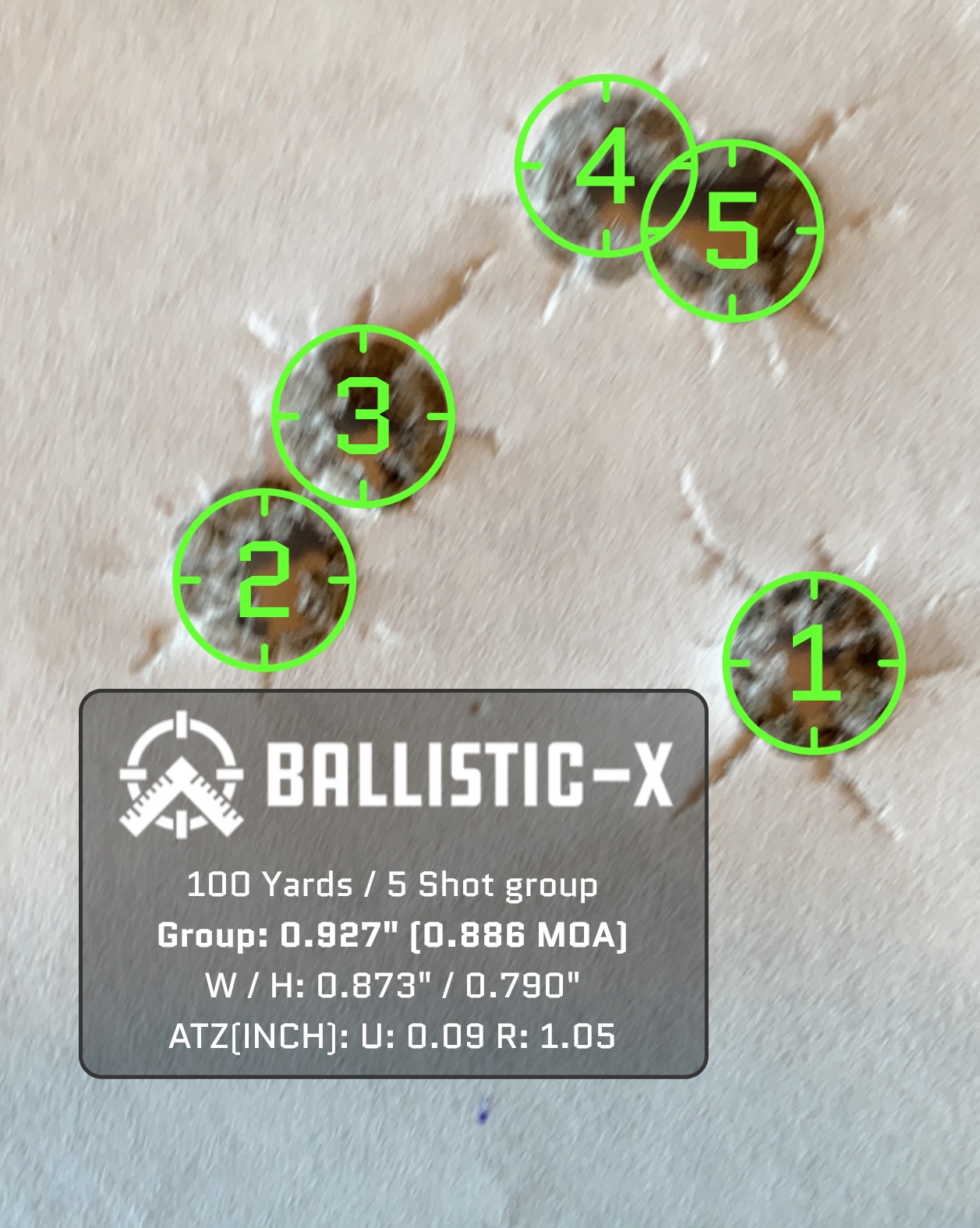

Gonna do some ammo testing tomorrow.

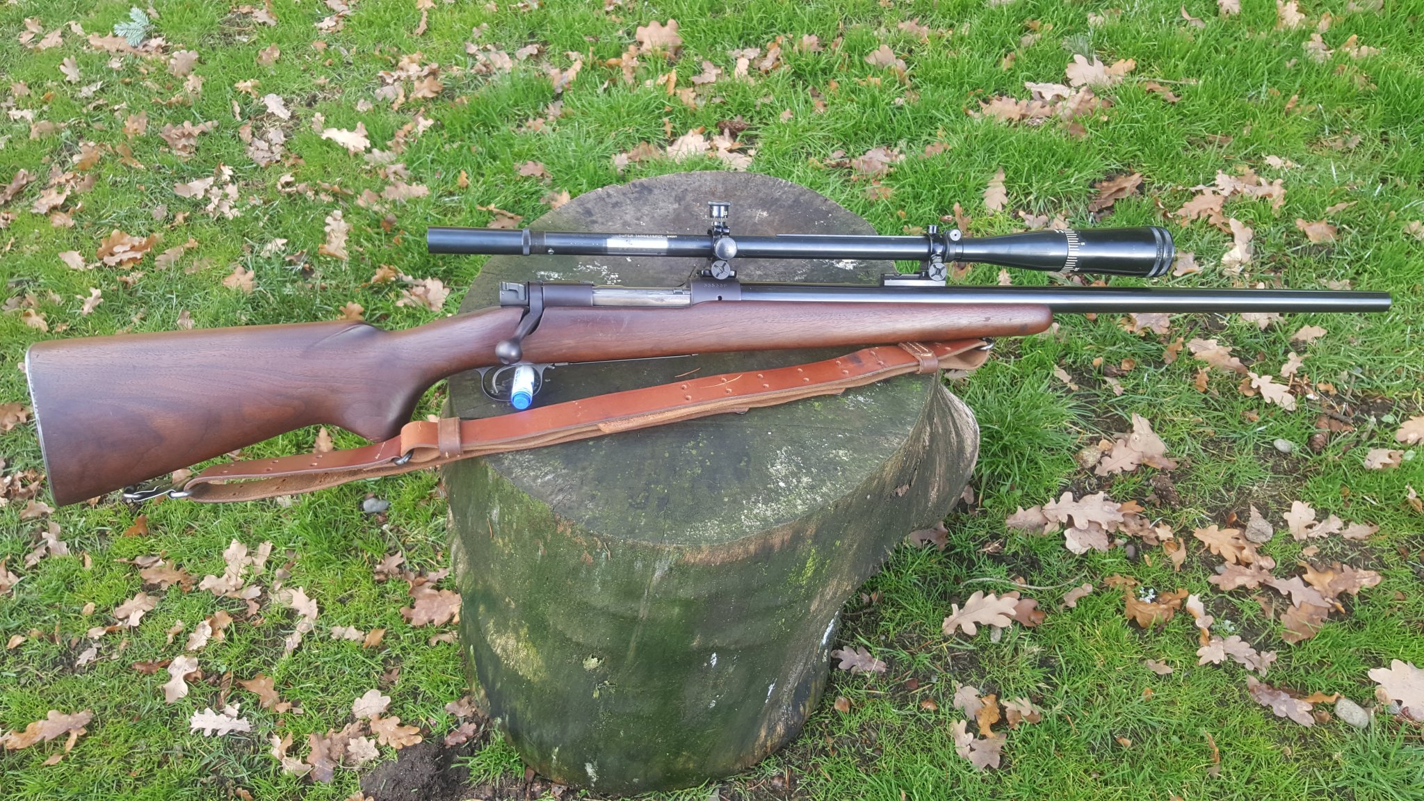

Not being in a position to get a pre 64 action I used the post 64 I had. The stock is a pre 64. The barrel is a douglas, the proper taper, length, and twist. The scope is a Malcolm repro, the optics are good but the adjustments in the rear mount- well the aren’t great.
love shooting this rifle.

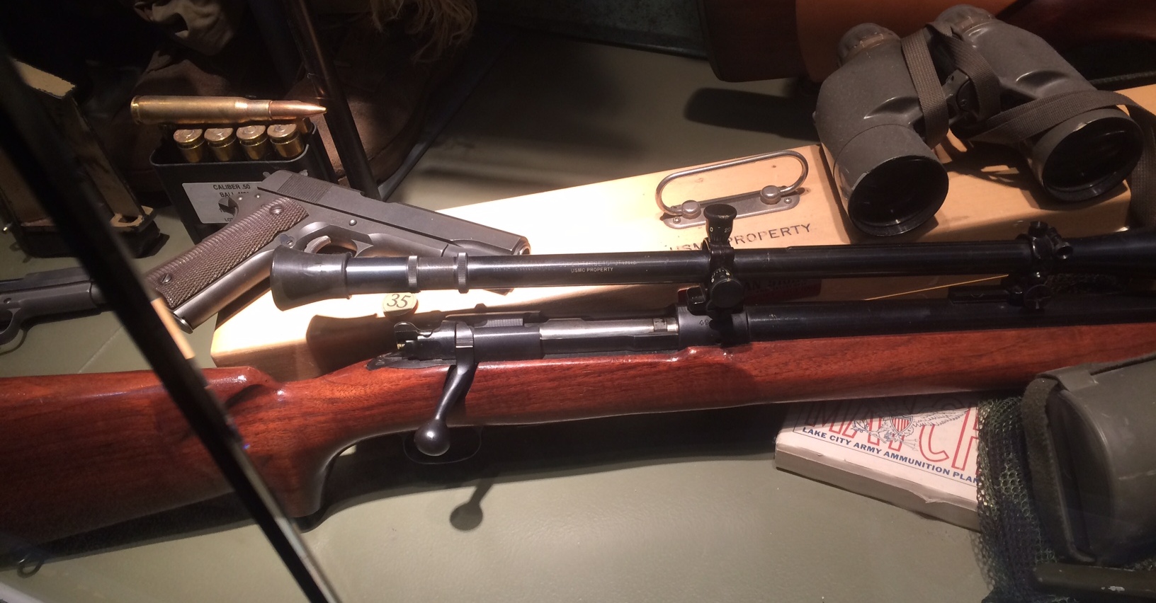

Only 4 or 5 options really:
1. Pre-64 target rifle with clip slot (ideal) or no clip slot? (caliber 30-06 of course)
2. Sporter checkered stock w/ original buttplate that has been enlarged for barrel profile, or a fatter Target stock with higher comb & orig buttplate?
3. 24" WRA or Douglas medium heavy in original WRA profile (.79" at muzzle) or 26" straight-taper Douglas barrel? (makes the rifle front heavy).
4. Optics: vintage 8x or 10x Unertl (ideal); vintage 8x or 10x Lyman SuperTargetSpot (some used per Jim Land (USMC ret.), a repo 8X Leatherwood, or a vintage 1960s era cheap Japanese 3-9x scope purchased from a PX in Okinawa (something like an old Tasco or Bushnell comes to mind). Or a vintage 2.2x M84 scope if the base M70 rifle is just a pre-64 Sporter rifle with standard/skinny hunting barrel w/ standard iron sights, and standard Sporter stock.
5. vintage green web sling, or vintage 1907 leather sling (both are correct based on pics)

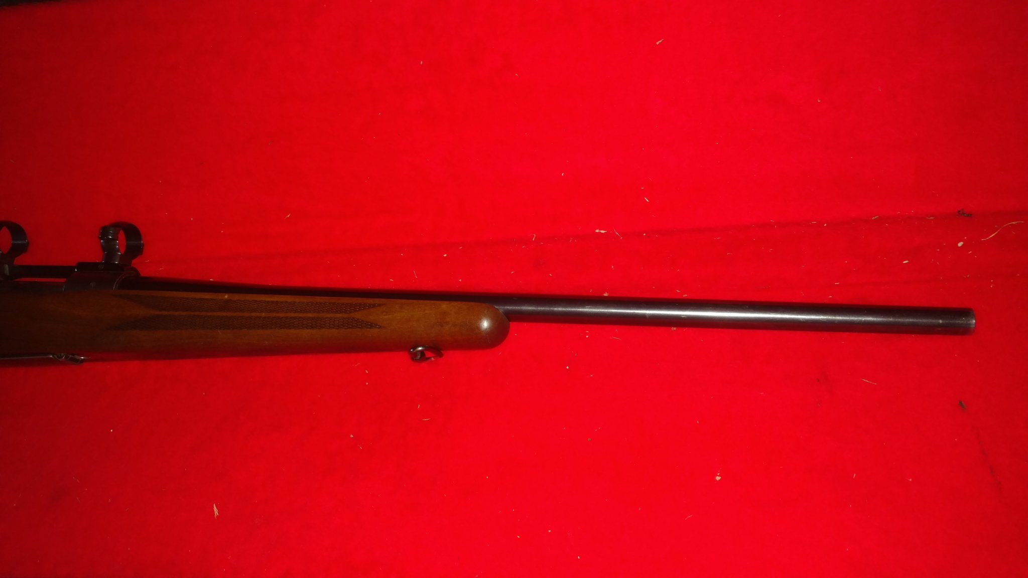

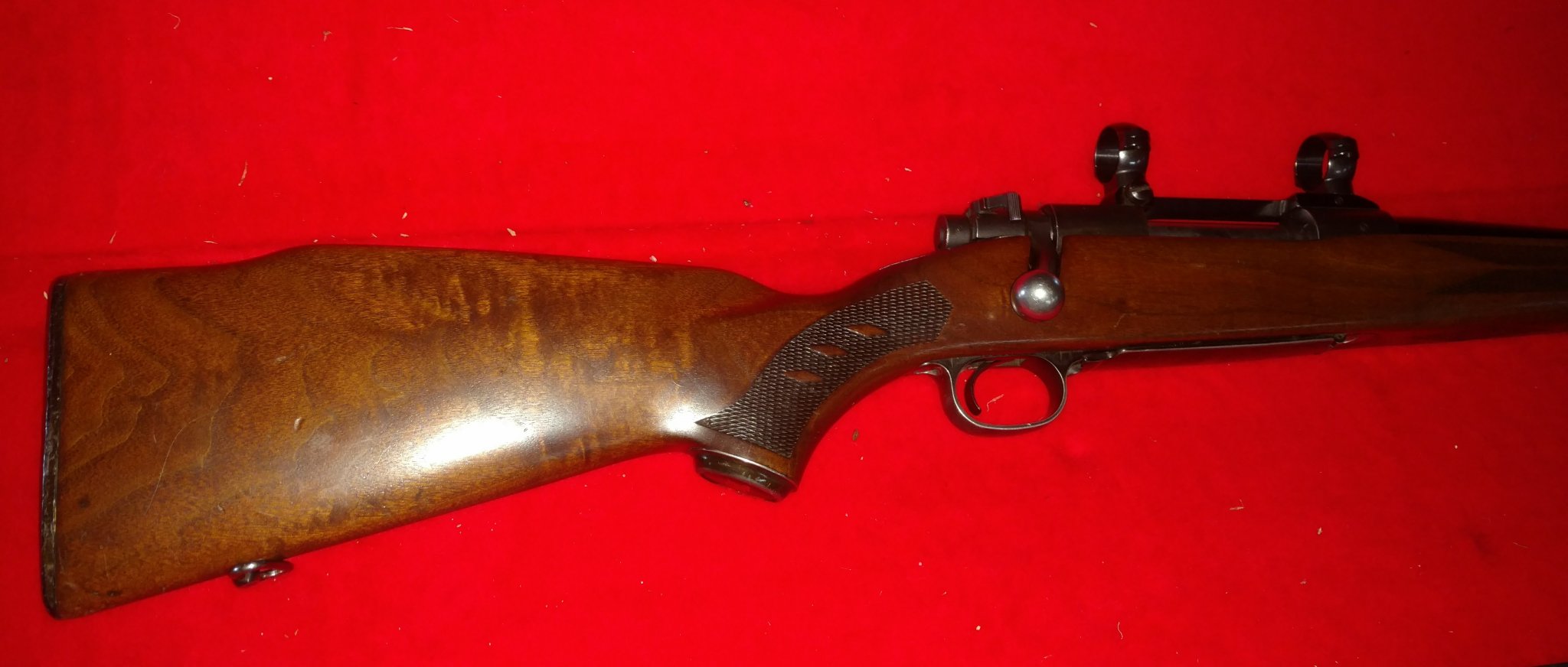

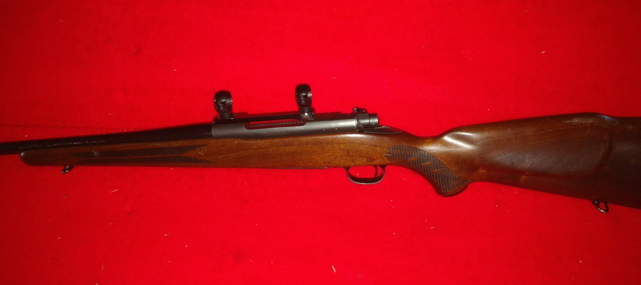

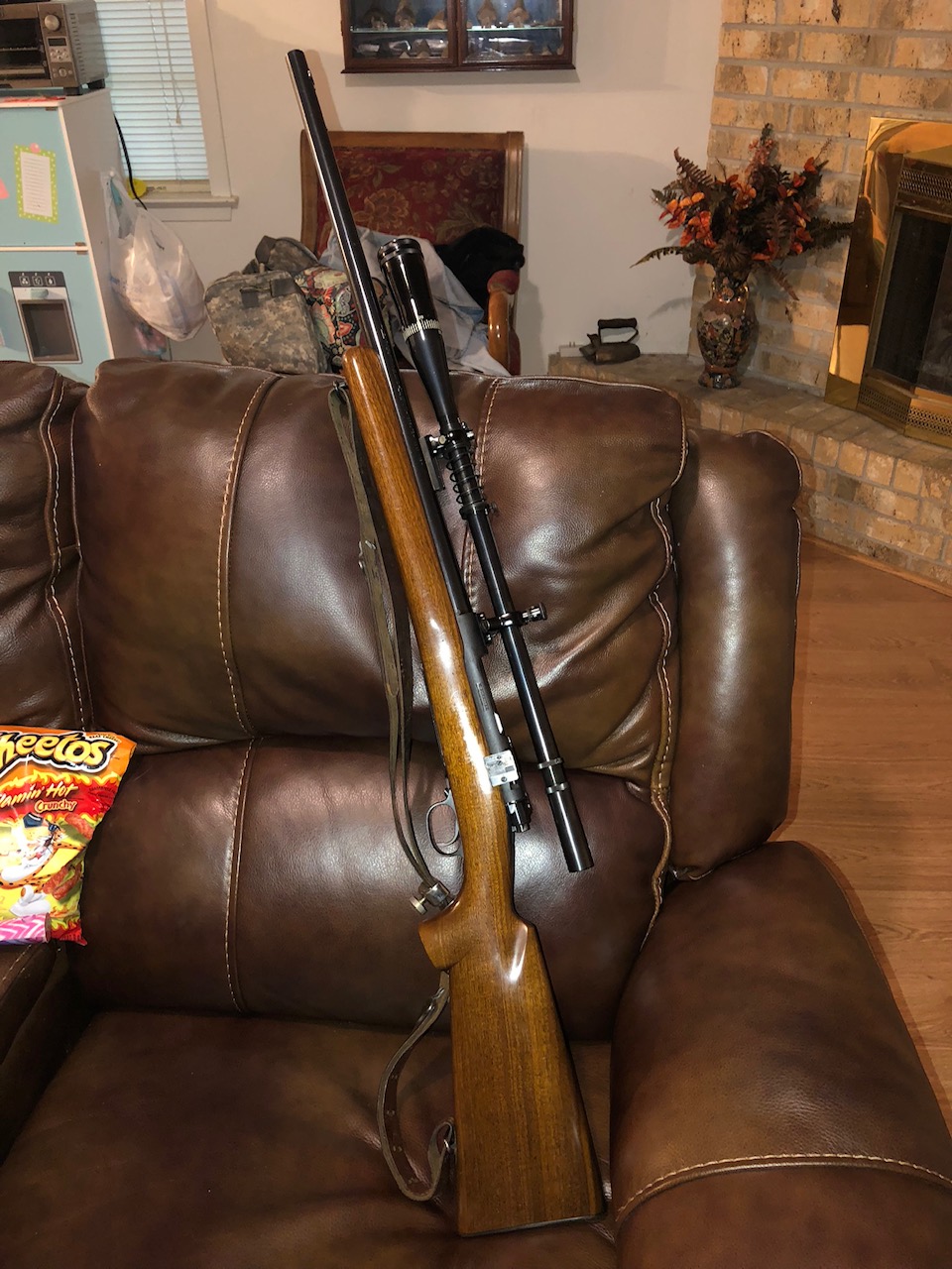

Ok PMac here they are . It isn't as "shiny" as what it appears in the photos. As I said in an earlier post, it really isn't anything special. Just a well taken care of old hunting rifle. Oh, and I did get a Lyman Super Target Spot bought yesterday
Reactions: pmclaine

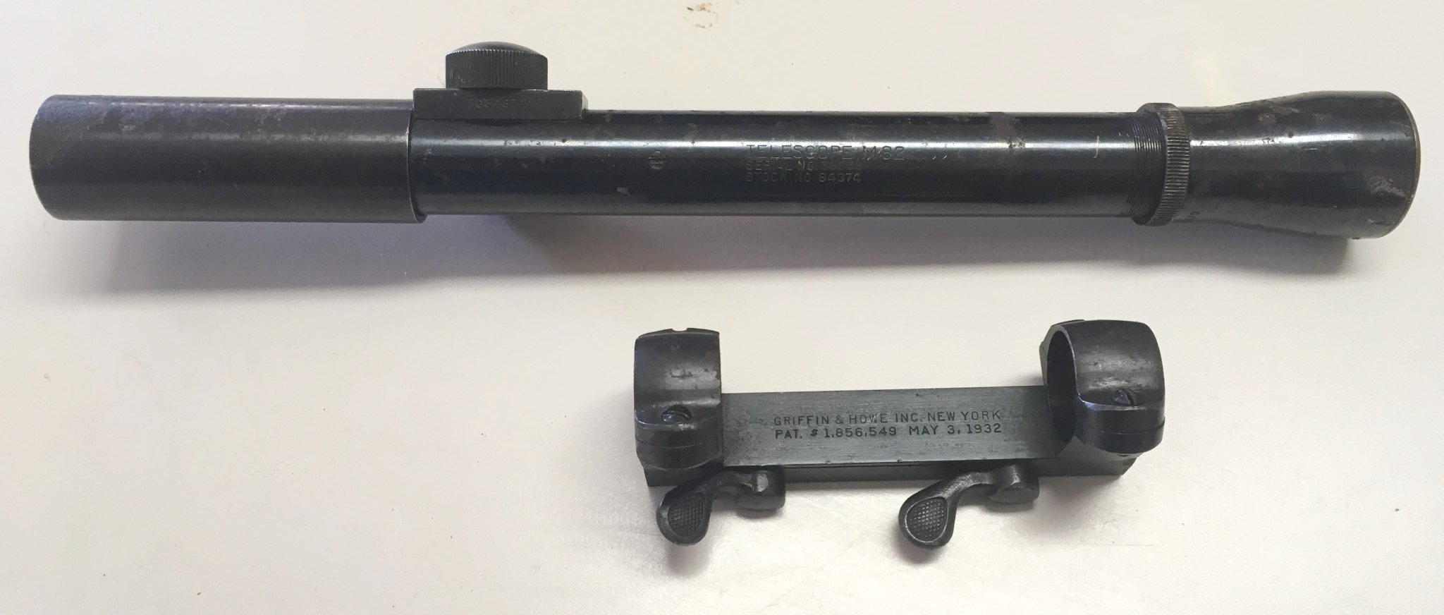

The Lyman Alaskan is the civilian version of the M84 scope, right?

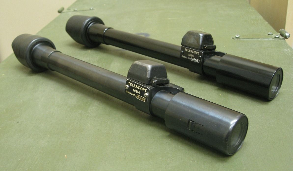

Nope, the M84 is different from the Lyman Alaskan. The M84 is a military scope designed in 1945 and went into production around 1951, and was primarily used on the M1D sniper rifle. It's has hinged covers over the turrets with an elevation BDC set-up for the 30-06 round.
The M81/M82 were the military version of the 1930's era commercial Lyman Alaskan scope, and were used primarily on the M1C sniper rifles. They have 'coin-slot' turrets with screw-off caps, that are friction based, and were designed as commercial items prior to WWII.

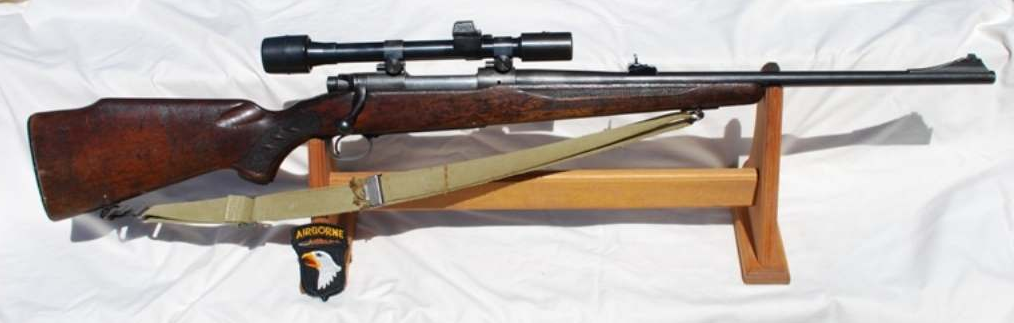

Attached is a picture of a well-worn M70 that was reportedly a Vietnam era improvised M70 sniper rifle that was recovered by the 101st Airborne. If one wants to build a reproduction of such a rifle w/ vintage rings/mounts, this is the best picture, and the only color one I have ever seen.
Also attached is a picture of a real vs repo M84 scope (repo scope is in the back of picture). (Real ones in this condition are well over $1k these days, and the repo's are about $400). Last picture is a real M82 w/ patina and the old G&H M1C scope mount (this is pricey set-up). I hope that info helps.
