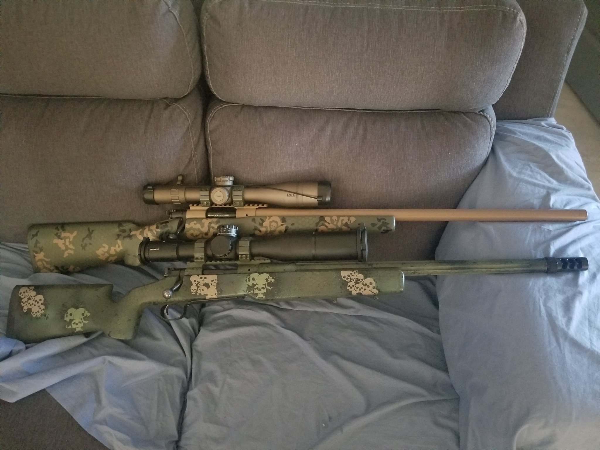

LRI put two together for me. I'd call them more of a precision lightweight hunter then precision though. I do like the claws and 3pos safeties more then the Rem even though there is a lot more support for Rem.

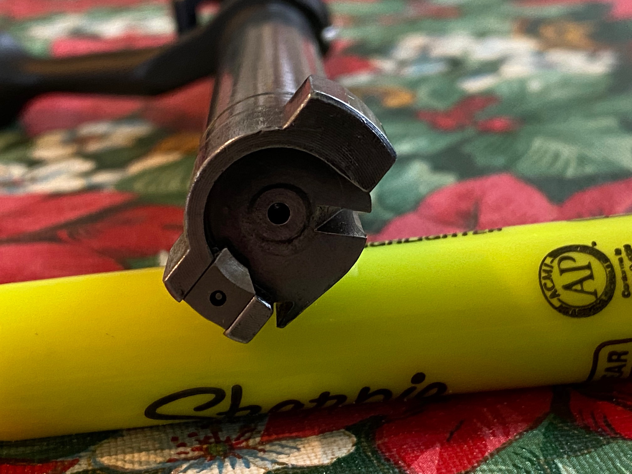

One thing about pre-64 M70 actions is that if you blow a case- admittedly an unlikely event- the brass bits will blow back at your face on the left side of the action. There is nothing over there to stop it.
I have one in 338 WM and my great old gunsmith in Arizona pointed that out to me one time when I asked him about those actions. He had some fix IIRC that involved putting a flange on the bolt shroud that would direct gasses at a 90* angle.

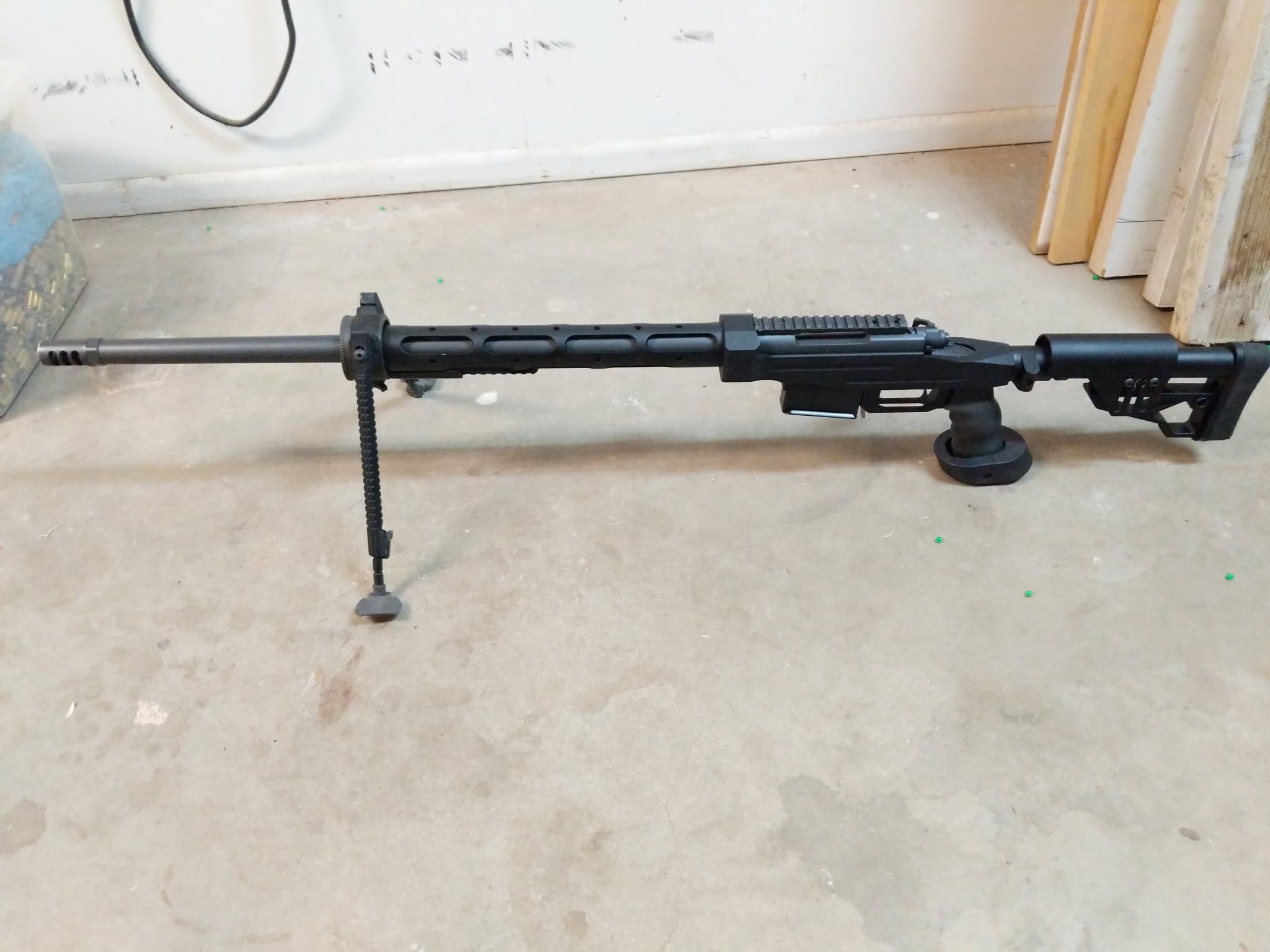

I just had a 7-300 PRC built on a push feed model 70. Bartlein barrel and timney trigger. I love it. Aftermarket parts/accessories are scarce compared to R700 footprint actions or even Tikka actions, but if you do your research and get your parts gathered up ahead of time it isn’t too bad. I would definitely make sure your smith is familiar with them (if you’re not doing the work yourself) as they do have their quirks from talking with mine. I shot mine in a match this summer and it definitely out shoots me 🤷‍♂️

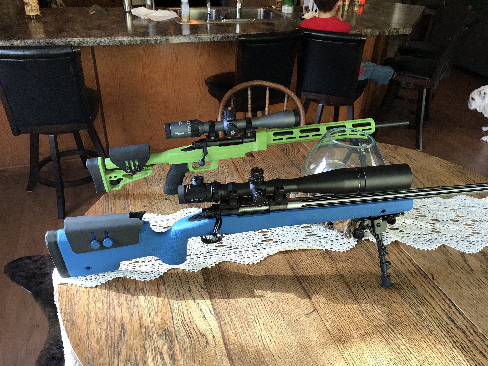

I have two 7 SAUM's built on the controlled round push feed (CRPF) WSM actions. Great actions with a mag box length of 3.05", 3 position safety, mechanical ejector, 2 piece trigger. These are very similar to aftermarket/custom "controlled round feed" actions. The only down side is that stocks/chassis are pretty much limited to Mcmillan, HS Precision and MDT. PTG is the source for bottom metal. I have one more action that's begging to be a 6.5 PRC or SAUM.

A guy in Northern Virginia does all my work. PM me if you'd like more details. The pic is from one of the M70 7 SAUMs he built for me. 27" 1:9 Bartlein #9, McMillan A3G. 180 ELDm at just over 2900 FPS. I think the marked first shot on target was more me than the cold, clean bore. :cool: Took it out to 1100. It definitely hits steel a bit harder than my 260.
Which KRG chassis can be inletted for an M70? I don't see anything on their website.

I had my last hunting rifle built on a Win 70
Win70 CRF Action (pre-MOA) 2000’s
3 panel bolt knob
Aluminum Obendorf bottom metal
Timney trigger 2.25lb
Brux barrel #3 10 twist 300 Sherman
NECG Peep Sights
Bell and Carlson Sporter
Bedded
Cerakoted Black Elite
Unfortunately not in my hands yet, but soon.

Honestly, ejection is what I hate about push feeds.

Greetings,
What is your issue with push feed M70 ejection? Trimming / tuning the ejector spring is easy.
John
Greetings,
John
By his wording, it seems as if he prefers being able to control the ejection on CRF. Push feeds don't have that flexibility. With CRF, you can ram the bolt backwards into the bolt stop and have your spent brass fly 3 miles away. Or you can gently extract the case and pull back the bolt softly to eject the case right next to you.
A bench block, pin punch, an 8oz hammer and diagonal cutters fixes it quite nicely. I would have a nice little pile 20 pieces of brass after rapid fire strings shooting highpower.
John
Is anybody using Winchester model 70 actions for their builds these days? That is all I used to use back in the 80's and 90's. I'm not referring to the newer rifles Winchester is currently manufacturing but the American made ones either pre 64 style extractor or post. It doesn't matter to me. the most economical would be the post push pull feed. Anyway, what do y'all think?
I have a model 70 chambered in 300 WBY. It had a pencil barrel and cheap stock. I sent it to Blue Mountain Precision to true the action, new CF Bartlein stock, trigger and manner's stock. It's came out great!

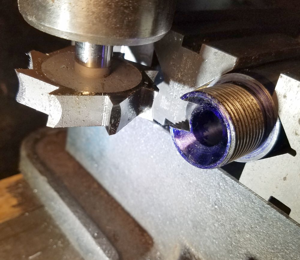

John
I agree, but this is still one setting. I get that you can make a push feed throw them a mile down to barely coming out. You cannot easily have some stay i. The action for easy removal and some thrown clear with just a flick of the wrist. Parts need changed.
Still I may try to dial back my XPR some.
