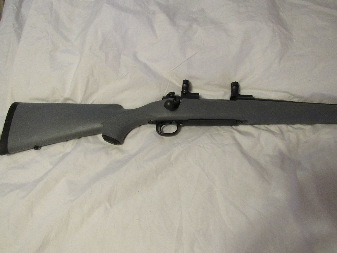

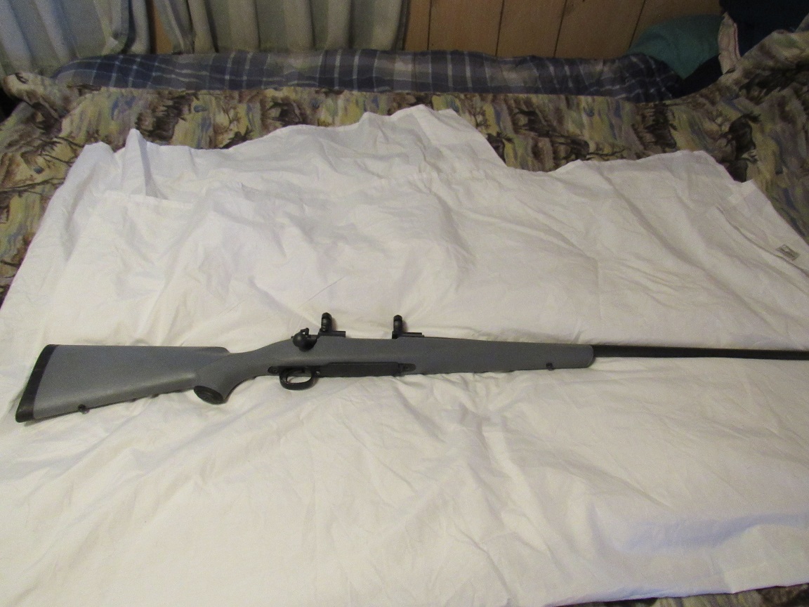

2002 RMEF win model 70 300 win mag... Push feed comes with leupold 1 inch scope mounts and rings..Less then 50 total rounds through this rifle. $450 delievered to your FFL
