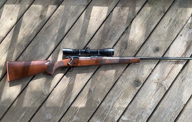

My brother gave me his Montana Elk rifle and I picked it up a couple weeks ago. He also gave me his stash of 140 rounds of Winchester Supreme 160gr Fail Safe! I bore scoped it and the chamber is excellent. Lot's of copper in the lands but I got all that out.
A couple of problems. The trigger is set at 6.5lbs and I can not get the action out of the stock even with some rubber mallet blows. I think it may have been improperly bedded before my brother bought it. I know there are 3 action screws. I'm taking it to my gunsmith next week. I definitely don't want to damage the stock getting it out. I'd like to adjust the trigger down and maybe replace the spring with an Mcarbo.
The other problem is the scope in those rings can not be moved rearward. It's a Leupold VXII 3x9 and I believe Leupold rings. I hate to put a picatinny rail on it; are there other options?

Is there a chance you could flip the front scope “base” around 180 degrees for the scope?
Otherwise look and see if Talley might make a direct mount, should get the front ring back and give you some room to move the scope back.
Otherwise a tasteful rail (or sections) might be the key.
