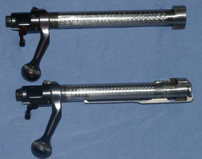

Welcome to the forum! I’m not sure when you purchased the rifle but the big factor will be wether it’s a controled round feed (claw type extractor on the bolt similar to a Mauser or ‘03 Springfield these are usually listed as either president ‘64 or classic) or push feed (similar to a Remington 700 bolt and extractor). The CRF rifles are pricey while the push feed M70s are cheaper and more common as hunting rifles, neither has a huge aftermarket for the “tactical” oriented shooter, but the pre 64s make for some interesting, if expensive, target rifle builds (more on that in the vintage rifles subforum). I think your best bet is to buy a good scope (plenty of discussion on the riflescopes subforum ) maybe buy a stock from Boyd’s or bell and Carlson (not too much out there unless you want to have Macmillan inlet one for you), bed it, and see how it shoots If you get to the point where you’re thinking about a barrel swap or cartridge swap, that can cost a fair bit with a gunsmith and it’s probably more economical to build what you want on a more common platform like an R700 clone or a Tikka. The push feed models make pretty solid hunting rifles and the 7 RM is a good cartridge for any American game animal so it might still do solid service for hunting. There was a guy on here a few months back asking a very similar question about a push feed m70 in .300 WM, you might try a google search of “Winchester model70 .300 win mag snipershide” and click through what pops up, he created two or three threads asking about rebarreling for a bull barrel. Enjoy!

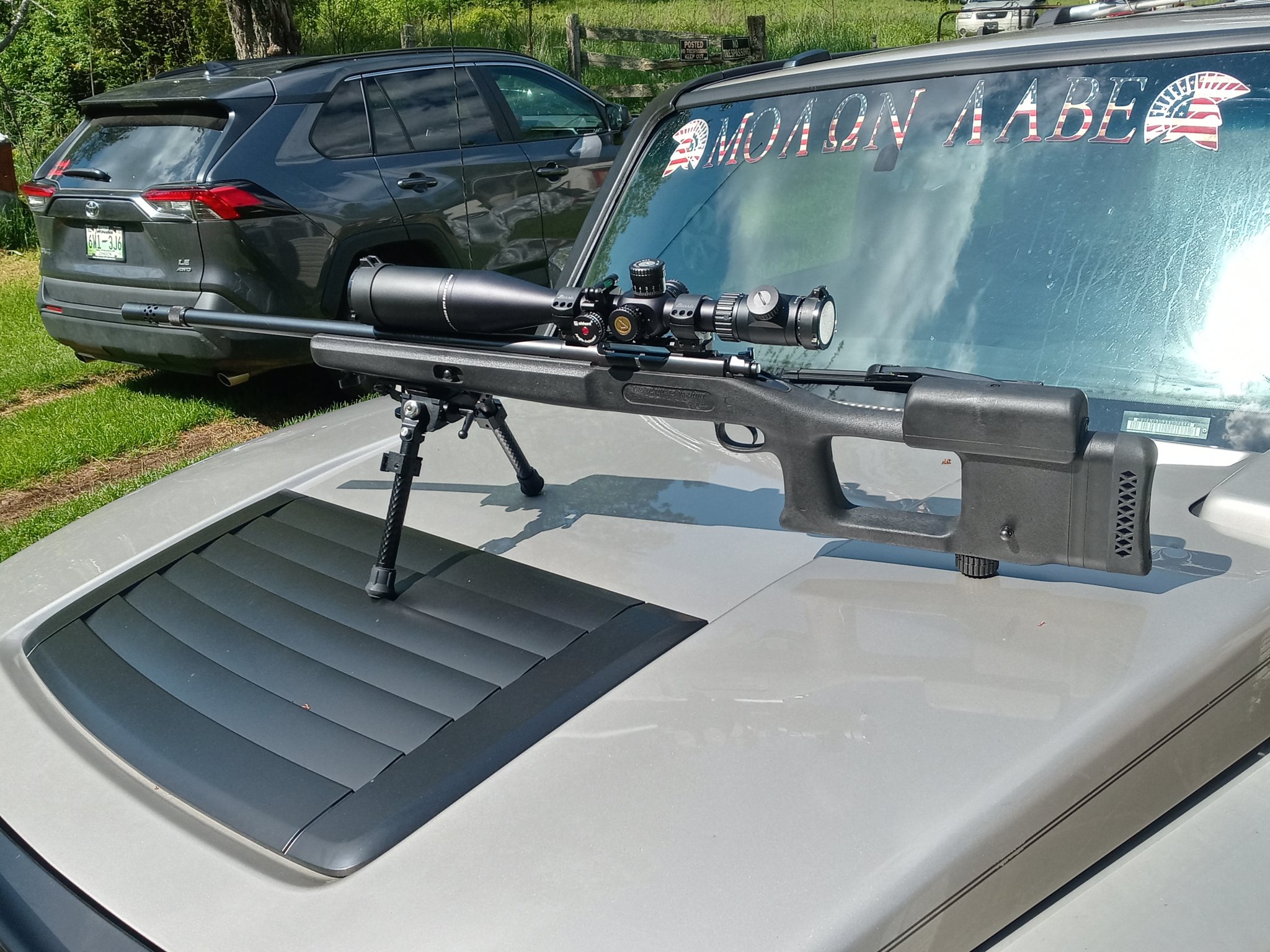

Exactly. I snagged one on Gun Broker for $1800. McMillan stock, Win 70 buttery smooth action and chrome lined heavy barrel. Thing shoots 3/4 MOA all day.

Is there a way to check the extractor? Or is it mainly an age if the hun deal? Mine was purchased around.....1999 or 2000 I believe. Been a while and lost track
Push feed on top, control round feed in bottom

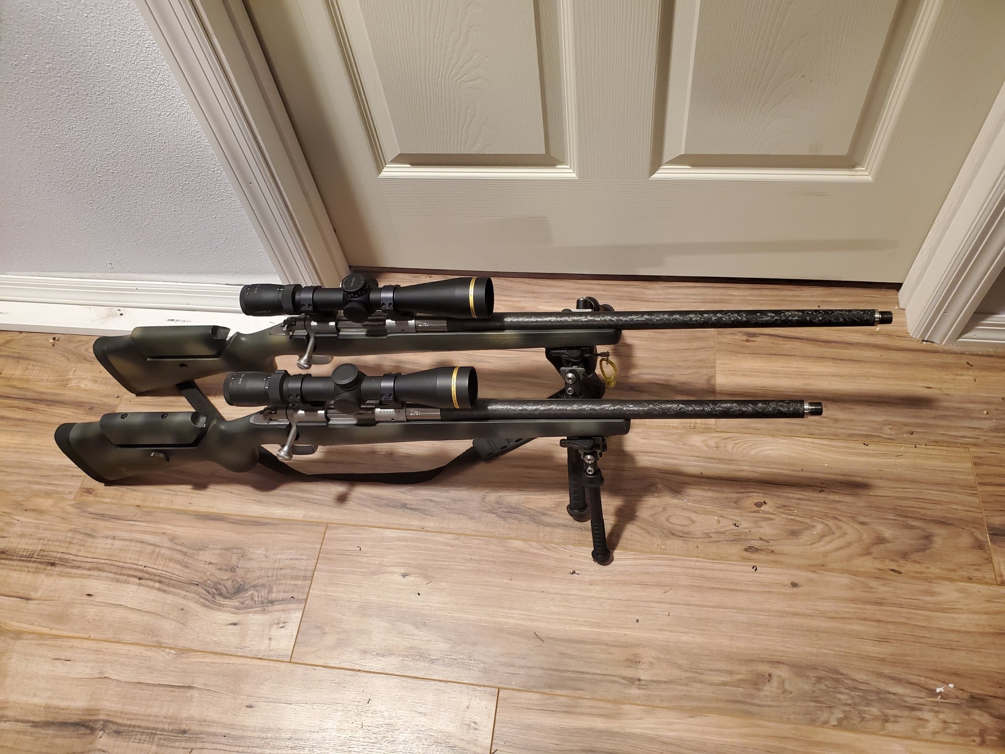

I have a similar situation. My brother gave me a Winchester model 70 CRF chambered in 300 Weatherby. It had a pencil barrel, and cheap plastic stock. Groups would fade after two shots and with the barrel stock combo it had a good amount of felt recoil. I just bought a Bartlein #4 CF barrel & manners stock and sent it to Eric at Blue Mountain Precision to true the action and assemble. I will be adding a muzzle brake and new trigger as well. Hopefully I can put together longer strings of tight groups and not get beat up as much by the recoil.

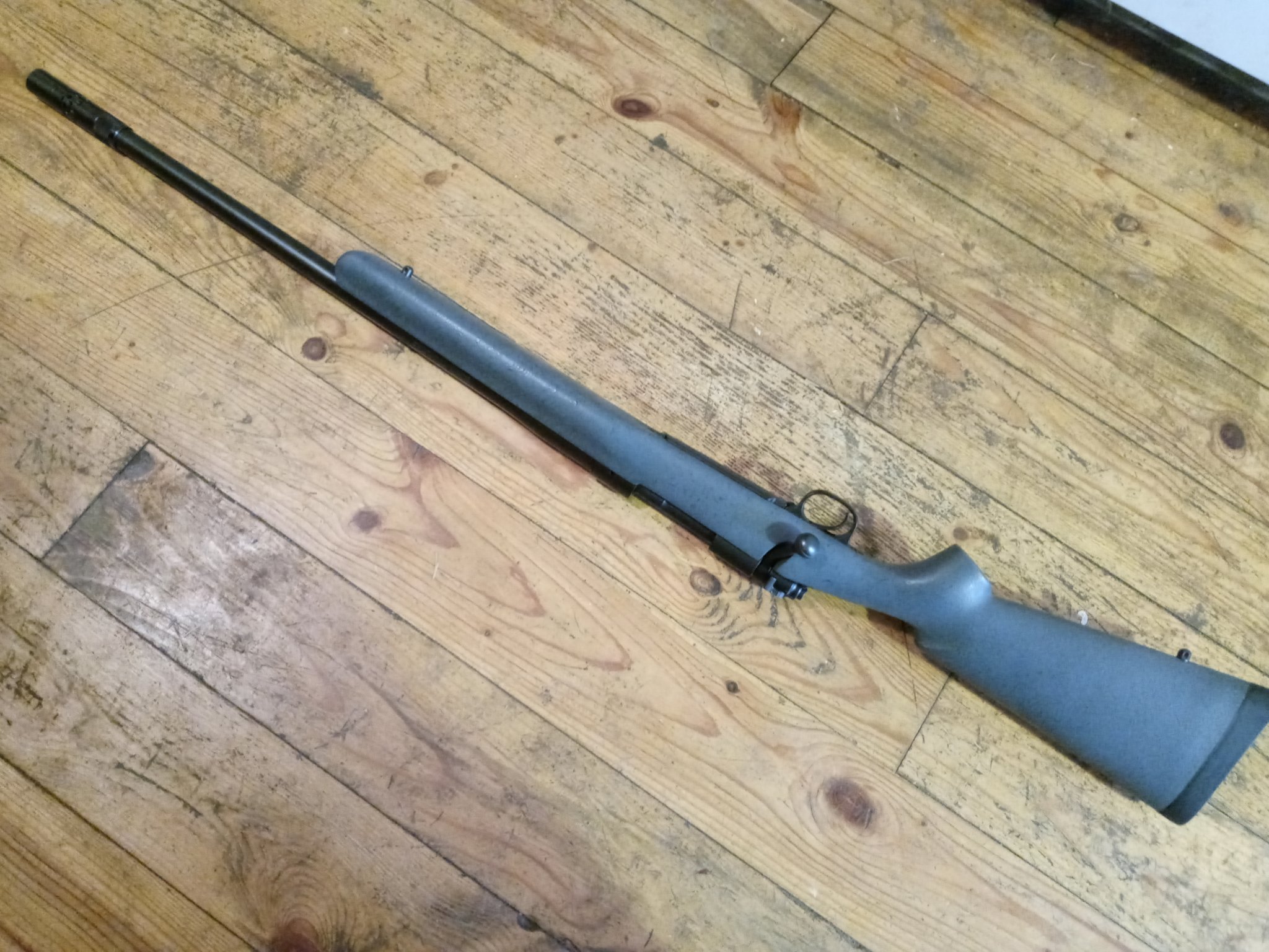

I'm not sure if you got your 7mm rem mag done. I just got threw building this one the wife picked me up at a local pawn shop for my birthday. Winchester model 70 Laredo 7mm rem mag with Boss comp on a 24 inch barrel. Just waiting on trigger springs and start putting rounds threw it. Now and then pics. It's been a nice budget build coming in just user $1500.
