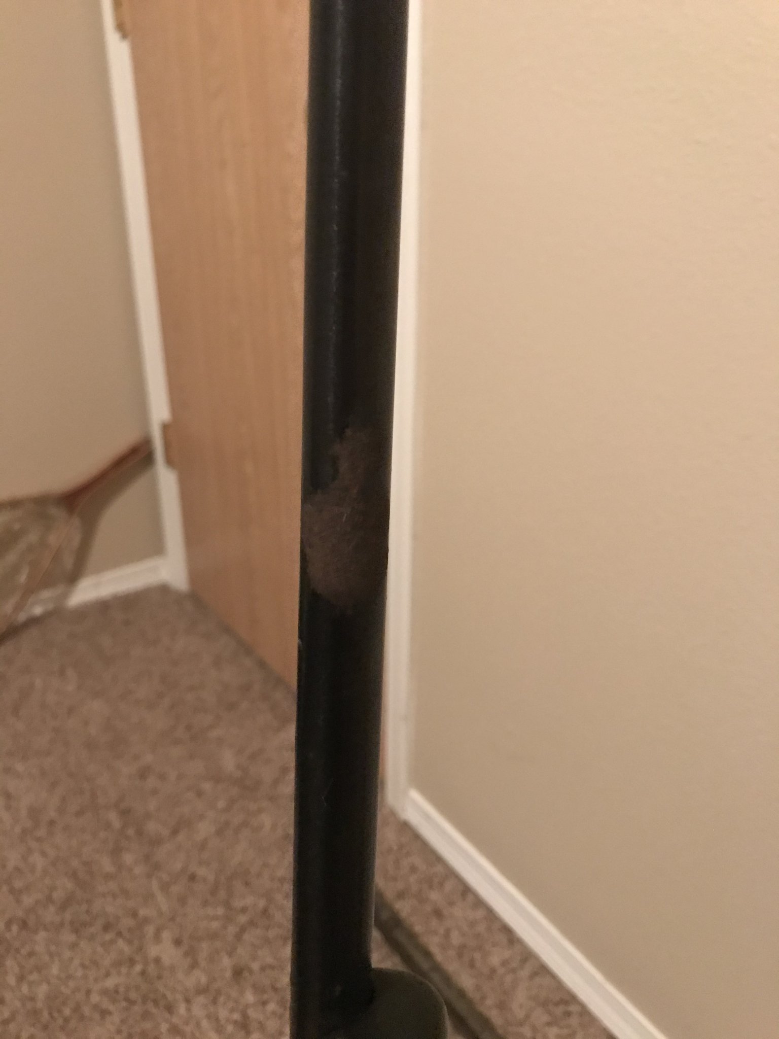

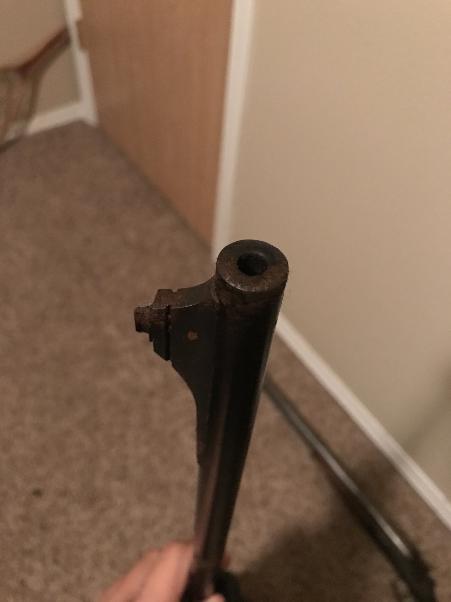

So, I was recently handed down an old Model 70 .264wm. It was definitely neglected. There is some pretty bad rust on the barrel as well as on the crown. Not sure if it’s beyond repair, it sure looks like it to me but I’m no expert. The good news is the action looks rust free. What would you all do with this? Rebarrel to another caliber? If it’s fixable try to have it repaired? Not worth the trouble and cost at all?

the rust, whilst it looks terrible, could be entireley cosmetic....
give the bore a good clean and eyeball it - if there are no obvious problems (eg rust pitting that you can see unaided) then go see how it shoots.
yes, any competent gunsmith can put a new barrel on that in whatever cartridge that tickles your fancy (as long as it shares the same bolt face size)

As far as the rust, you might get some fine steel wool and Kroil, Sheath, Barricade... and try rubbing the rusty areas. A friend had neglected a RPR or put it in the gun case wet, and it developed some splotches of rust in a couple places. I was mostly able to get them to disappear, and I gave him a can of barricade to use on his other rifles.
The bore I would give a good cleaning, maybe a little JB bore paste on a relatively tight fitting jag to lightly clean/polish the bore if needed. Rebarreling is also an option.

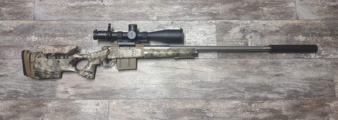

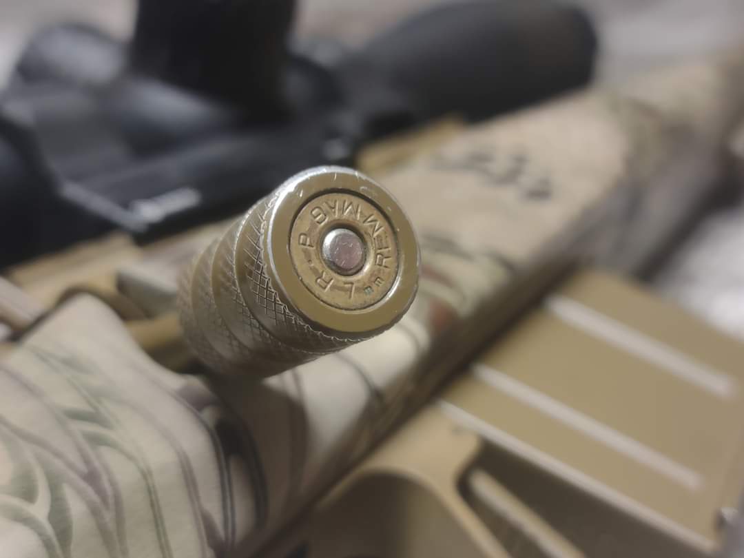

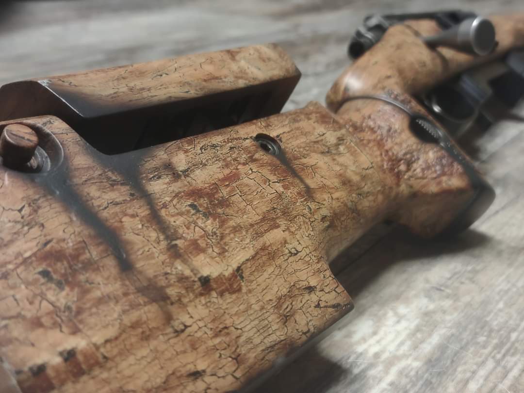

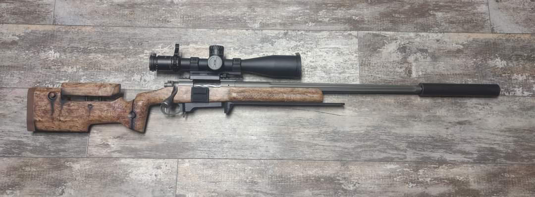

Been meaning to snap some pictures. Here's my four M70s. All pretty different tools for different tasks. Not to hijack, but may give you some ideas
1) my first rifle from my dad was a push feed LA chambered in .243. Barrel was pretty much toast by the time I got it, and decided to make it better.
Built into a match rifle by LRI and chambered in 6x284 shooting 115 Dtac bullets. Manners TF4 folding stock, hydrodipped in a distressed wood pattern.

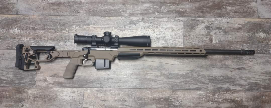

2) My first fully custom from the ground up. Bought a bare M70 LA CRF and had my boy at TS Customs turn it into a 7mm Rem Mag Match with a fast twist for heavy bullets. This rifle is a pig, but it's been to 2400 yds with 180 Berger hybrids at 3100fps.
Manners T5A stock, hydrodipped in Kryptek Highlander. (Google "Forging the 7M4 HAMR" to see it being built)

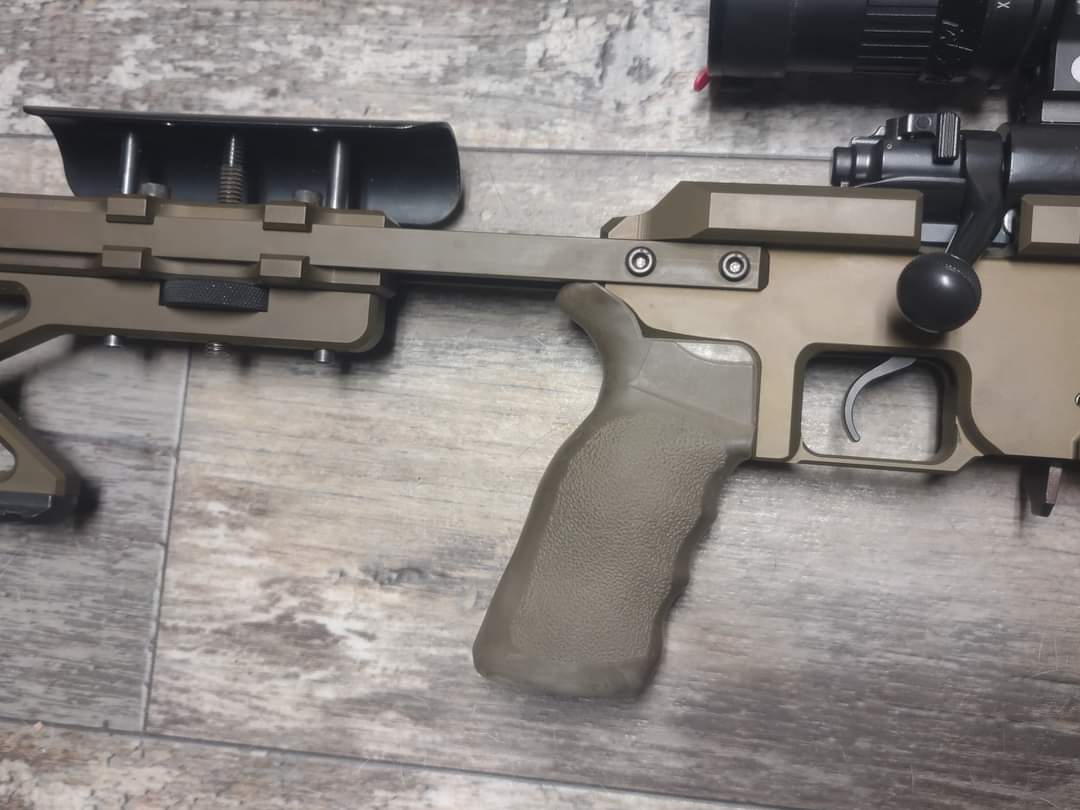

3) The most recent. I've always wanted an FN SPR in a short action magnum, but this came up for sale and I had to have it. A Win M70 SA CRF, chambered in 6.5 SAUM with a 27" carbon fiber barrel. Fast twist for 150+ class bullets. Dropped in a MST ESS folding chassis.

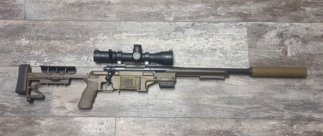

4) This one has the least sentinel value, just found a good deal on a used M70 push feed, long action at a pawn shop a few years ago, so I poached the action. Had TS Customs chamber it in a 16", 8 twist .308 and I'll be gassing up 220-230 class subsonic bullets for close range for hunting. The LA mags let me load 230s to an oal far longer than normal .308 and still run full power if I want to.

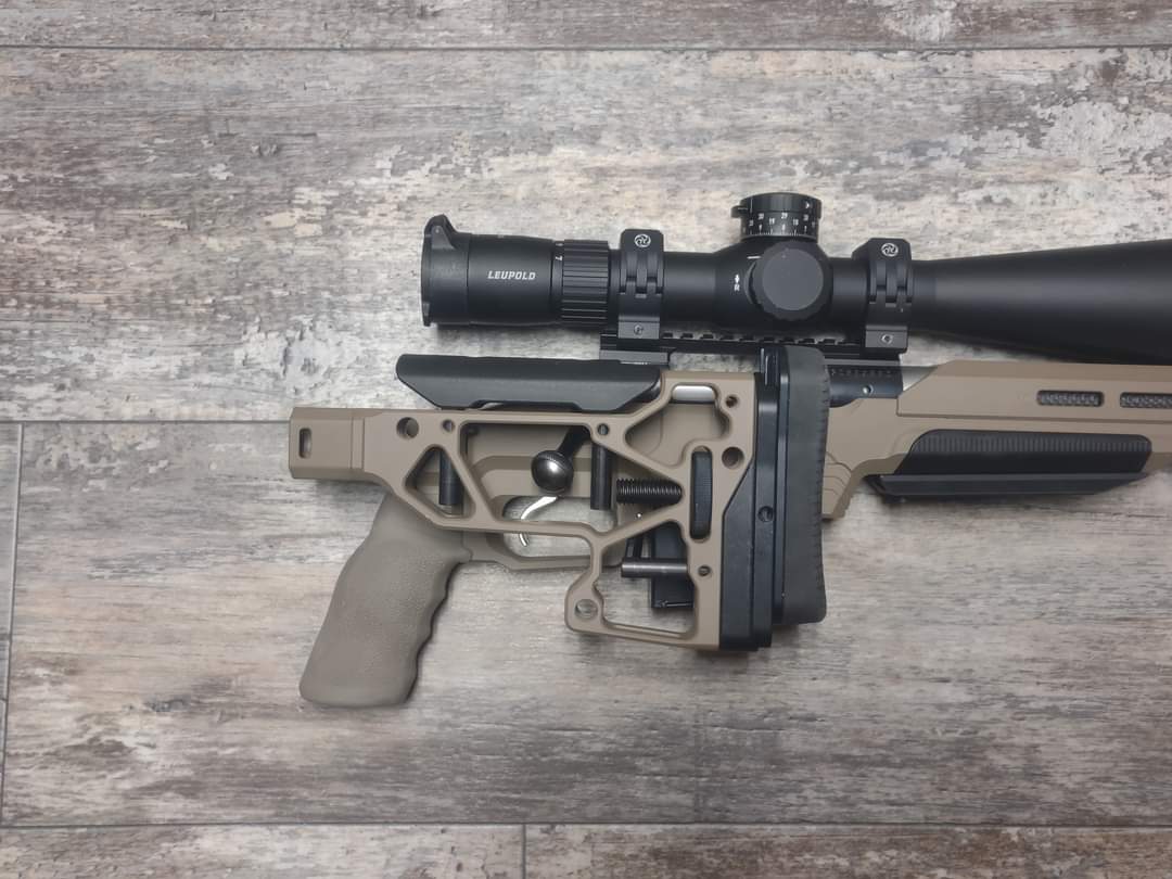

You have some really nice rifles. I have an FN SPR which I've always wanted to either put into a thumbhole stock or go with the MDT ESS as you have. Supposedly, you can run AI style mags without opening up the action if you use MDT branded mags in their chassis. For that very reason, I may end up going that route.
You are correct. For the MDT ESS, there is a little tweak in the rear of the mag to make...but it's nothing serious. Basically just a little notch to allow it to ride high enough that the mag catch engages the step on the back of the mag itself.
IMO, a small relief on the feed ramp is no big deal, but to others, it's sacrilegious. The mag mod is easier and it doesn't change it's use for any other AICS fed action.
Gotta take into consideration, we're making very minor mods to allow parts compatibility for things that weren't designed as a complete system.
The 7mm and the 6x284 both have cuts in the front of the mags, but neither one actually required modifications to the feed ramp itself. (something most recommend)
