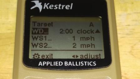

    I think I already know the answer to this but on this screen image (assuming I've already captured direction of fire) when I select wind direction and perform a "capture", it not only captures direction but also captures the speed data to populate WS1 & WS2 correct?
    affirmative. wind 'capture' grabs both a vector direction and WS1/WS2 values. WS1 = average speed, WS2 = max speed, over the period in which the capture button was held down.
    Got it thanks. Reason I asked is that apparently you can perform a capture in either the WD, WS1, or WS2 menus and it appears they all provide the same data
