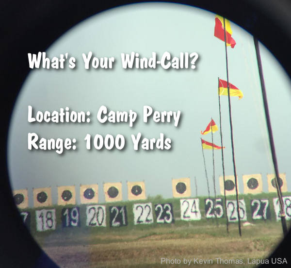

Flags tell you what the wind did. It will always lag, because air has to lift or move the fabric (heavy cotton or light nylon, it makes no difference).
Mirage tells you what the wind is doing. You are seeing through optics or naked eye how moving air is diffracting light.
With trees on either side of the range at Camp Butner, North Carolina, you can occasionally see wind flags on the right and left sides of the range all point toward range center at the same time.
