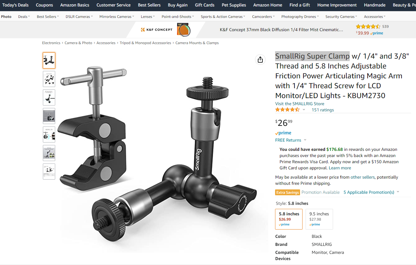

anyone tried on of these on the leg? -
SmallRig Super Clamp

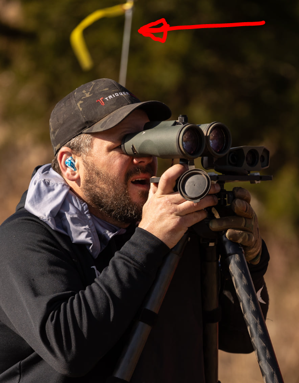

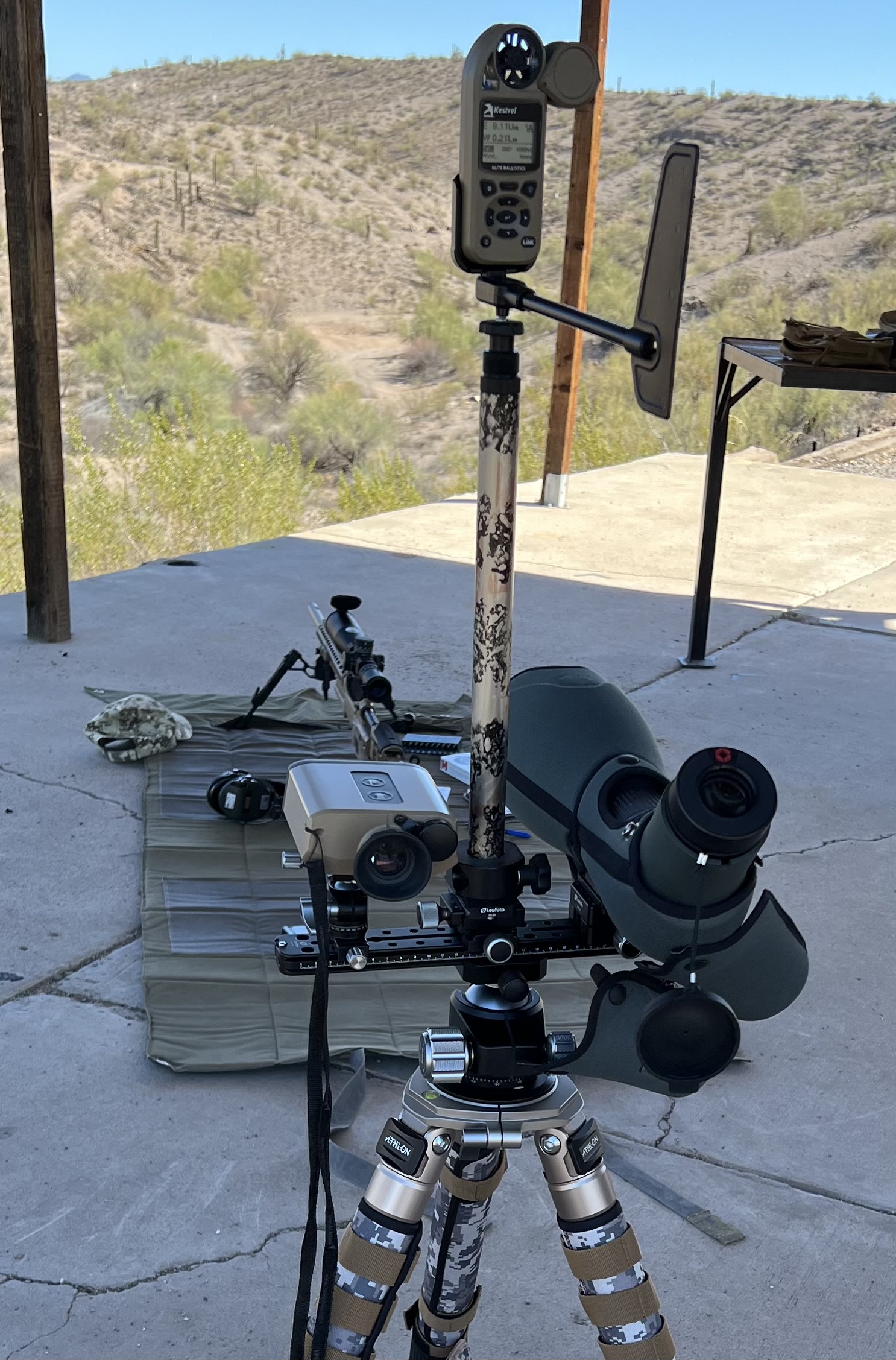

My setup this past season and into the next. I no longer use the coletac wind flag and instead, use a BR flag.
Works great and easy to disassemble and lightweight with the carbon fiber rods.
It's a slightly older picture. I use RRS 240mm (??) Cinema rail and RRS Clamps. Wiser mount for the HUD which I can easily transfer between rifle and tripod. Everything is assembled using ARCA which makes the setup highly versatile to add or remove stuff.

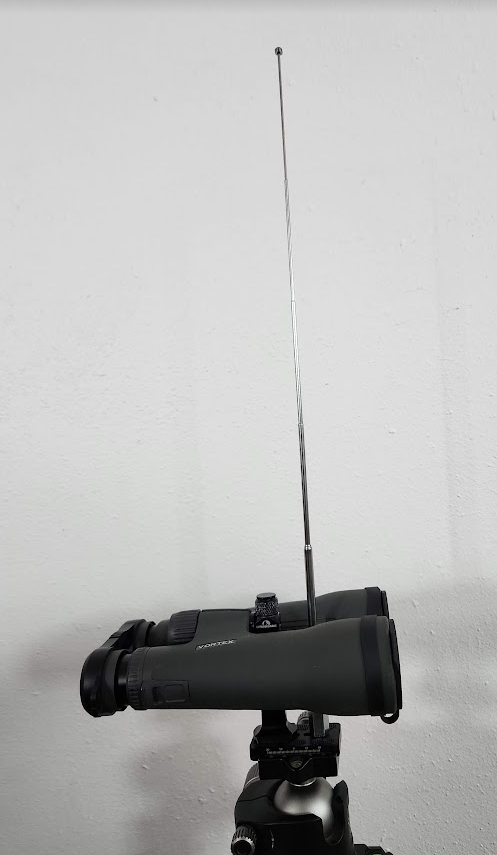

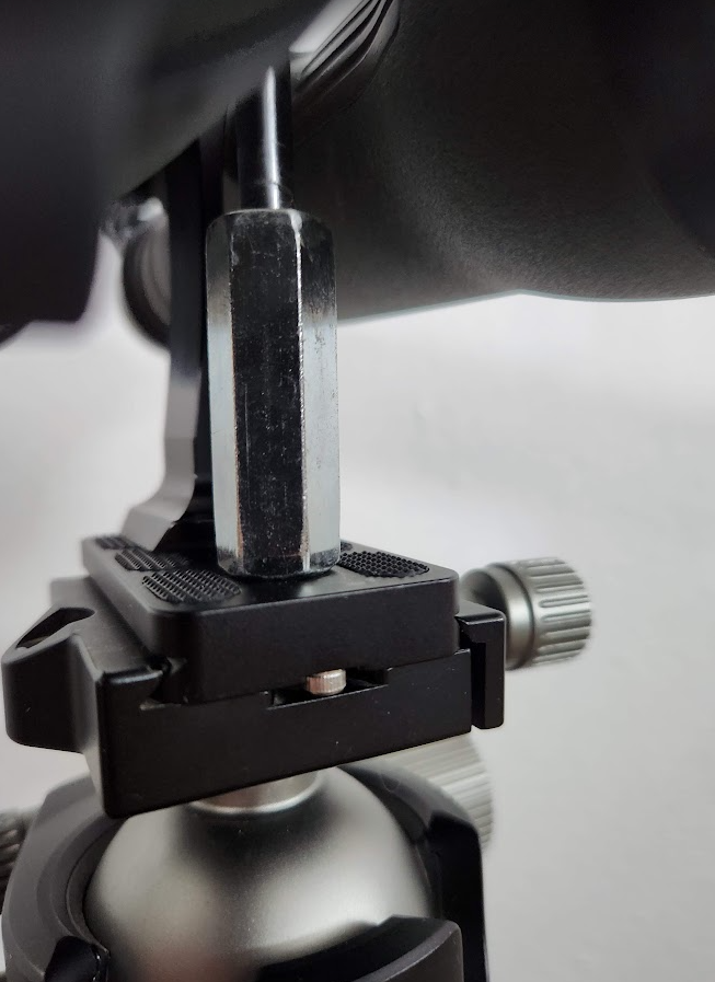

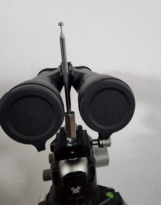

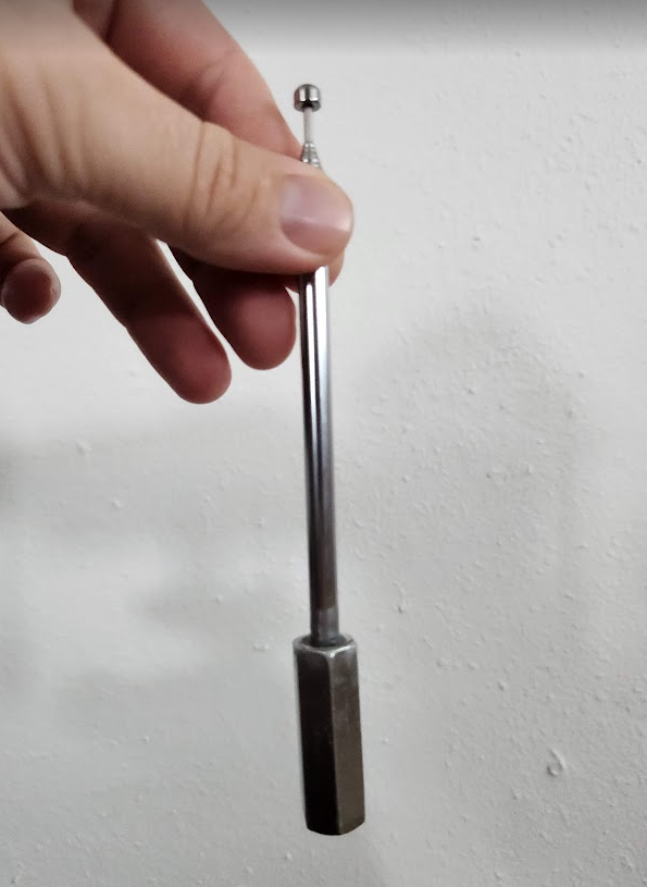

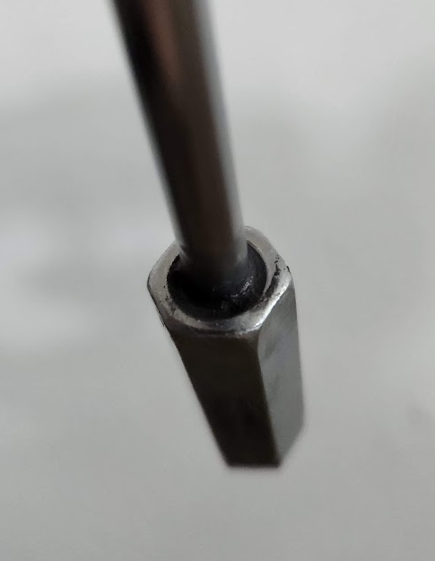

Well Fellers - Here is what I came up with. After studying, looking, analyzing and 13 beers here is my solution. I had to put a little biut longer arca plate on my spotting setup to get this to work.
Radio Antenna ($4 amazon)
3/8 thread coupler ($2 hardware store)
jb weld ($1)
Ribbon (free)
75 -100mm Arca swiss plate and screws - 1/4" plus 3/8" adaptor ($7 amazon)
I like the setup, but we'll see how it works in the field.

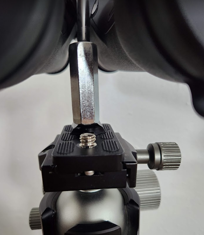

1. The flag easily attaches to, and removes from the spotting system. Just a quick couple turns and the 3/8 coupler is crewed on to the arca plate.
2. The antenna extends and collapses easily to move the tripod or be put in a backpack. The antenna also does not have enough rigidity to cause vibration in the spotting glass (yet to be proven)
3. I didn't need a big plate to attach it all to, I am not a fan of the "big rigs" (Personal Preference)
4. It cost $14 plus 13 beers to make.
5. This can never get in the way. Its always attached to the spotting glass and moving with it. Looking right, left, up down the flag can never be in the line of sight.
6. Bacon, because every list should have bacon.
jb weld ($1)
Ribbon (free)

Very nice. I like the simplicity.
I think your antennae idea is decent/clever.

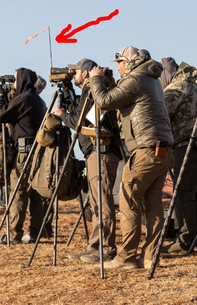

I bought a hinged, collapsing "Radio antenna" or "Pointer" wind flag like that off commercial Row at Camp Perry.
The base had one of those rubber half-rings that allows you to quickly clip it on or off a spotting scope stand tube or tripod leg. It came with some lightweight white yarn about two feet long at the tip to show you direction and velocity. You can use surveyor's tape to do the same thing.
The clamp was something like this:

Well @Jack Master how did your setup work this year? Any improvements needed?
This worked VERY well all season. The flag stayed out of the way like I had hope it would, it was always available, it colapsed for transport and removed easily for storage. I am very satisfied.
The only negative I had was one match with very high winds and the flag would make my glass shimmy a but more than without it. I took the flag off that day because it was pretty obvious what the wind direction was and the flag stood at 90Deg so it didn't help with speed.
My only upgrade would be a Calypso.. I shot a match where a fellow squad mate had one and it. was. awesome!! (more batteries!! Boo)
I got one of those clamps you posted. I put it on my carbon tripod leg and was fairly nervous to clamp it down hard enough to be immobile. I then took it off... clamping onto the carbon makes me cringe.
