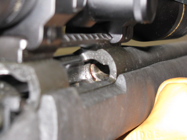

The brownish orange that collected in my barrels only did it in my chrome moly barrels and actions. No deposit at all in my stainless guns. The "plastic" residue once removed also left pits that are visible in my 20 power bore scope. Left long term is also pitted stainless bolts with no color other than the pits. If it indeed was plastic from the cans it would show on every patch. Not just the ones from prolonged soaking. I'll pass on Wipeout.

I posted pictures of extensive rust damage to my new Rem MLR 700P 338LM. I have pitted Bat action bolts and my Weatherby bolts's are all stained up like they were left outside. Wipeout is not a rust preventative at all.
This left pits from this overnight soak. Stainless guns done the same day did not get it.

That trash accumulated overnight every night until we quit using Wipeout. The stainless guns took weeks to pit. When you pit up a couple $7000 customs and 3 Weatherby's you might be a bit soured on it too. I still use it from time to time to test with but am super dilligent on getting it all out. Bore Tech Eliminator is my solvent of choice now. As a gunsmith I believe I have about all of them on hand. I even have Warthog which will etch stainless in just a few minutes.

Did you call the manufacturer about the pitting? If so, what did he tell you?
I have to say, I've left Wipe Out in various bores for days at a time and never got any pitting. The rusty looking residue, yes (as shown in your photo), but no pitting. However, the residue I got came directly out of the can (from only one or two cans out of several that I bought). Also, I've noted a similar residue coming out of the red straws that Wipe Out includes with their product.
It all started when some customers we had built rifles for brought in their rifles to examine the pits did we finally put together the common denominator. Then I went into my safe and found the stains and pits in my own rifles. Previously I always thought, well we must have missed some water or something. The final straw was the MLR rifle putting out the never ending brown patches and then rusting heavy overnight. I called and they said it was not possible even after looking at pictures I sent them. They recommended that we use a good oil to help protect our guns even though it says you can use it as a rust preventative. We ran further tests and it is certainly no metal preservative. Since then we have had pretty good luck with the Bore Tech Eliminator for soaking but it to will rust if left long term. (6-12mo) No replacement for a good oil protectant.
