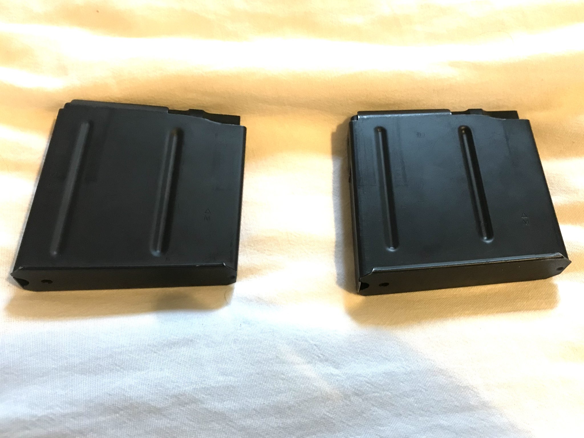

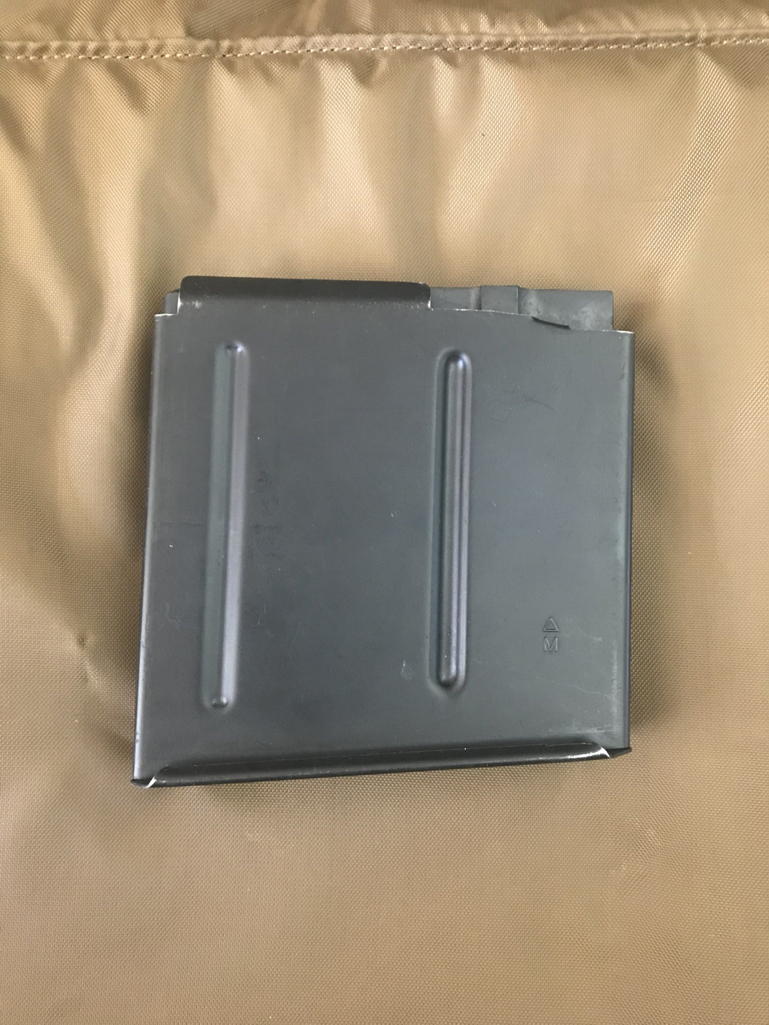

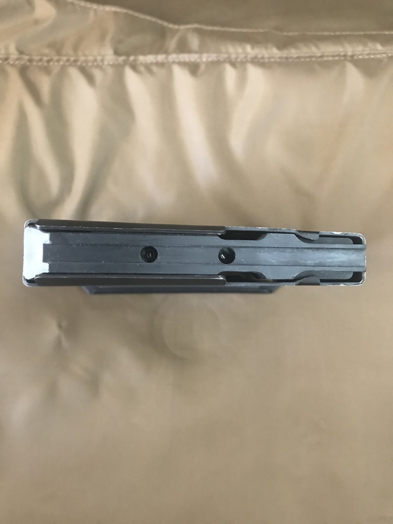

    You should describe your feeding problem in some detail. Maybe show a photo of each cartridge type in the magazine, top-down view. The solution could be as simple as tweaking the lips of your magazine(s).

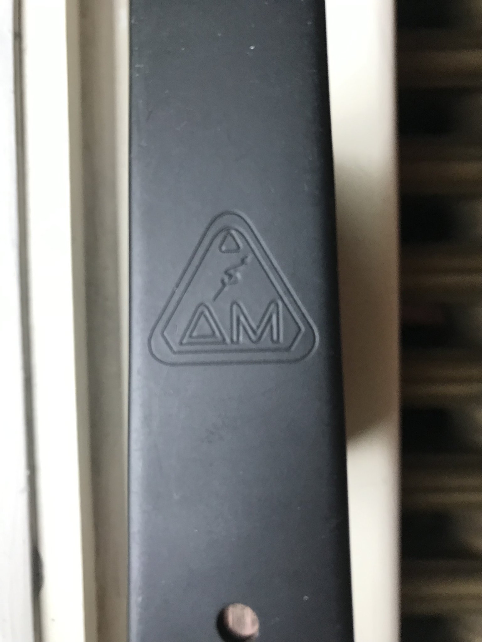

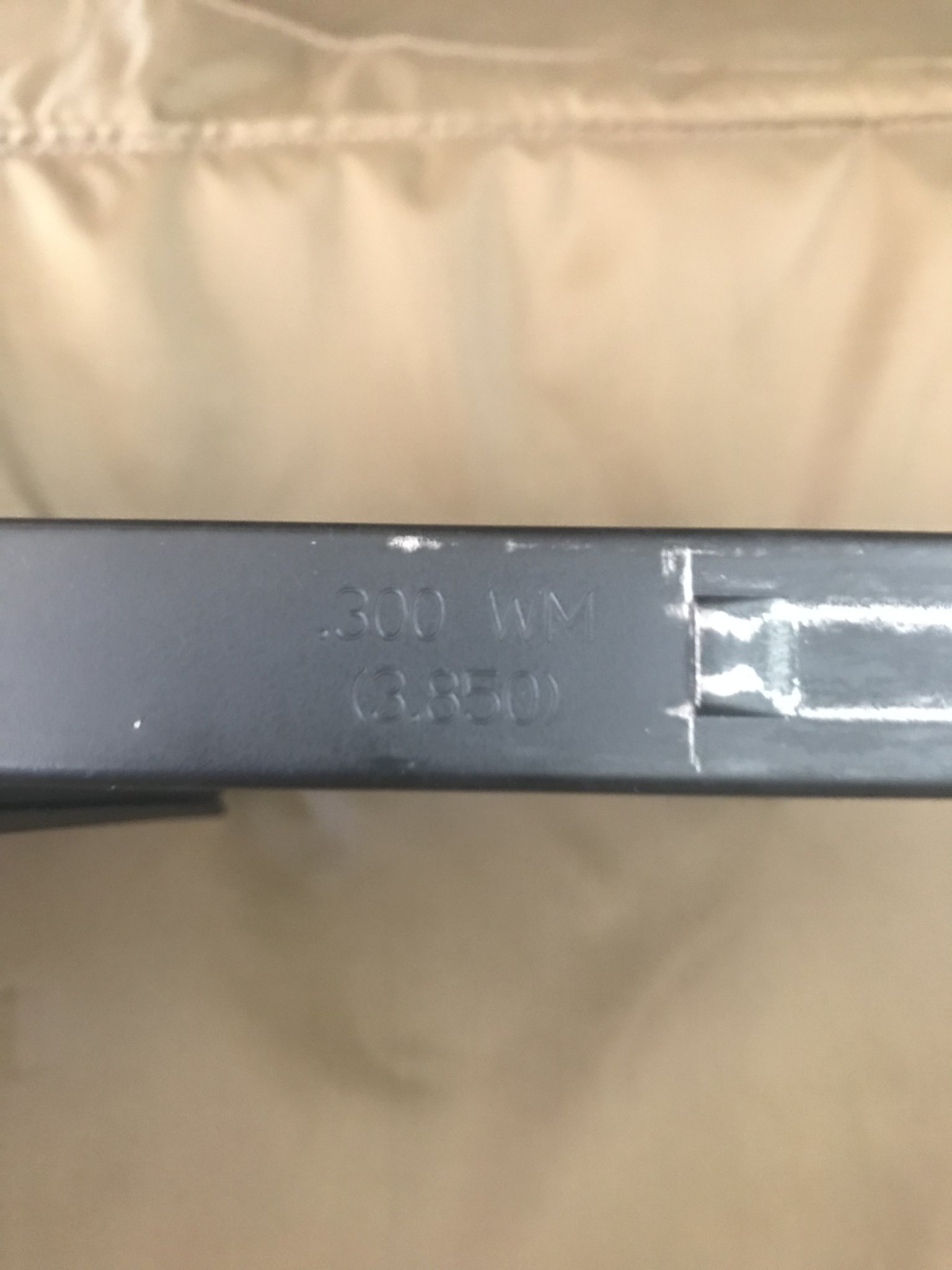

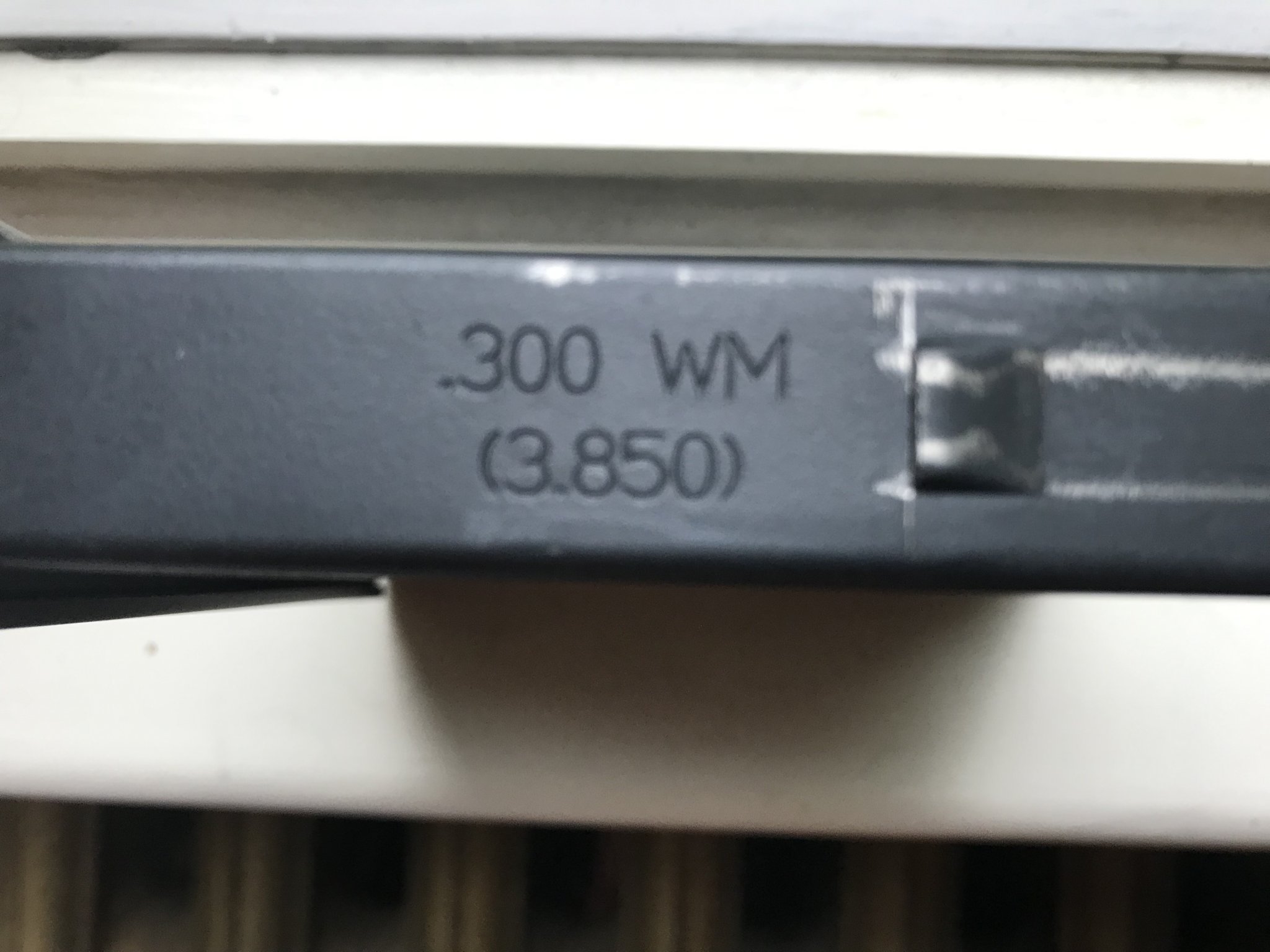

    I just looked to see if I had any pics but I don’t. Would have to reassemble the barreled action into stock to recreate the issue.
    The bolt would not strip the round from the magazine to lift it into the chamber. Even if you were aggressive, it would just chamber empty as the bolt would close with no round. Mags are 300WM CIP (3.850”). That’s what was in the package with the barreled action.
    To be honest, I didn’t like the feel of the KRG Bravo stock anyway. Need to figure out if I want to stay 300PRC and find a chassis that works or go 300WM, sell the stock and either trade or sell the 300PRC barrel for a 300WM.
    I’ve attached some pics of the mags, not in the stock though.

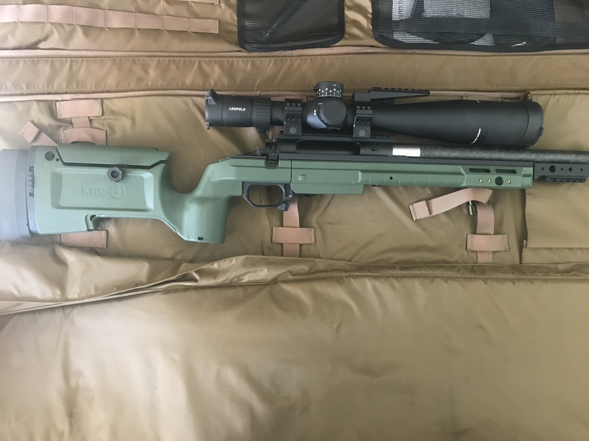

    Picture of complete build. Obviously doesn’t illustrate the problem, but for reference nonetheless.

    Eh, fair enough if you're not stoked enough about the Bravo to solve the problem.
    For future reference, however, I have had excellent results with the Masterpiece Arms magazine feed lip tool (depending on the underlying cause of course):

    Almost necro posting, bu here goes...for posterity... i have a 6.5 prc that was born a 6.5 creedmoor with the same feeding issues. The feed lips were adjusted by seperating the gap to be slightly wider and allow the prc case to sit higher in the magazine and now it srips it from the mag no problemo
