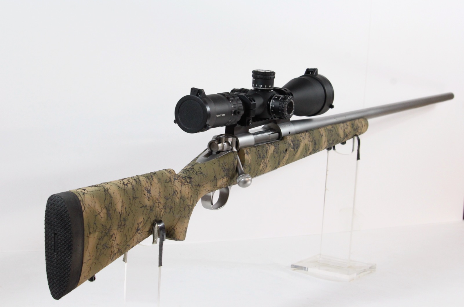

    I ended up going with the 300 Win Mag - it is classic and I know other options exist (as you are discussing) but I liked staying in the .30 Cal bullet category as I own many .308's too.
    I also found a Model 70 Classic Sporter (with the Jewled bolt etc.) for a great price that was awesome and just needed TLC - so I cleaned it up and went with a new stock and have the .300 Win Mag Hunting rig I wanted.
    Good Luck!
    Good Luck!
