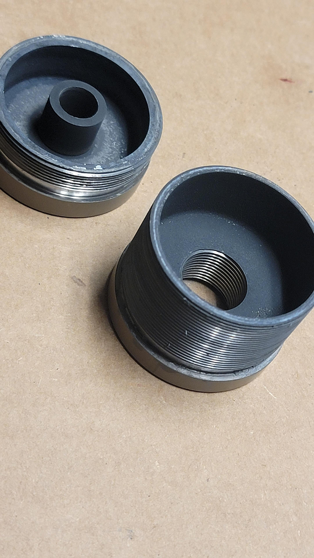

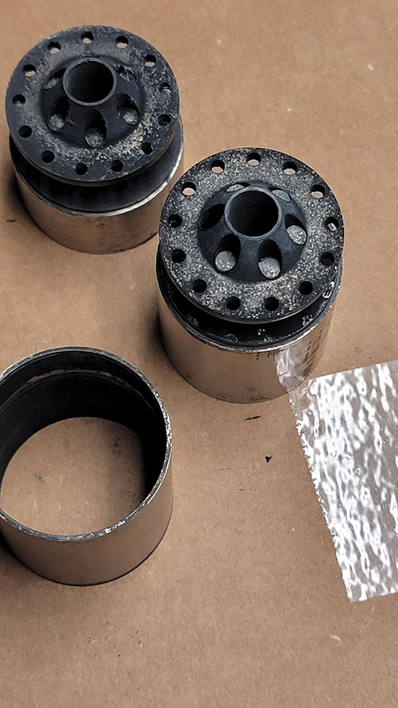

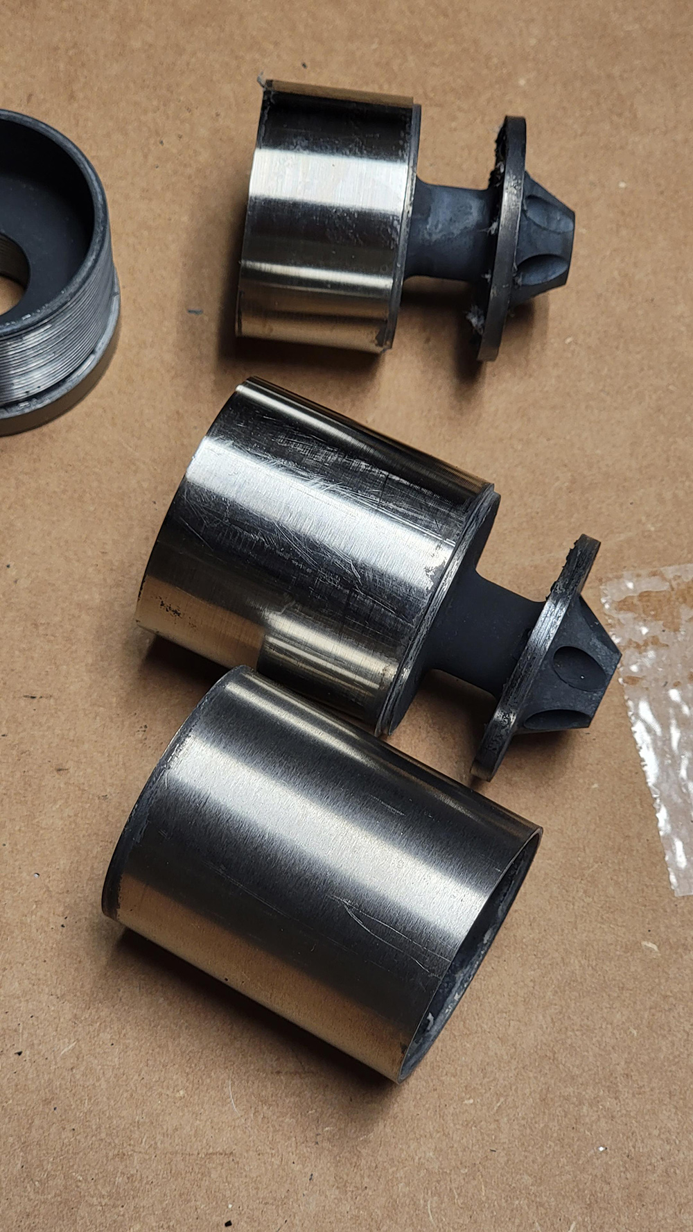

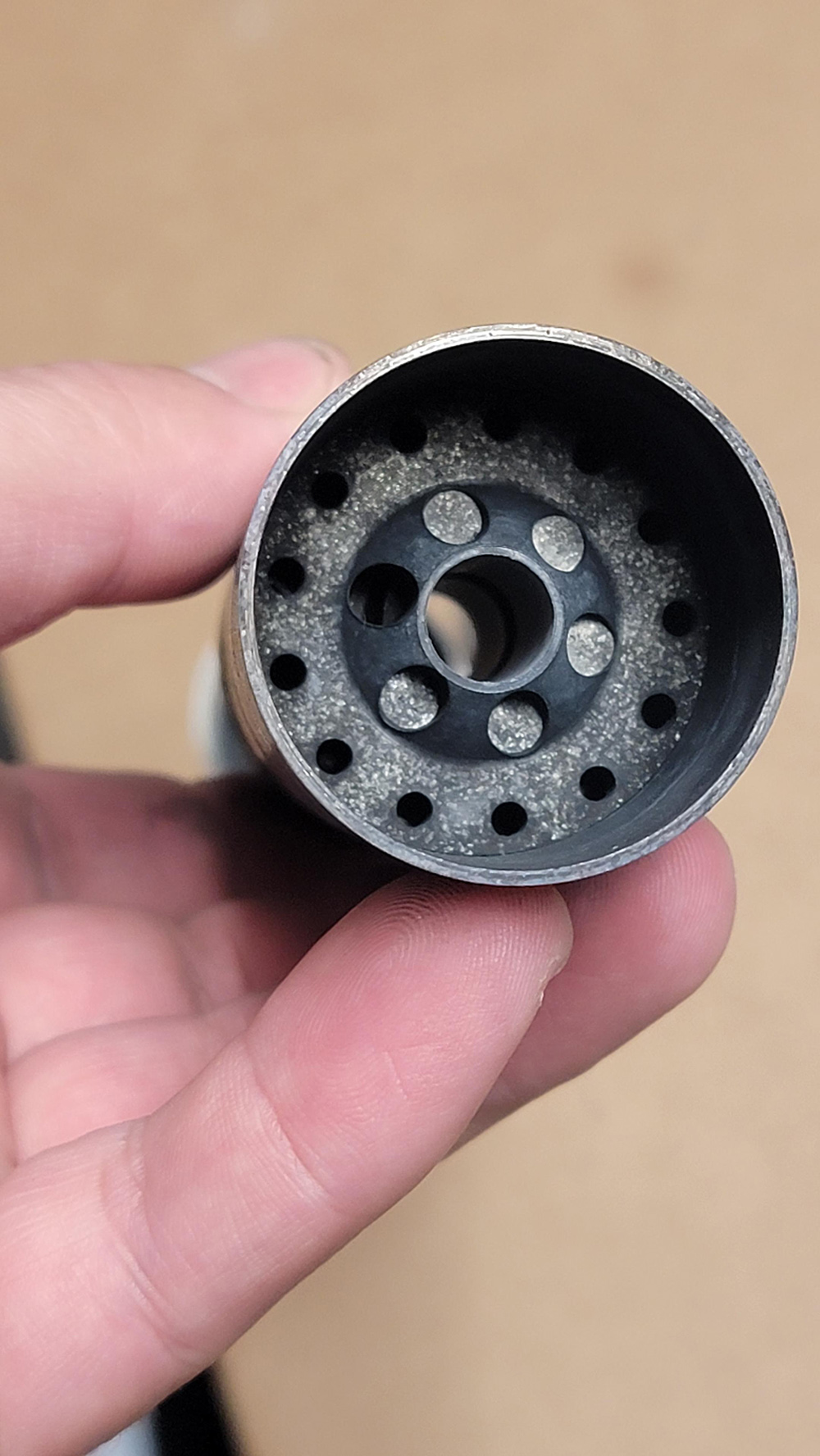

This is the machining quality i speak of and my ears were ringing after shooting 5 rounds and was way louder than my SICO hybrid even though witt claims is quieter.

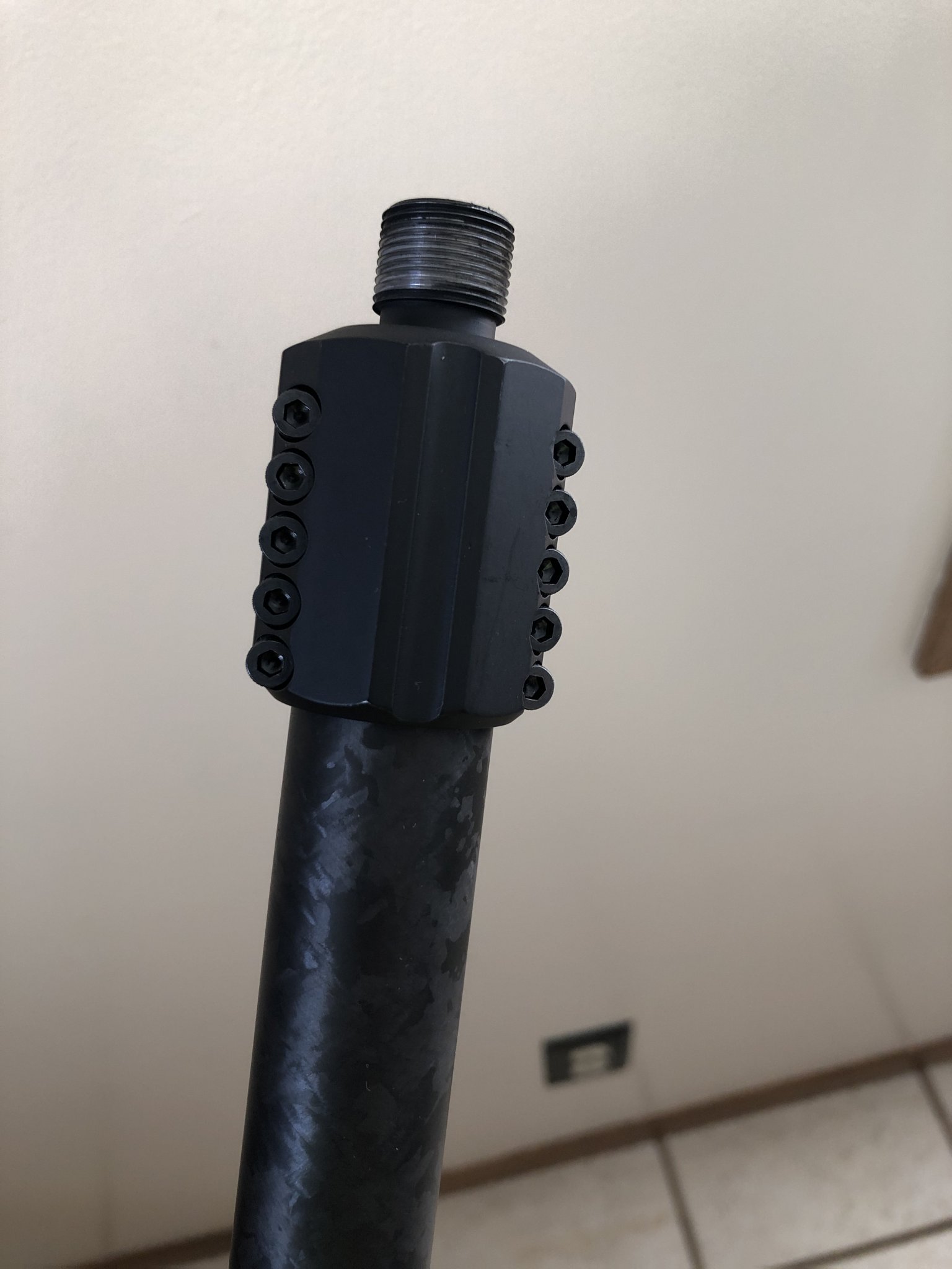

I would never trust a clamp on thread adapter how are you every gonna get it strait? no way in hell i would put my can on one.Wish I had seen this a week ago! Ordered a clamp on thread adapter from them. Sure hope it lines up better than that

Yea quality like that is hard to overlook. Even the little things have to be right even if it is just aesthetics.View attachment 7228817

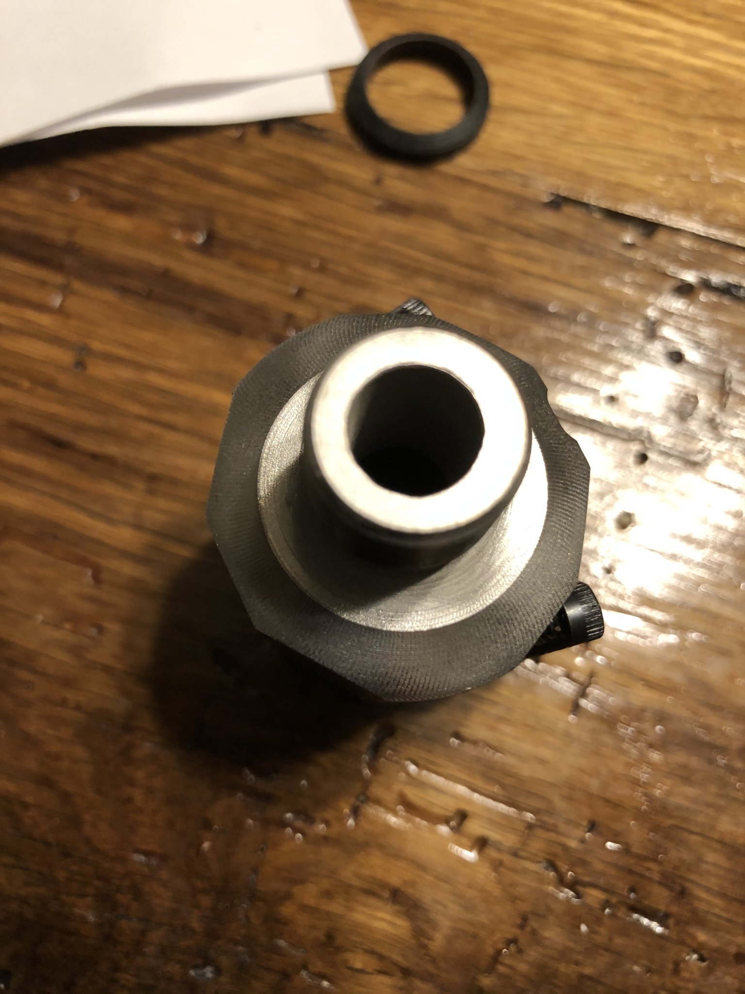

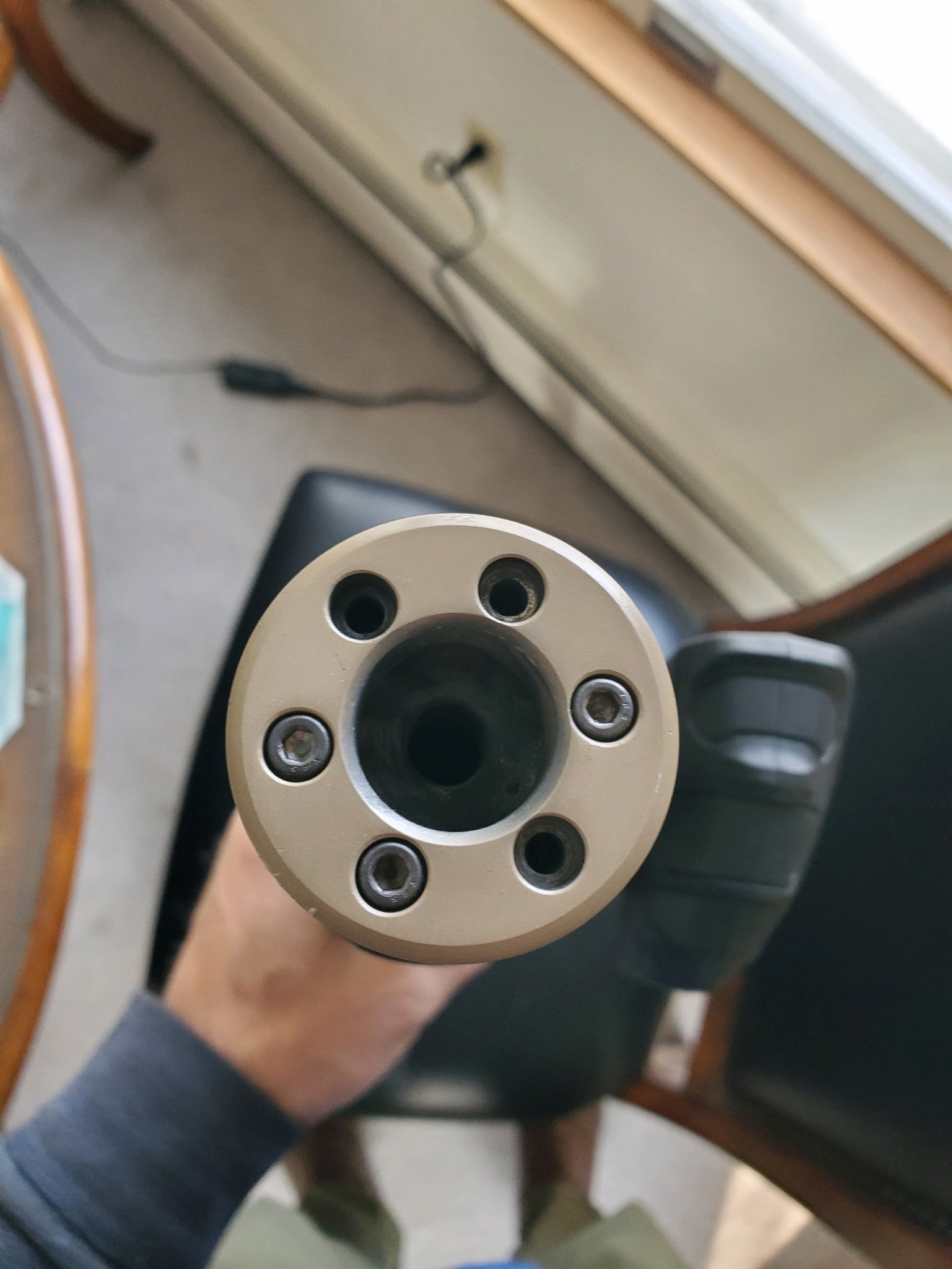

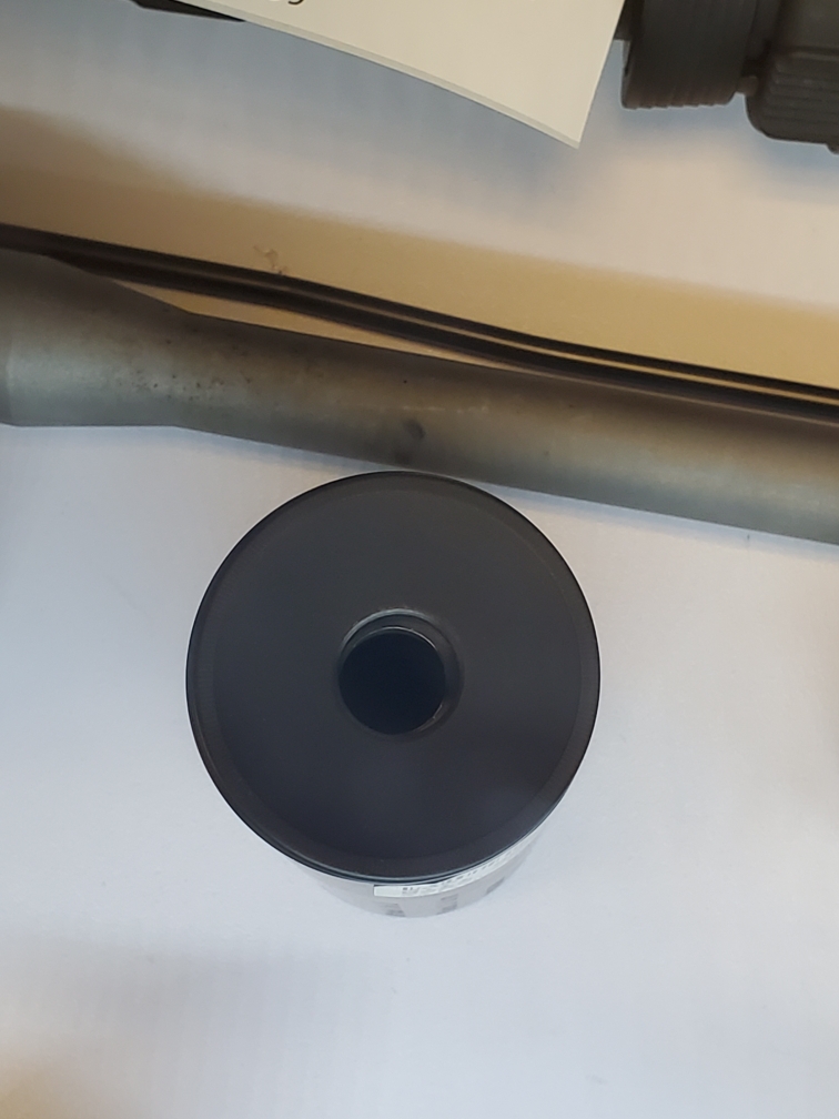

Anyways, I received the parts I ordered in about 2 weeks. The muzzle brake looked fine but the muzzle clamp adapter came in with a surprising concentricity error between the threads and the hole of about 11.5 mils. Considering the questionable barrel alignment added by the clamp section and the resulting muzzle break tilt, the total error is very likely to lead to a bullet hit before leaving the assembly.

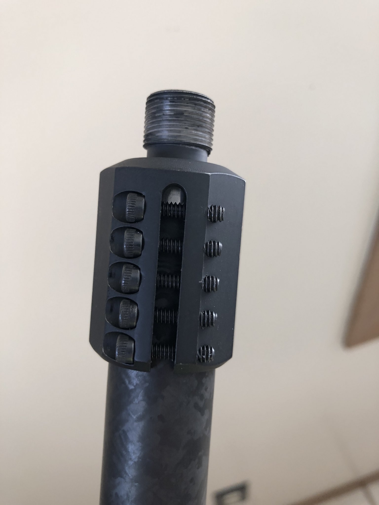

After attempting to install the muzzle clamp adapter on the rifle so I can measure the assy compounding concentricity error, to my surprise it did not fit onto the rifle barrel either. Even after reversing the clamping screws as instructed to open the clamp as much as possible and forced it in with a plastic mallet, the barrel stopped about half inch from bottoming out into the clamp adapter. The screw heads also rub into their seats stripping away the ceramic coating.
Before returning the product and add to the bad reviews I found on the exact same issue, I decided to further analyze these 2 issues and give Witt Machine a fair chance to fix them. I found that the barrel fit issue was a result of a fundamentally wrong way to measure the rifle barrel end section as instructed, which is not only insufficient to describe the true muzzle shape/geometry, but actually detrimental. Although not obvious to the naked eye, the end of the barrel on my Remington 700, and I suppose other rifles owned by so many of the people that report with similar complaints on being unable to fit these clamp-on adapters, is not exactly conical to only require 2 measurements (at muzzle end and 1.625" deep), but it is actually rounded off towards the end, creating a curved outline. That would require at least 3-4 measurements along the 1.625” barrel end section in order to properly describe the true muzzle shape.

Given the experience, I am not even going to send the part in for refund because at this point I am not sure how this could end. I own a lathe and decided to take a stab at fixing this myself rather than pay return shipping and continue to deal with this company any further.

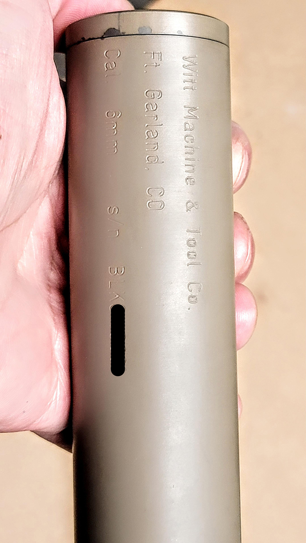

Here is a review of some suppressors from Witt machine. They do reduce the sound signature, so I guess they are- technically- suppressors, but they're not making the gun anywhere near hearing safe...
