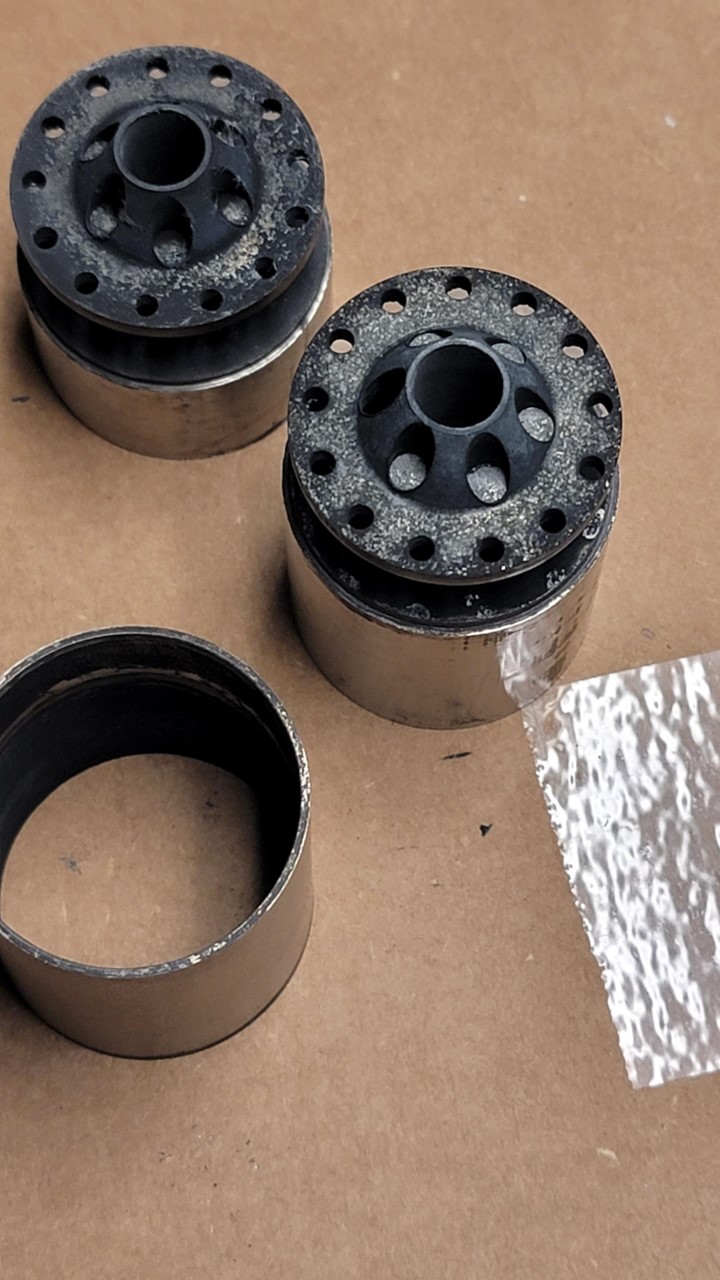

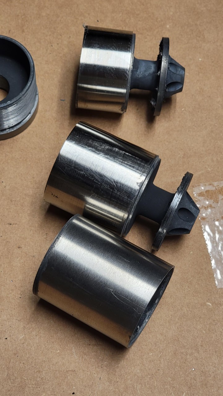

Here's the two "baffles" and the spare inside tube they used for a blast chamber. You can see the burrs from drilling the holes in the baffle.

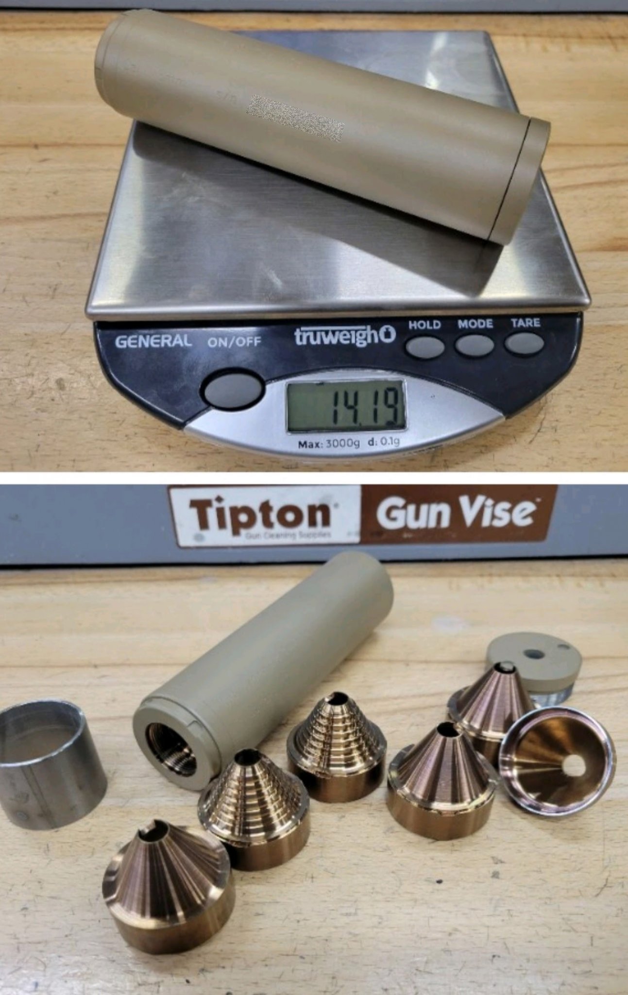

Here's the new parts from ECCO and the fresh cerakote on the tube and end caps. I had them put a new "Cherry Bomb" mount in it and decided to use it strictly for 300blk and 223/556 AR's and I was very happy and it was well worth it after the shit show with Witt's "design".
