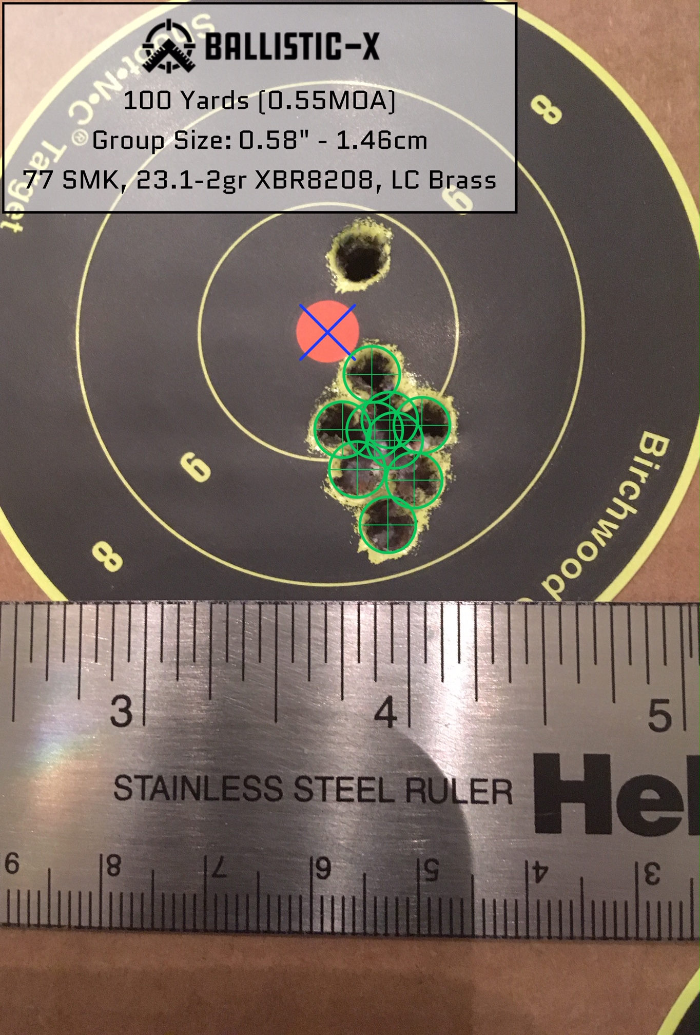

@Swingpress is there a specific reason you are looking at the 22"-24" models?
I picked up a WOA 18" SPR barrel from Brownell's this Fall as did a good shooting buddy. Both WOA SPR barrels been super accurate with both 55gr VMax over CFE223 and 77gr SMK over XBR8208. For some reason WOA barrels do NOT like the 73gr Hornady ELD'm but they do like the Hornady 75gr BTHP. I will be buying another WOA SPR barrel forfuture builds.
