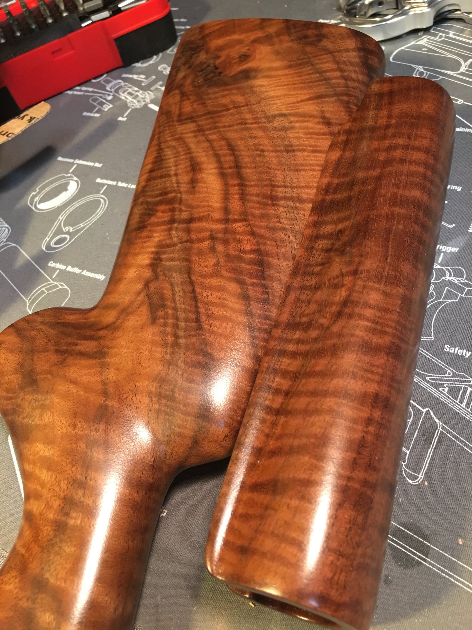

Thank you, those two turned out really nice. I’ve refinished probably close to 50 stocks over the last 15 years, and those two are ones I’ll never let go.

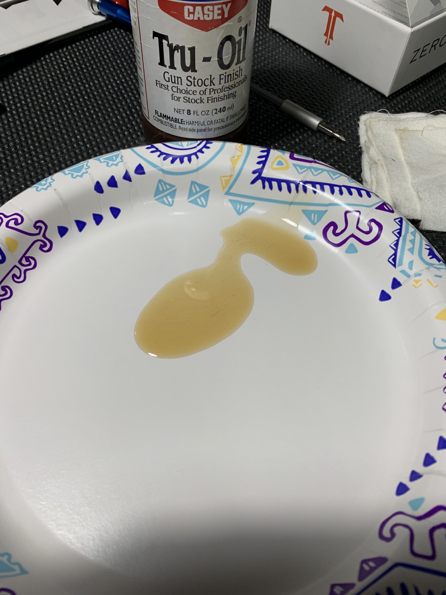

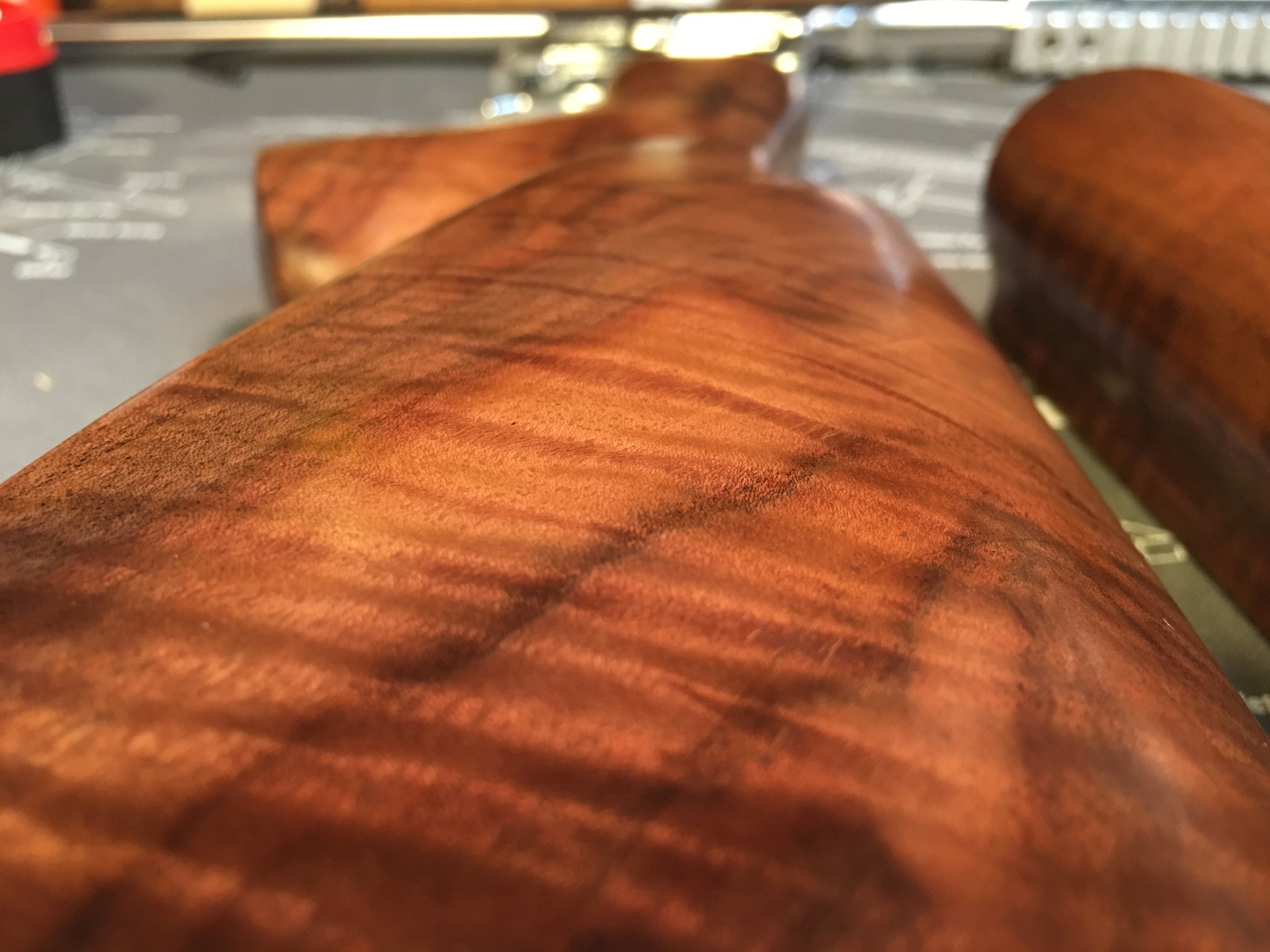

Here’s tru oil straight out of the bottle, the brown/amber tint to it gives a yellow cast once dry. It looks great on certain stocks, but on highly figured wood, such as that claro walnut 870 stock set above, it would have completely muted the gold hues in the wood. If you’re trying to preserve the true color and figure in some wood, lacquer is a better choice since it’s absolutely clear.
Tru Oil will give a glossy finish, but it has a yellow tint to it...so depending on the wood you’re using, you may or may not want that. You can knock the sheen down a bit with scotchbrite pads or steel wool, but that takes away from the clarity a bit.

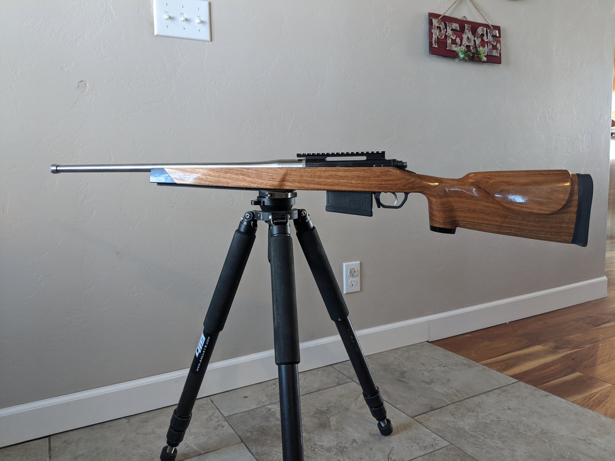

This stock is finished with tru oil, both aerosol and hand rubbed. The aerosol is basically the same thing, just thinned out more with mineral spirits. It’s easier to build up the base coats with the hand rubbed oil and final coat with the aerosol, I wet sand in between coats with 1500-2000 grit automotive sand paper.

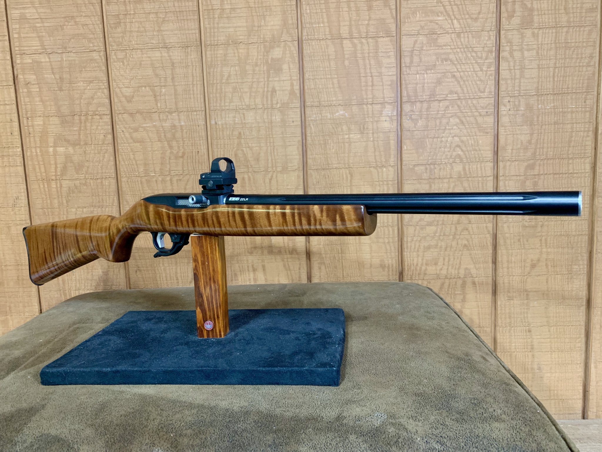

I finished this shotgun stock with the matte minwax lacquer.m. I didn’t want any tint to hide the character in the wood, nor a super glossy finish.
