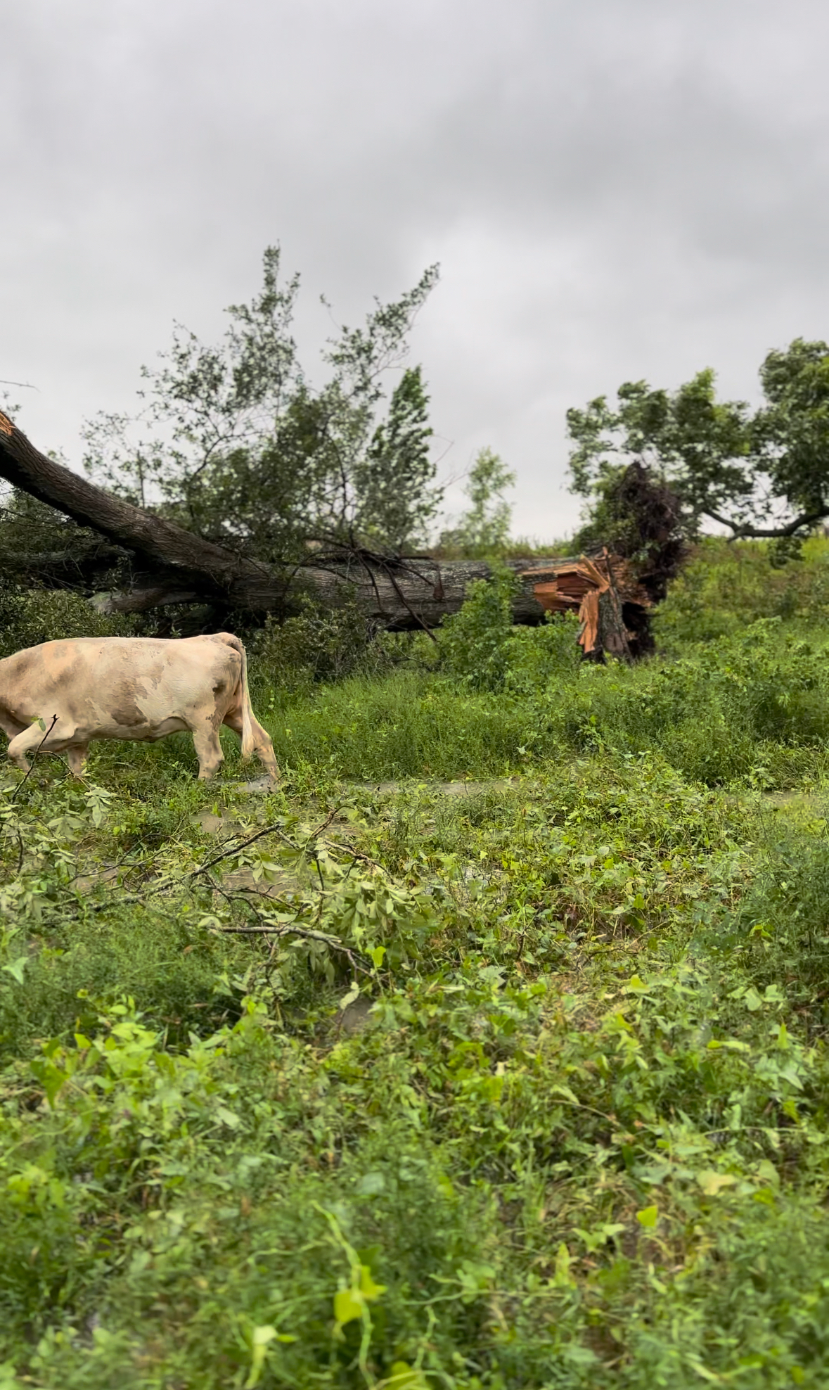

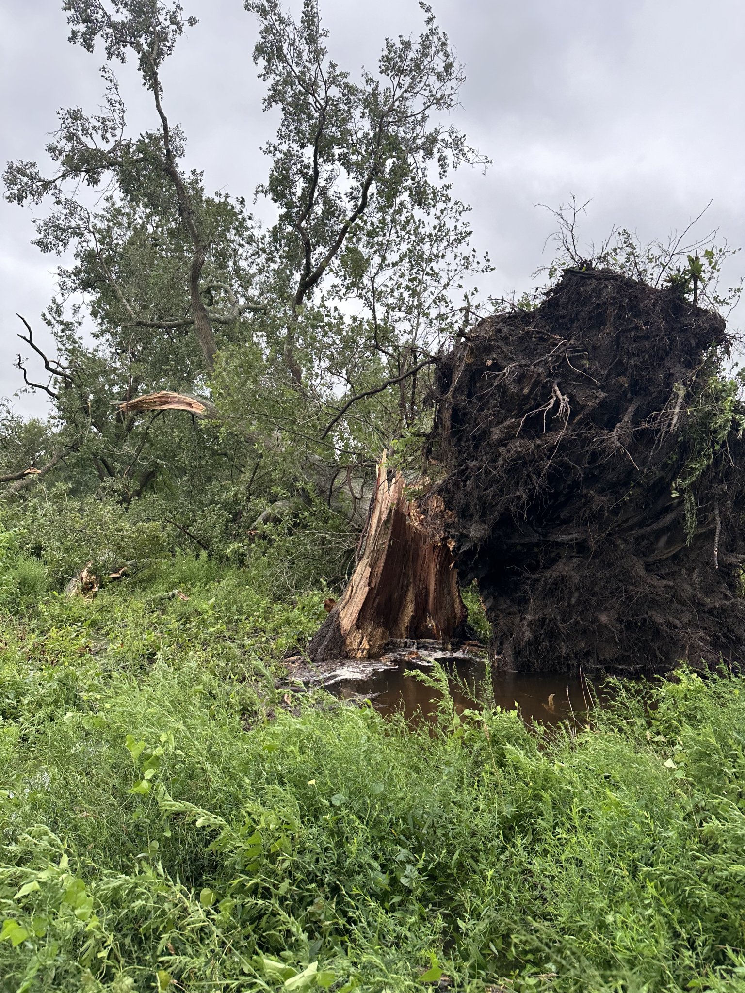

Well hurricane Beryl did a number on some of the bigger trees at the back of our property. I've got two pecan trees that were 150-175' tall that are down. It seems like a damn shame to cut them entirely into wood for the smoker or chip them in place.
I was thinking about trying to cut the trunks into live edge slabs and make a table or bar top. I've got a buddy who has a sawmill, have access to equipment that can move them, problem is I have no clue if what I'm look at is a suitable candidate for cutting into slabs. I don't see any rot in the centers, ground was saturated, wind speed was too high and down they went.
What do I need to look for before taking the time to haul them out of the bottom?
How should I go about storing them before we cut them into slabs?
How long do they need to dry?
What else am I missing here?
Much appreciated.
if it cant be a table I'll use some portion of it to smoke the cow in the picture

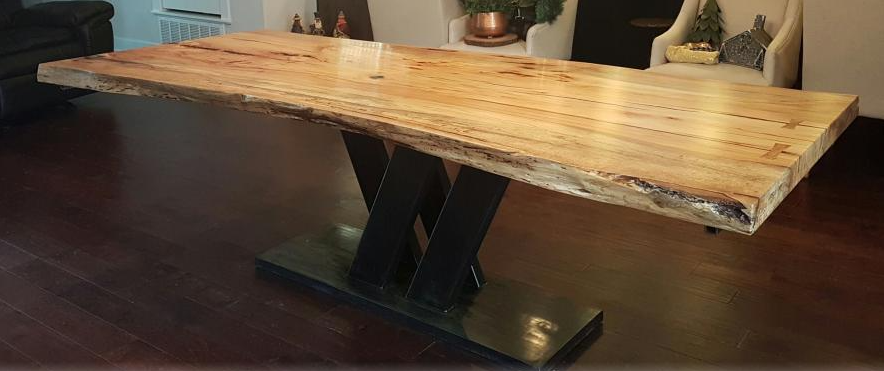

Maybe something like this:
first it to figure if the tree has enough width for your planned project. I’d recommend cutting the tree where you are able to get the longest straightest section of the trunk. If you want let’s say a 8 foot table over cut the section to around 10 foot or so. As the tree dries it may produces checking and having a longer section than desired may give you the ability to cut off the checking it it happens. To store the log before cutting into slabs you want to paint the ends with a latex paint. May need to do several coats. Put in in a place where you can cover it. When cutting the slabs, you want to make sure your 2 center slabs are on either side of the pith of the tree. Air drying slabs is roughly 1 year per inch of thickness to get moisture content around 10-12%. Example a 3” slab would take roughly 3 years to dry. Once you have your slab cut, keep them in order and place the first slab off the ground and place stickers(1x1 wood strips) every 16 inches down the board and then place the next slab on top of that. Repeat the process for each board. You want there to be air flow around and through the slabs.
The reason for keeping the slabs in order as you cut them, is if your tree isn’t wide enough for say a 40” table, then you can book match two consecutive board together to achieve you desired width.
Kiln dried vs air dried is a personal preference. Kiln would be faster but you would need to find a place that does this regularly or you may end up with a piece of firewood. Plus there would be added expense. Air dying gives the wood better color and workability and makes wood more
stable. Kiln dried wood will lose some of its color.
