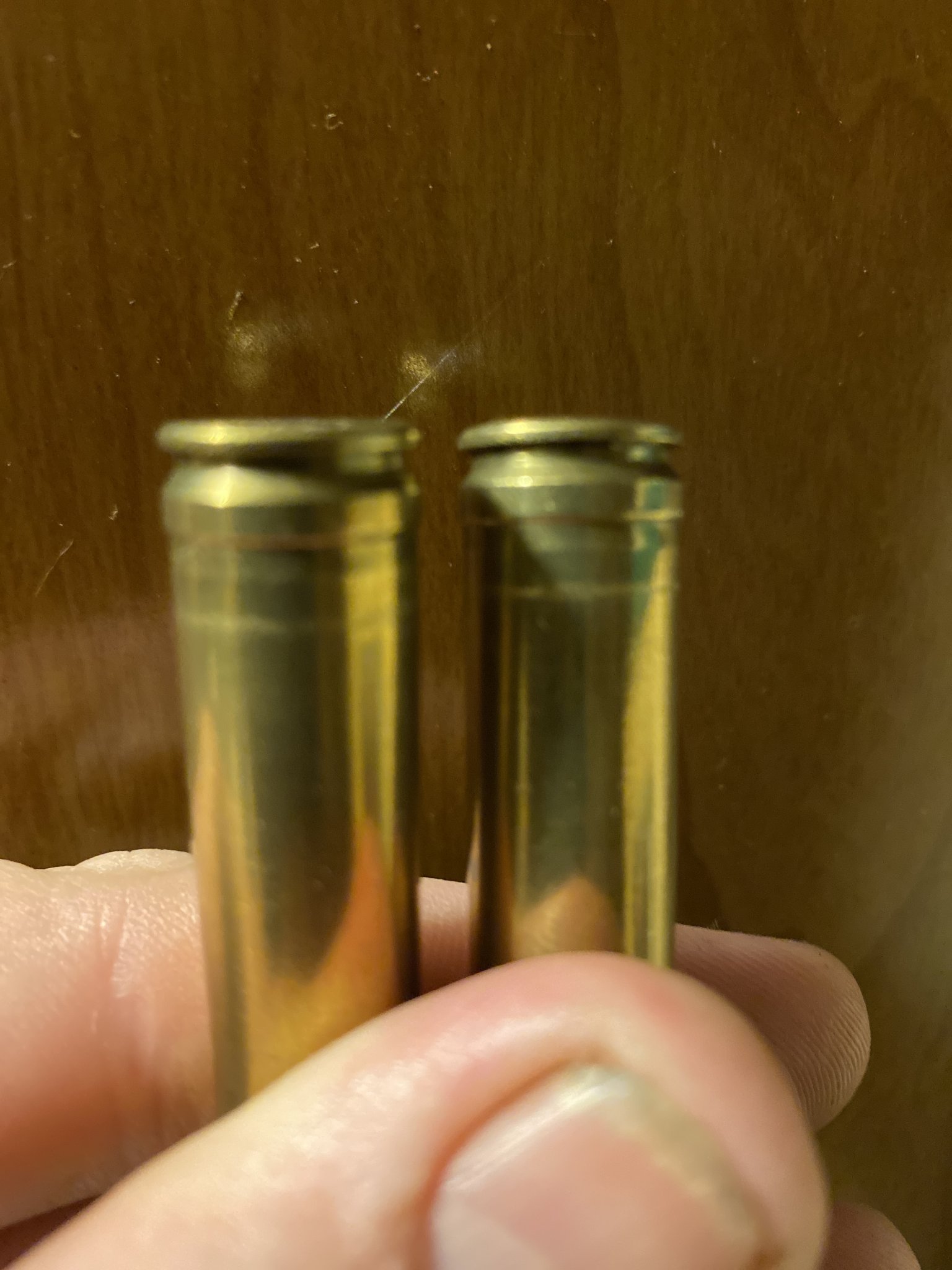

Worn out brass?
blues2o
Feb 15, 2017
53
30
I have Hornady 300wm brass with 3 firings on them. I found 2 with sings of head case separation. Do you just cull the suspect cases or shit can the whole lot?
  • Wow
Reactions: Snuby642
throw them all out and buy better brass.
You can use a paperclip or something similar to check the inside of the cases for case head separation signs on the other pieces but I wouldn’t bother, just chuck them.
You will need to restart load development as case capacity varies among the different manufacturers…
I get rid of the entire batch. You can check each individual case but its difficult to make sure you did not miss any
and if one has a major failure it may ruin your day.
I was hoping these would last till lapua released there 300wm brass. But for peace of mind I’m going to trash them just thought I would have gotten a few more firings out of them. I got Hornady 308 win brass with 8+ firings.
I have Hornady 300wm brass with 3 firings on them. I found 2 with signs of head case separation. Do you just cull the suspect cases or .........?
One has to ask why the cases are about to fail with only 3 firings. The first thing that comes to mind is that your sizing die is set to push the shoulder back too far with respect to the rifle's chamber. A magnum rifle's chamber is often about 0.016 inches longer than new brass, so repeatedly sizing the brass back to factory specs results in early case head separation.
Setting your sizing die to push the shoulder back about 0.003 inches from the fired case head to datum length will result in longer case live.
If you do not already have a comparator and caliper to measure case head to datum length, I suggest you get them.
Might want to check your headspace.
Ideally the belt keeps the case held back against the bolt face but if your headspace is off it’s just like an non belted case blowing back instead of blowing forward as the belt is intended to achieve.
Cut one in half lengthwise with a dremel to see exactly what is going on then pitch the rest. Like others have said check with go/no-guage then check how far you are pushing those shoulders back. I shoot for .001-.002”.

First, use a probe inside the case to see if you have stretching and incipient case separation. If so, you have a headspace problem.
If not, and the raised ring is just a bulge, try a collet sizing die for belted magnum case bodies:
"The main problem with handloading the 300 Win Mag is case expansion that occurs at the pressure ring "just above" the belt. Conventional resizing dies can't properly resize any belted magnum case in this area. These cases soon develop a slight "bulge" around the case (usually after just 2 or 3 firings). When that happens, these cases will begin to stick in your chamber or they will fail to chamber at all. This is a very common symptom when reloading belted magnum calibers. Handloading the 300 Win Mag with our Belted Magnum Collet Resizing Die will increase the life of your cases and insure a perfect fit in your chamber."
Link: Sizing 300 Win Mag cases
My experience with Hornday 300wm brass is the pockets usually go first, so I agree with txtaxman's suggestion on resizing. Getting it sorted before Lapua arrives is a good idea

No need to probe the case. Those pics indicate ichs. I have gone through a gang of Hornady 300WM brass and when they ate about to fail they look just like the pics. I’ve sectioned them and confirmed it. Probes don’t do shit.
Reactions: LR1845
RCBS Case Master has a probe that is used in conjunction with the dial indicator to identify cases as being normal or showing signs of pending case head separation. No need to destroy cases needlessly.
Properly adjusted sizing dies set to only bump the shoulder a minimal amount will extend shell life. If the case is tuff to chamber than the Larry Willis die mentioned above will size the case just above the belt where normal sizing dies don't size properly. This sizing will allow the cases to chamber smoothly again.
I use the Hornady comparator gauge and bumb the shoulder.002-.003. And check them In the Larry willis collet die. I have 100 virgin Hornady cases I’m going to prep and try again
I don’t really know I’m going to track that on the new brass better. I also am thinking to anneal befor the first firing?
On a belted case with proper headspace it doesn’t really matter because in theory the belt keeps the case against the bolt face letting the soft part of the case blow forward as intended.
case head separation is from the firing pin and/or ejector pushing the case forward excessively and the harder head of the case blowing back under pressure stretching the case at the weakest area where the wall transitions to the head.
A simple but surprisingly useful trick is to put a layer of clear packing tape on a cartridge base, each layer is approximately two thou and you can see appropriate what your headspace is without tools.
That’s one mechanism causing chs. Another is the force of the combusting powder pushing against the shoulder and pulling the case walls apart. If you bump the shoulder too much it will cause premature chs.
On closer inspection the 100 cases have been in two 50 case “lots” and have been kept separate from new one lot of 50 have 4 cases with sings of chs. While the other has no signs.
Both have 3 firings but I’m thinking one lot may have been more spicy than the other and my notes only show the 100 case lot number used not which “sub group “ of cases I used.
Sure doesn’t seem that way when blowing out wildcat cartridges.
I suppose if you let your brass get rock hard and really push the shoulders back but you’d quickly find brass is so hard you have quite a lot of fun trying to size it.
Now let’s look at the position of typical failure, if case was held back properly the failure point would be up at the shoulder area but instead it’s at the classic area where the thick base cup meets the thinner wall.
It does work that way in 300WM.
