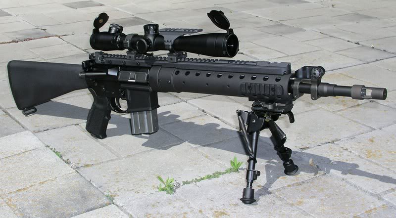

Back in the day I built a SPR MK12 MOD0 as close as I can get it. Since I was young and trying to save a few bucks and had a hard time finding some parts, I went with a WOA SPR barrel. Now I only mostly shoot at 100 yards because the range I go to is 10 minutes away and that is the max distance.
The rifle as it sits now with a WOA barrel does shoot sub MOA and for the life of me can't find any pics of my groups. I mostly only shoot factory ammo, BHBB 55g or 75g MHP. I had my brother load me up some 77g SMKs but didn't see much accuracy difference.
If I had to guess what my 5 round group size would be I would say .7-1". Would it make any sense to tear down the entire gun and replace the barrel ($600+) if I only shoot factory ammo, the distance I shoot, etc.

WOA are very nice barrels. No way I'd spend that money for Krieger for what you're doing. Hand load 77 SMK should definitely be more accurate if done correctly.

My 3/4-1 moa AR does just fine at 500 when I've taken it out. I can easily hit the 2-4 MOA steel that I shoot. If you want to shoot tactical rifle matches that mix in some precision, then you might start to see some benefit. But for recreation at 100yds, save your money and buy more ammo.

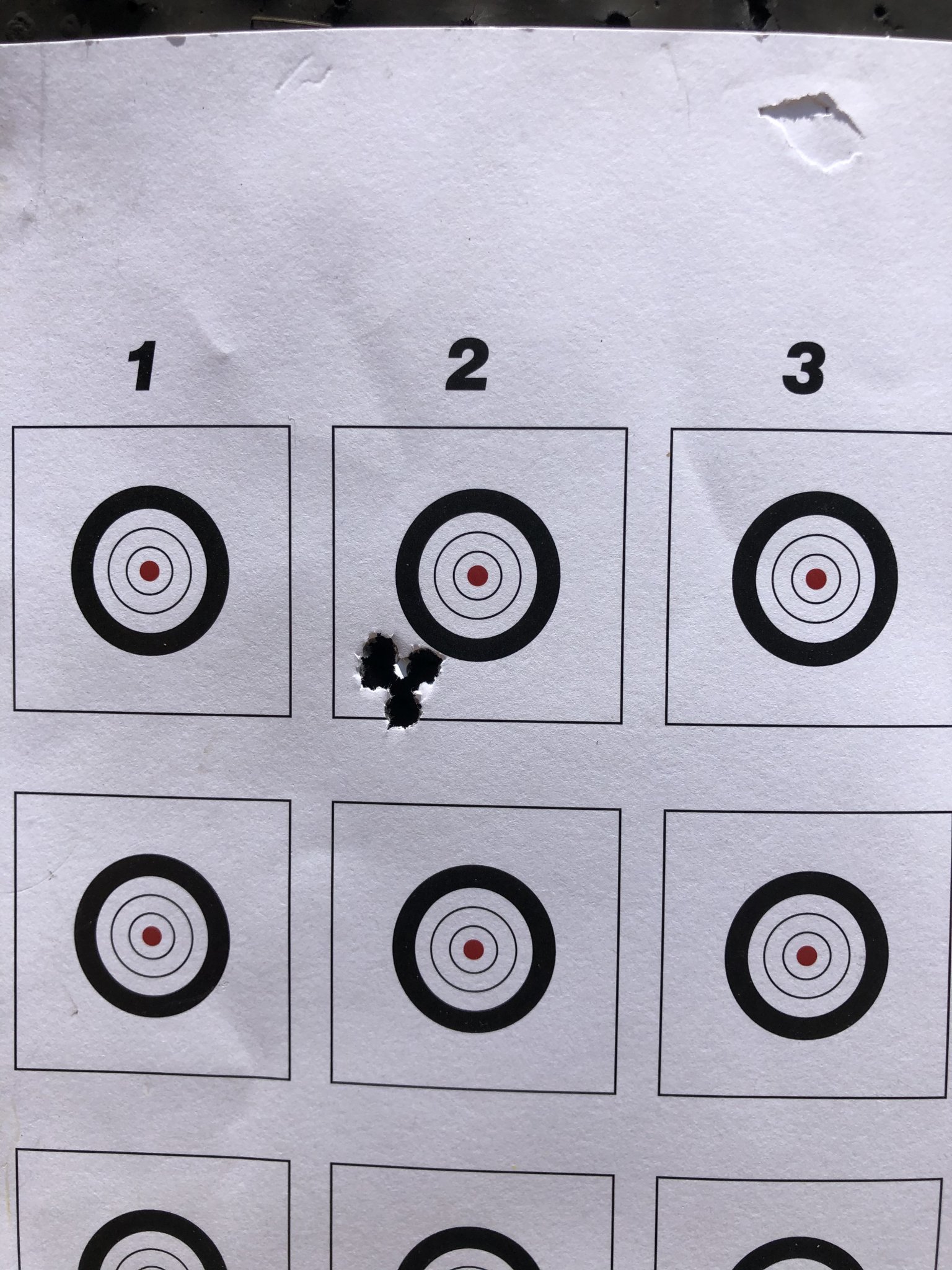

OK guys just got back from the range. Unfortunately I only had a few rounds of some of my brothers hand loads and I didn't have much time so I only did 3 round groups unless noted otherwise. I know it isn't the greatest but the are pretty consistent.
Federal AE 223 Red Box (10 round groups) : 1.7", 1.41". (I was surprised that was that good)
IMI XM193 (15 round blasts) 3.5", 3.2", 3.1"
BHBB 55g : .63"
BHBB 75g MHP : .60", .875", 1.02", 1.03"
Handloads 77g SMK: (21.9g varget - .54", .53") (22.1g varget - .63") (22.3g varget - .62")
I thought back in the day I tried some BHBB 68 or 69g ammo and it didn't do so well which is why I don't have any left to try. All and all it was a good time. The groups were shot from sitting at a bench using the rifles bipod and a crappy bag under the stock.
