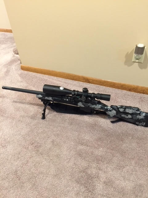

Just trying to get the most out of it with what is available now. My current load is probably 8-10 years old. Still shoots awesome but I know the game has changed for the 308 line ups so I wanted to update and get the most out of it. Did I mention this thing is sexy!!lol
Well post a pic of that sexy long gun......
