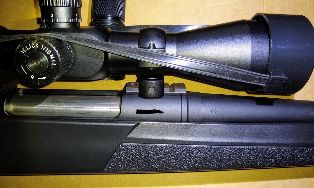

I recently I purchased Winchester XPR in .270win , mounted scope, went out to try it out and can't get accurate groups. Best group I get is about 1.5 MOA (1.5 in from 100 yards).
Tried 3 types of ammo - all the same.
Barrel is free-floated, I can slide trifolded peace of paper all the way through.
I wonder if the scope ring base which is extending over the barrel somehow could affect the accuracy? Take a look at the picture.
Thanks for your input!

No and thats actually the barrel nut it rides over btw. If your trying to shoot groups gotta use the most consistant sh_t. Use Match ammo if no handloads and make sure the scope is repeatable,etc.
-Reagan

Edit: I would not think the scope base is causing much trouble. Might want to check action screw torque as well. It can mean a lot on sporting rifles depending on how the stocks are attached.

Good to know scope base is ok.
