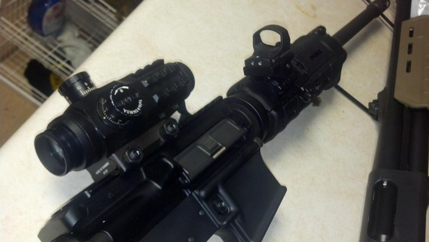

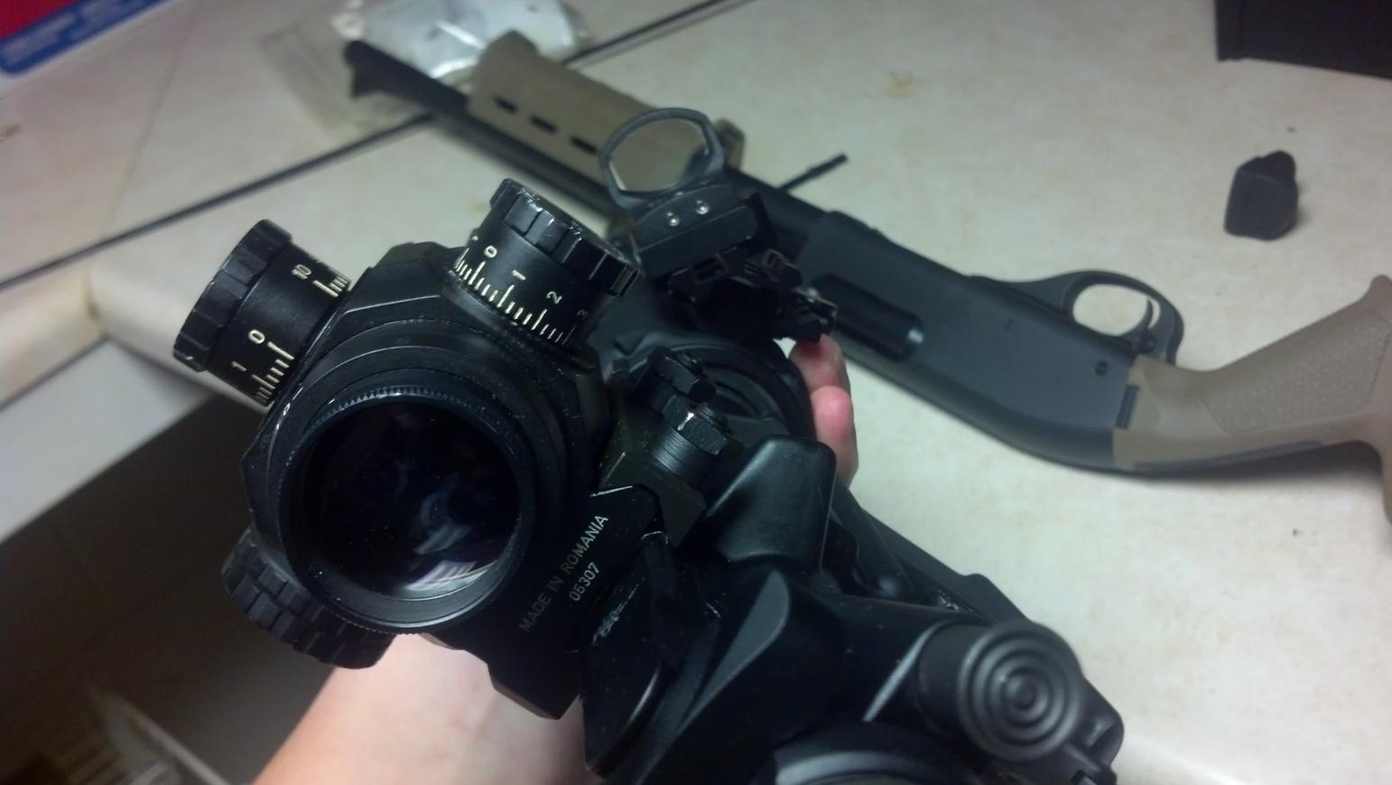

The cheek weld for the scope is the same weld for the Delta point, just at a twist of the rifle. Works extremely well for bouncing between clearing rooms and the longer range/precision shots. I can't speak to the ruggedness of it, however, as I don't intentionally slam it into a mountainside in Afghanistan. (The standard internet forum test). It's taken all the bumps and jostles I've put it through tho.
