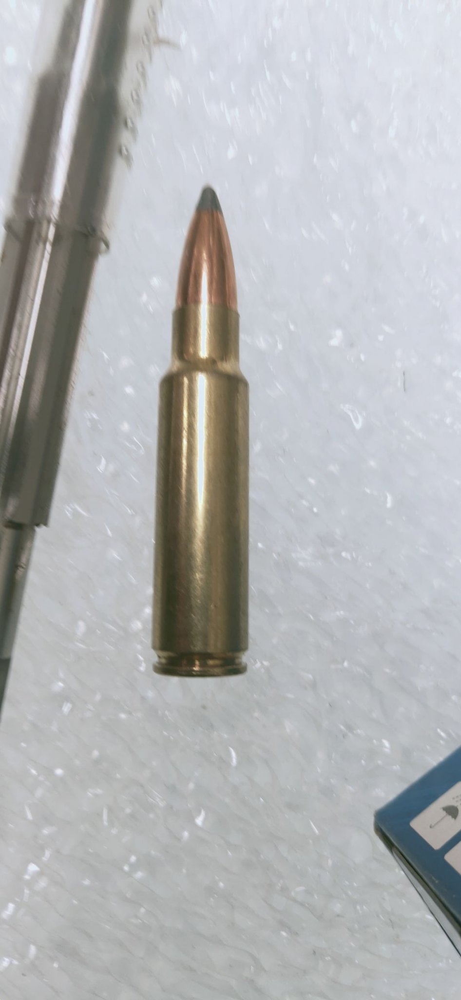

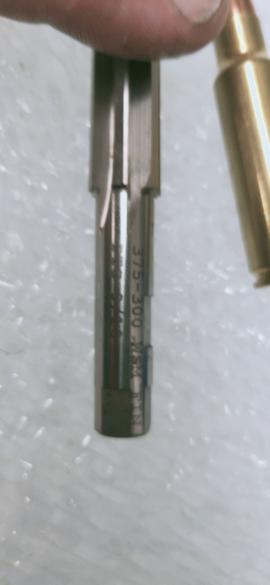

Mates, so don't have personal experience with it, but will find out data.
