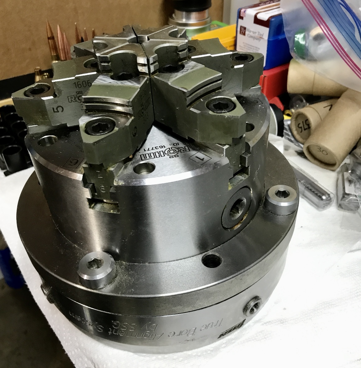

LC 6.5 Shooter Apollo 6 Creed Supporter Full Member Minuteman May 29, 2018 1,743 289 League City, TX Mar 4, 2022 #1 Mar 4, 2022 #1 Needs to work with tru bore alignment system.
Q Quickshot Private Full Member Minuteman Oct 7, 2014 83 37 Mar 4, 2022 #2 Mar 4, 2022 #2 I recommend looking for a Rohm 1606. It fit the TBAS perfectly and is the lowest profile 6-jaw I found. Also, I removed the set-tru plate when mounting it to the TBAS. Cheers, Attachments 080D05F8-3718-4FEB-A5B6-0307C809E283.jpeg 451.9 KB · Views: 33
