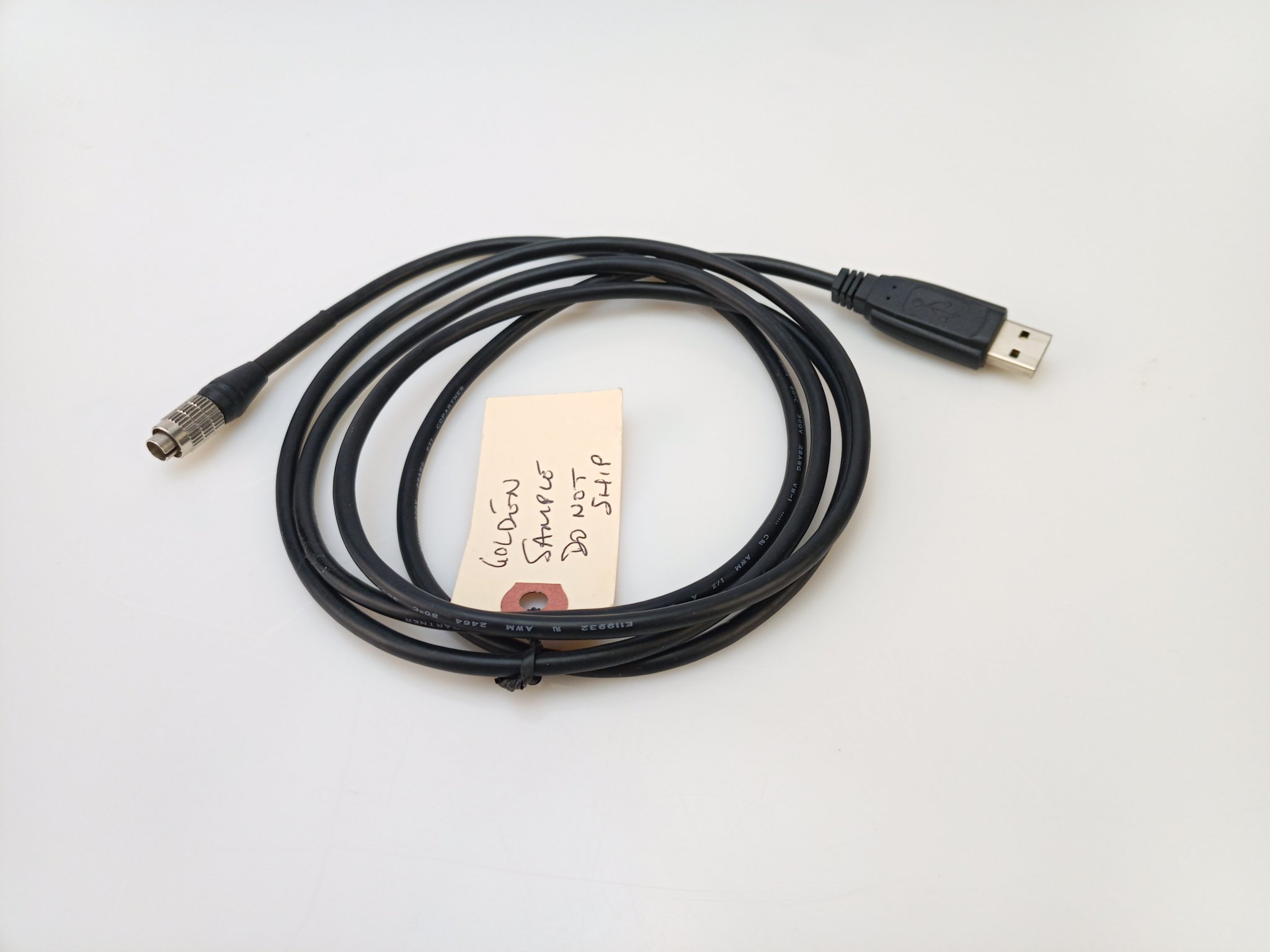

To those searching for the cable:
BORS P/N 66998 and should be at Rev A or later. When you know, you know.
Barrett seemingly has no stock and since they EOL'd BORS, they have no plans to restock.
Also, their repair or exchange service for this part is nonexistent.
See attached. More info & limited help available. PMs open.
  • Barrett_66998RA_USB-232-HIROSE_REDACTED.pdf

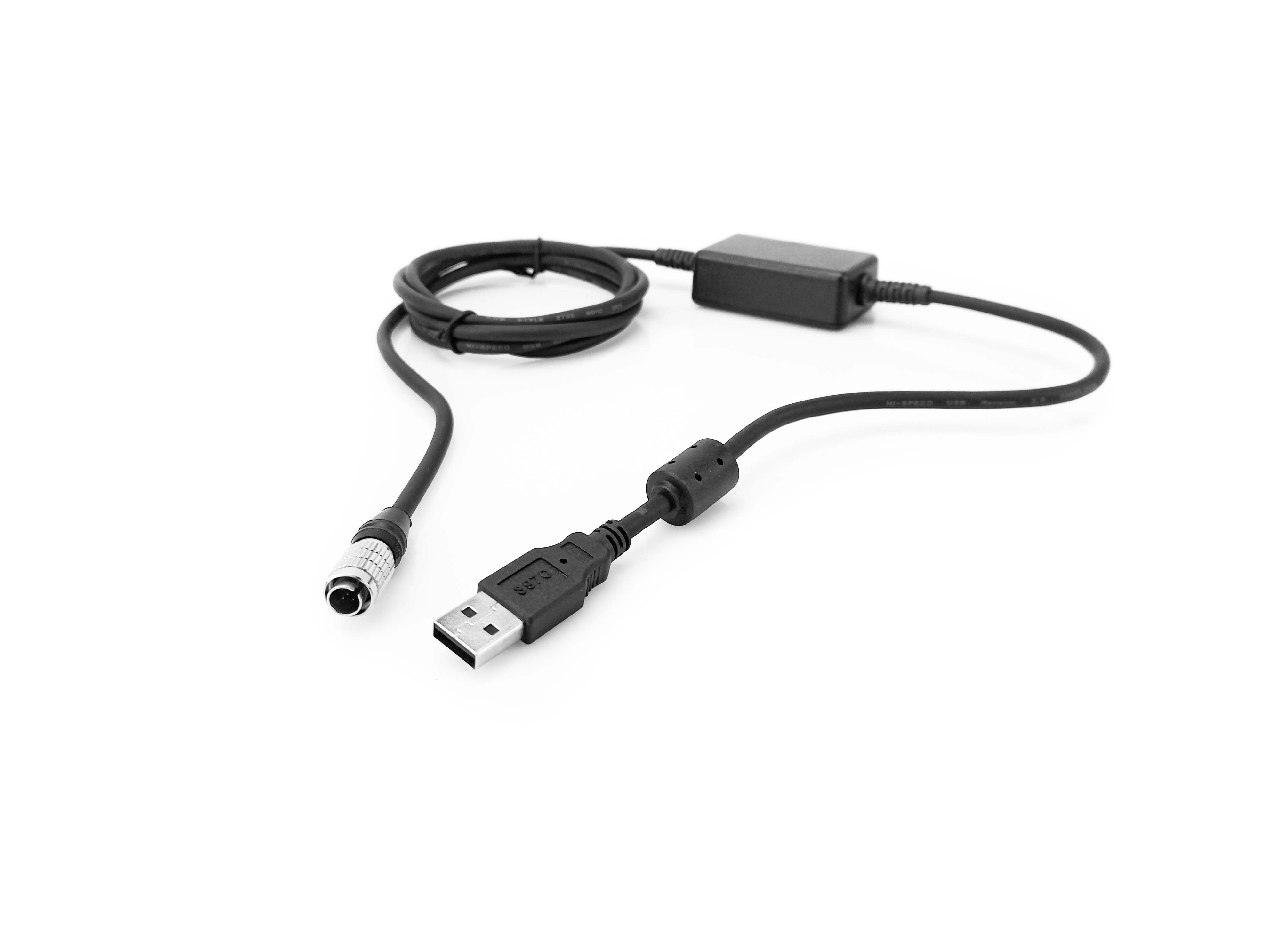

New version BORS Data Link Cable to be released within days.
BORS 66998R2
Slightly different cable design that incorporates a robust data conversion module which is encapsulated within an inline interface box to provide IP-68 Rated Compliance Protection Class along with a Ferrite Choke on the USB side and fully Shielded Comms to the BORS unit.
So will these be available for purchase separate from the actual BORS units? I thought Barrett no longer supported the system.
Yes, they'll be available for purchase...just the cable assembly, nothing else...and not from Barrett. The 66998R2 part number is for reference only, and has nothing to do with Barrett. It is issued to differentiate the older model cable (P/N 66998RA) from this soon to be available cable assembly.

Also, word is that the **new version** cable has just past it's last operational test, and should be available for purchase as early as tonight/tomorrow. We'll post the link when we've been given the green light.
Alright. Ordered the cable and just received it today. Appears to be constructed well, and the BORS is getting power though it as it shows a P over the battery icon on the LCD screen. However, I cannot get the Barrett software to talk through the cable. I've been trying the FTDI drivers but those don't seem to be working so I'll try some prolific ones next. Any possibility of getting the drivers used to test the cable or any information about what chip is being used here so I can source the correct drivers?
