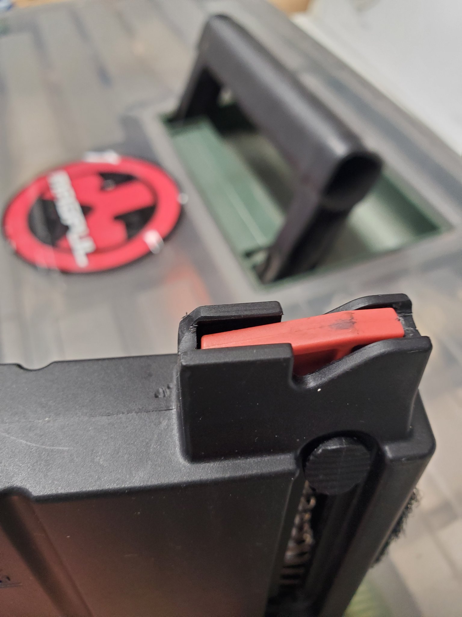

If you can't find bergara mags try Vudoo mags, they fit after about 12 seconds of dremel tool or a simple file to one corner of the mag.
Any videos or visuals to demonstrate? I tried one yesterday (plastic) and it didn't feed, would love to modify some as long as they still worked in my voodoo. I have both metal and plastic voodoo mags. Sorry if this is derailing and happy to move this to another convo

They do work there's an older snipershide thread with a discussion and a few YouTube videos out there. Depending on what you read they do or don't work out of the box. Mine did not feed out of the box with a b-14 action and KRG bravo stock. If your problem is like mine when you insert the magazine the top of the feed lip hits the ejector bar when this happens it forces the front of the magazine down and causes a misfeed where the round hits the chamber at 6 o clock. We Dremeled off a tiny amount of material and after that it cycled fine. Obviously your mileage may vary. User reports from others on the internet say this is the same with the metal mags. **Please note I'm a lefty bastard so yours will be different if you're a righty**
is a link to comparison photos I did before I modified the other magazine.
I'm traveling right now but I think I have a video I'll try and get up too.
See below. I'll update with a video when I can figure out how to get it up.

Definitely go slow and take little bits at a time if you try this. Keep inserting and running bolt till you get proper clea
