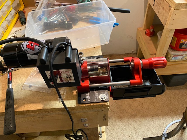

i recently purchased a Henderson trimmer from a fellow member on here, Talked to Todd at Henderson and he set me up with the power unit and correct trim head for 223 since the one i purchased came with the 6mm head. Todd (owner of Henderson) went out of his way to help me get everything in order once it arrived, even texting and calling me back over the "weekend" as i had a few problems. Now that everything is running smoothly, i can't imagine a better trimmer. Trims and chamfers all in one. Great machine and great person to do business with. I'm probably running approx. 500 per hour thru this trimmer
