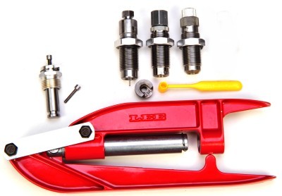

They don't come any less expensive than Lee's little "Reloader" press. And they are quite guod too, and far stronger than it would appear!

Nothing's cheaper than a Lee. Designed for cheap construction employing cheap materials to support a cheap sales price. Utility or value doesn't enter into the picture. Cheap.

It is indeed. Lee's alum alloy presses are inexpensive, yes. Designed to be easy to make on automated precision CNC tooling, yes. High value, YES. But, "cheap"? NO! Airplanes, missles, car and outboard motor blocks, a lot of our guns and almost all scope tubes are also made of alum alloy and I hear no one saying they are just "cheap pot metal." Nonsense!
A few years ago I got a dial indicator and magnetic base for machening work. I soon checked the head/die spring of my much praised, "STRONG!" RCBS Rock Chucker II when FL sizing some 30-06 cases. Spring was an easy .003"; not a lot but sure more than I had expected. Then, just for comparing, I did the same test on the two little "cheap" Lee "Reloader" "C" frame presses I use for de- and re- priming because my RC makes such a mess dealing with primers. Same dies, same box of fired cases; the .001" reading dial indicator barely moved, not enough to read but it was well under a half thousanth!
Am I saying I proved the tiny Reloaders are stronger than the RC II? Certainly not, that would be foolish and I am not a foolish man. But it did prove that within their strength limits even the smallest Lee presses ARE more rigid than my highly touted RC. AND they are more than sufficently strong for normal uses, I have resized a few .338s in one of them, so...??
Seems those who slime Lee presses do it as a knee-jerk reaction they just can't help but NONE I know of have any actual, measureable justification for it.
And I KNOW that if I had to replace my old RC II tomorrow it would be with a Lee Classic Cast, it's the superiour press in every way!

The Lee Challenger is cheap and the Anniversary Kit is an excellent way to get started.
It does have it's drawbacks. I managed to bust the linkage on mine. Lee offered to replace it with the original parts free of charge, or upgrade to the heavy steel linkage for a couple bucks. I upgraded the linkage and dropped it on the shelf as a backup. I now use a Classic Cast I got from another member here.
The Lee Classic Cast will work very well. It's much heavier than the Challenger and it on par with the Rockchucker I looked at.
Lee makes a good product. They are designed to be inexpensive, that doesn't always mean "cheap". If you want to pay more, you can. You just don't have to.
